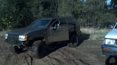

got a chance to get muddy!
wish we could have got some pics of the action. we were just having too much fun lol

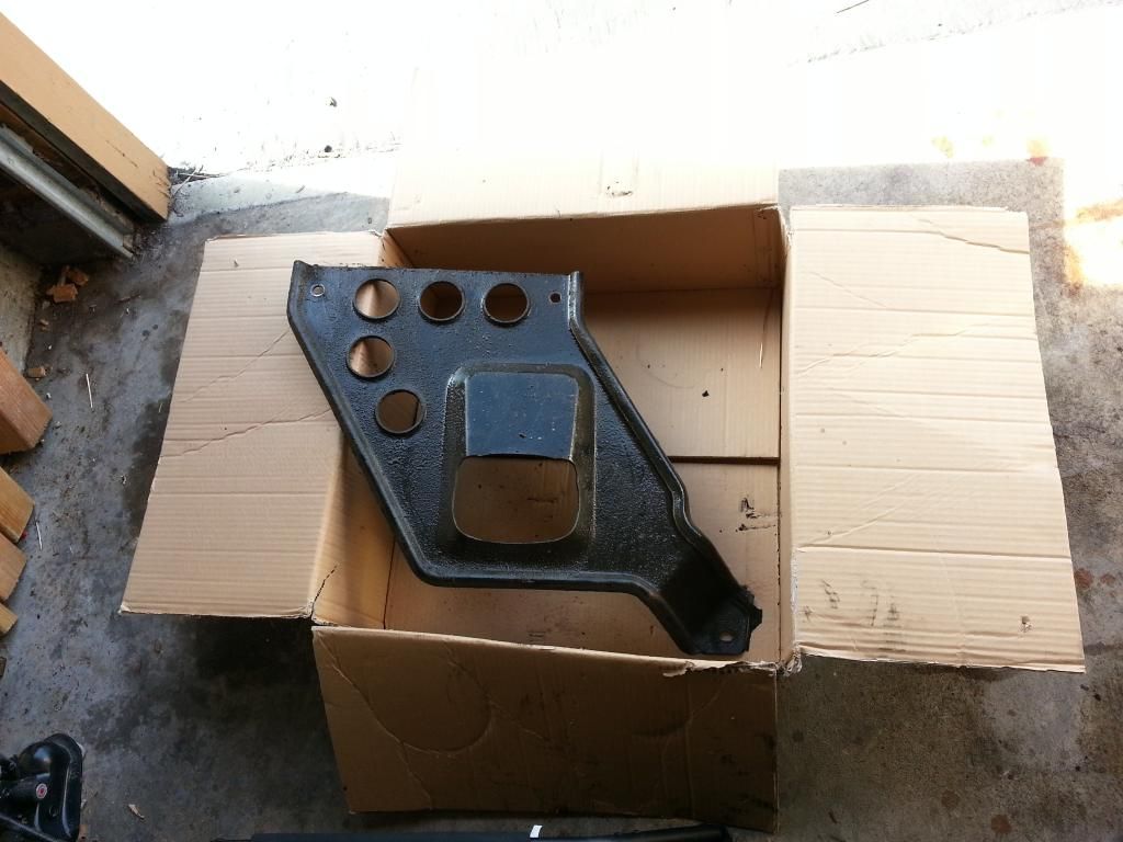

man its been a long time since ive done anything with the jeep or my thread!
well, finally had a nice day and thought id browse the local JY and found this guy!
covered in grease and grim on my the bottom and dirt and mud on the top
all cleaned up and painted:
got it installed except for the unibody side. dont have the nutserts for that bolt so I think ill just #10 hex head self tap it.

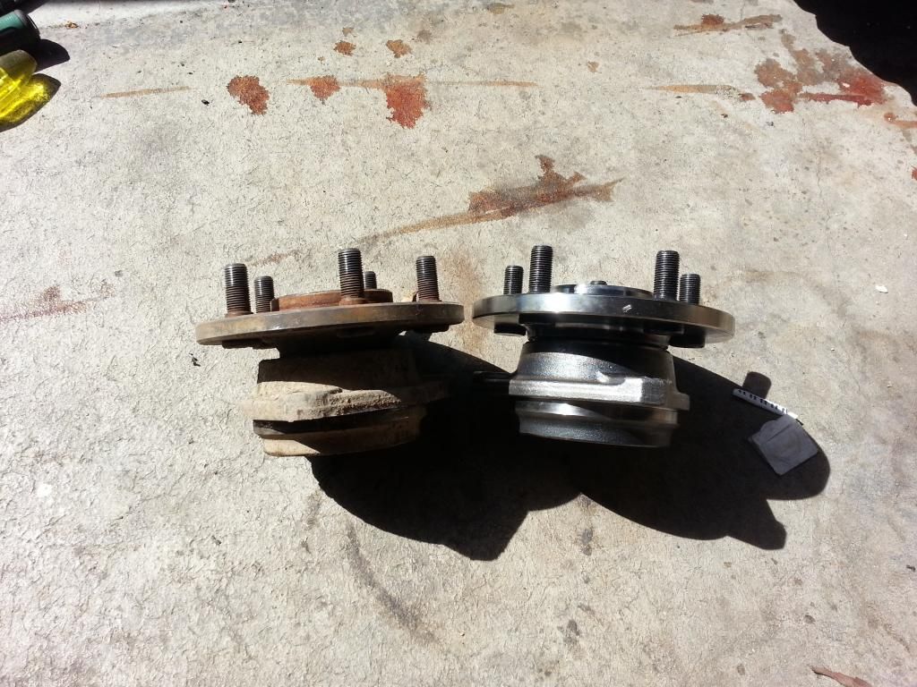

decided to put some new hubs in. probably time anyway, they looked like original ones.
'95 ZJ: 5.2 v8 / 231 Tcase / 46RH

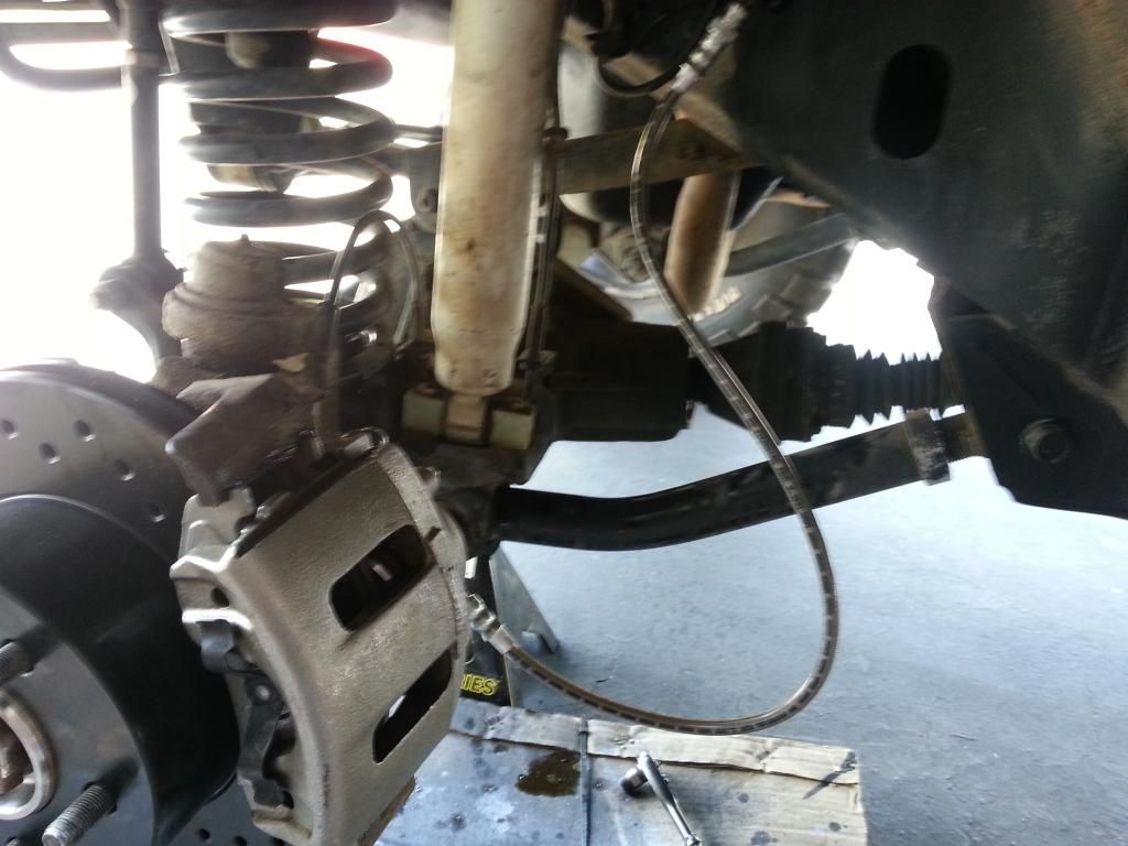

upgraded and freshened up my front brake system with IRO's extended Stainless Steel brake lines, Stillen cross drilled rotors (from Kolak, thanks dude!), new reman calipers and thermalquiet pads.
edit: the brake line wrench set shown above... utterly useless...

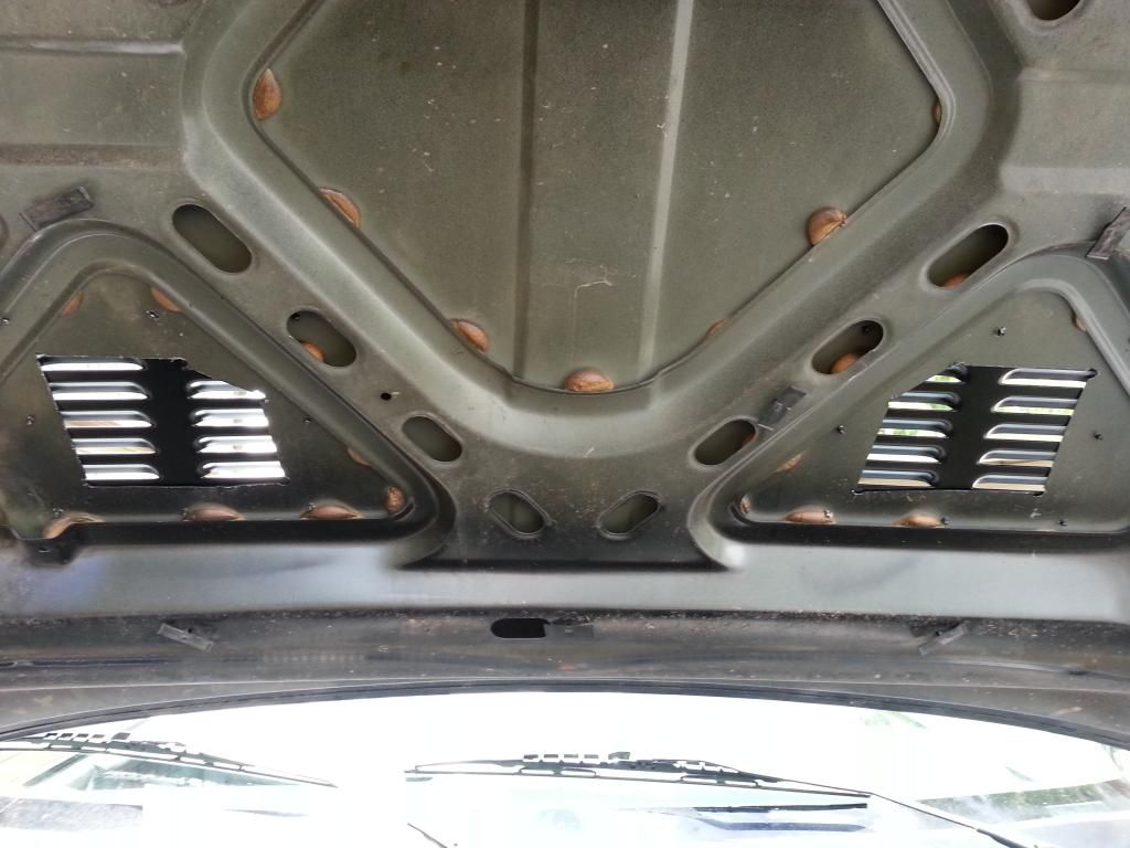

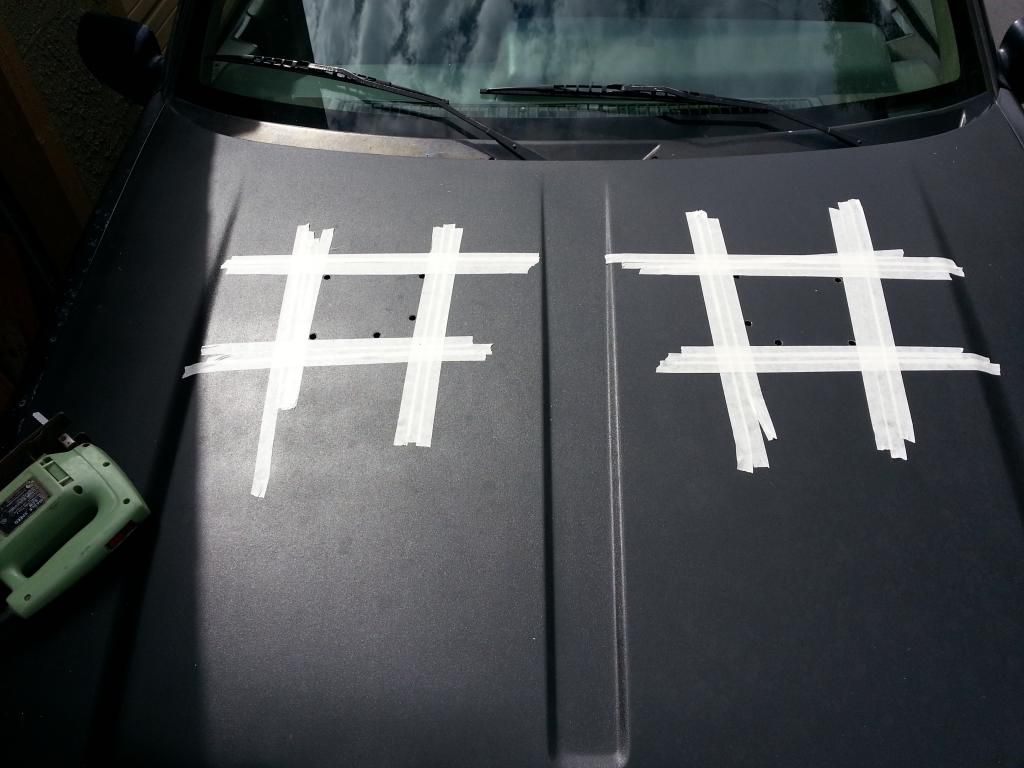

ordered some Genright Hood Louvers to help reduce the underhood temps... who am I kiddin.. I got em cause they look cool.

Unread 09-01-2013, 03:33 PM   #57
B52dude
Posts: 346
Diggin' the louvers man!
thanks bro!

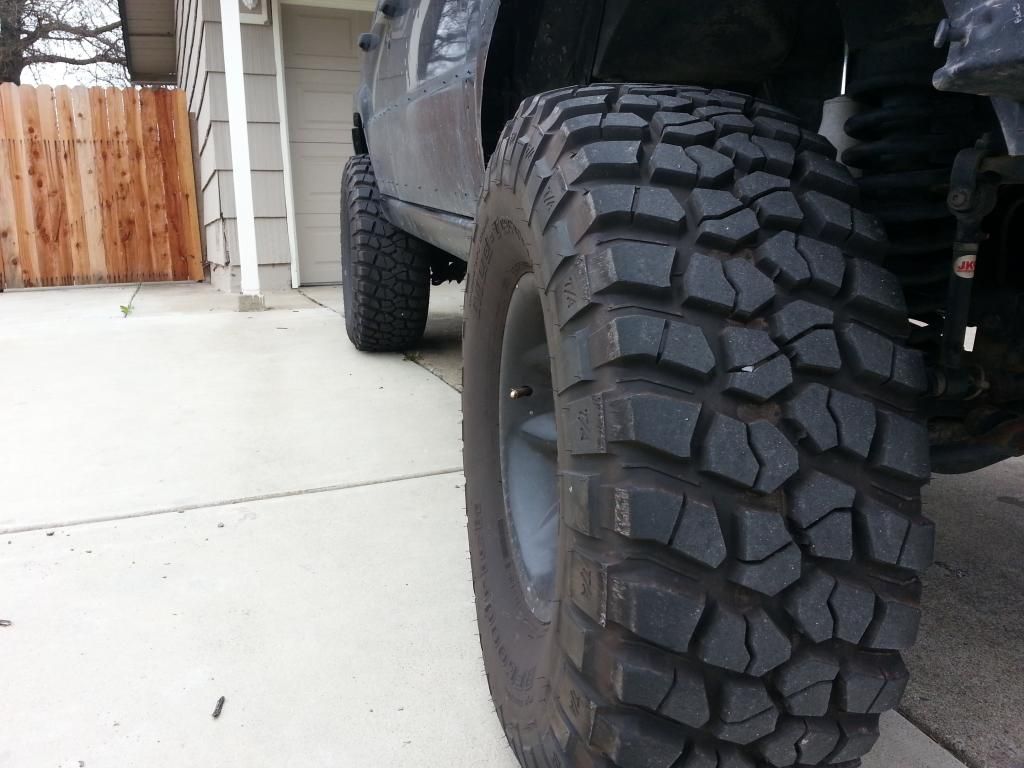

Got some new tires and a new IRO adjustable rear trackbar to replace that stupid drop bracket.
