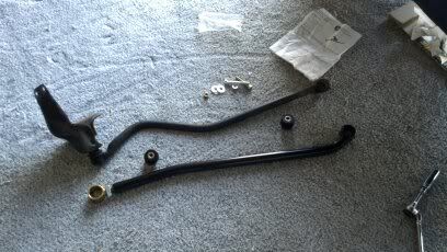

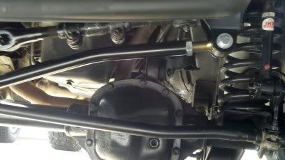

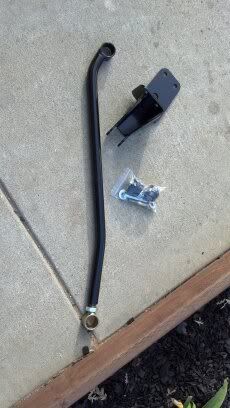

looks like I gave a sneak peak of the IRO double sheer adjustable front track bar in the JKS pic, so here it is!

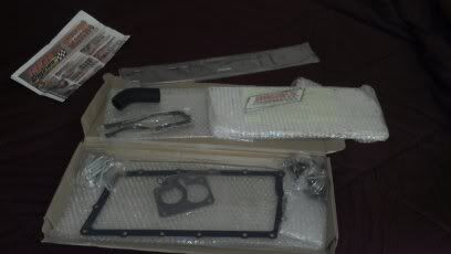

so this guy showed up. Hughes Engines plenum plate kit. Should fix that oil in the intake issue some of us struggle with. Also it came with a new bypass hose which is good because I think mine is leaking.

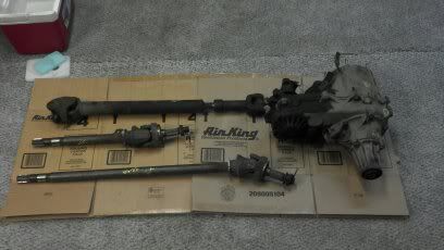

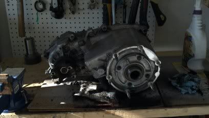

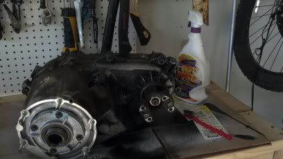

plus pulled and begain work on these future swaps
231, u-joint axle shafts and a u-joint front DS!

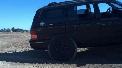

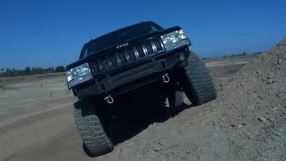

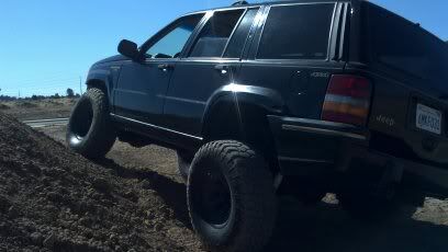

been awhile since ive been wheelin, so i had to improvise. found a dirt hill on a jobsite to roll over on my way home from work lol
you can also see in this pic my KOR Radiator support
i guess i never took a pic but somewhere along the lines i replaced my 3" BB with the F > R swap usng IRO front springs on a 1.5" spacer. after sag and spacer squish im sitting at about 4" lift.

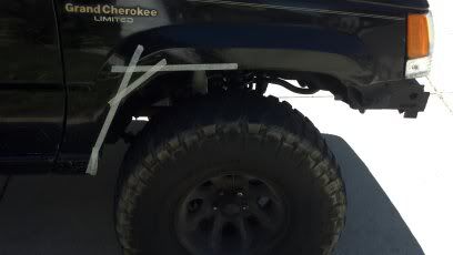

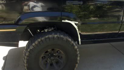

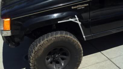

decided id try to clean up my fender trim job only to find out my compressor is horribly inadaquate to run my 3" cut off wheel. finished with the sawzall... terrible lol. the lines are a little cleaner but still a hack job.
'95 ZJ: 5.2 v8 / 231 Tcase / 46RH

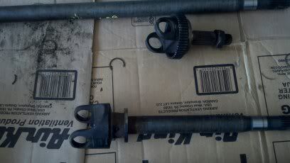

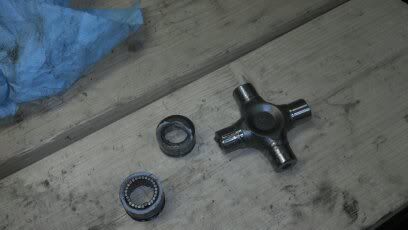

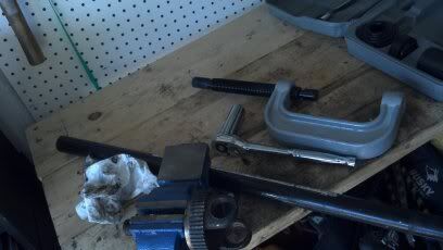

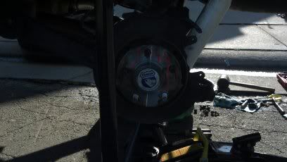

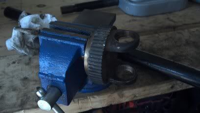

Continuing on the u-joint axle shaft swap... not sure how you F up a u-joint install but i managed it..
i guess some needle bearings came loose from the bearing cap and i smashed em until the cap snapped. there goes $25 bucks... time to order another 760x spicer...
some bench side pics.. i know you're riveted...
at least one came out the way it is supposed to. coated it with some rust preventor.

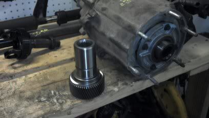

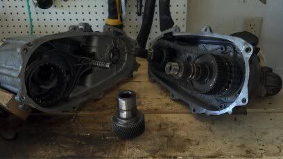

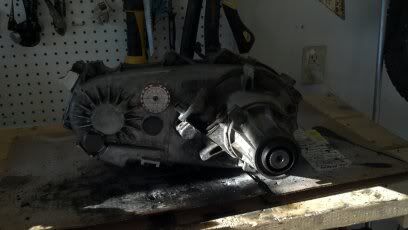

this guy showed up from JB Conversions today, my brand spankin new 1.55" input shaft.
just so happens i have a 3 day weekend startin right now! haha, maybe ill tear into my 231 project and get that thing swapped

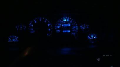

dug up this pic of my blue LED dash lights:
Same blue LED's in the tranny and T-case bezel's too... pic to come after I get the 231 swapped.

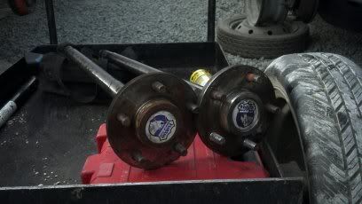

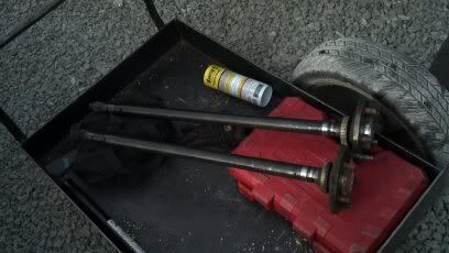

found these at the local JY: Yukon Chromoly rear axle shafts for my D35c
$250 brand new and I can get both for $40?? no brainer!... ok maybe $140 to $180 brand new, but still. here they are in the garage!
also cleaned up the axle shafts and 231 a bit

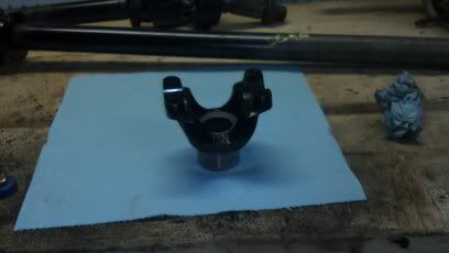

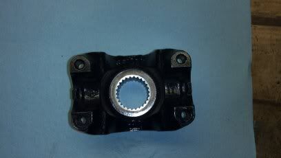

pinion yoke i pulled right before i stumbled on the Yukons. Cleaned it up a bit and painted it.

popped the 1.55" input shaft and new seals into the 231. heres the case about to go back together with the, i believe, .825" shaft sittin in front

so those yukon shafts? yeah they are different lengths for each side... what a dummy I am. I just pulled my rear apart and put it back together thinkin I couldnt use em. I guess I know what im doin in the morning. same thing i did this morning! lol
man.. all i had to do was line it up with the other shaft... dummy.

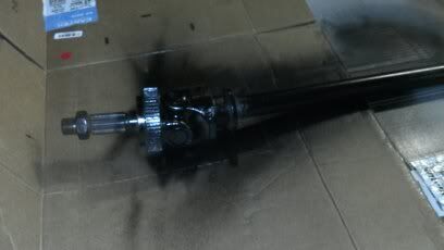

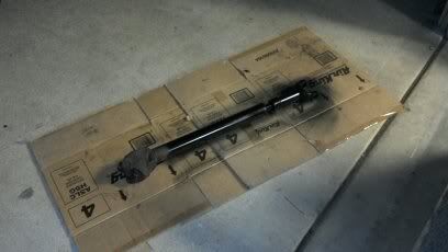

prepped half the driveshaft for a u joint.
just need to rebuild that double cardan and its ready to go in!

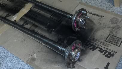

new spicer showed up today.

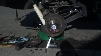

both shafts with the u-joints successfully installed. Shafts painted.
pass cv out, this is cake! hardest part was my damn brake calipers didnt wanna let go of the rotor... needless to say these brake pads wont last nearly as long as they were supposed to..
pass u-joint shaft in!
driver side cv out next to u-joint shaft.
u-joint shaft in!

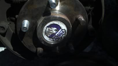

suprisingly, neither side gave me trouble getting the hubs off. pulled right off with no effort.
