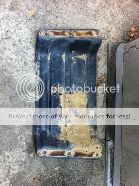

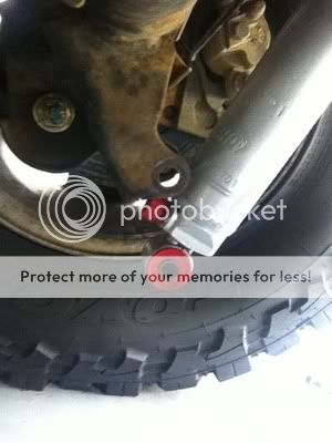

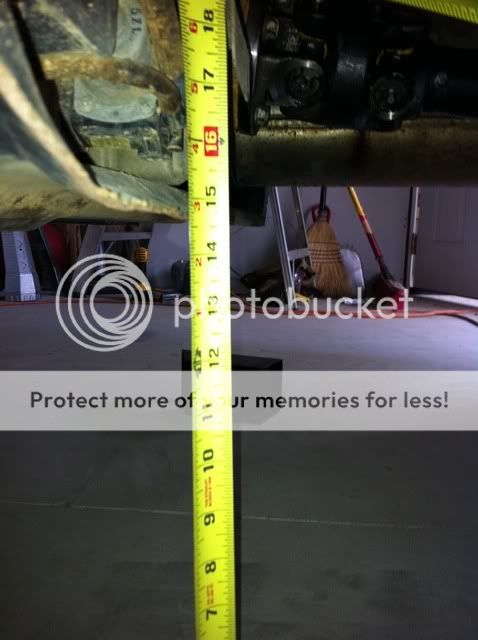

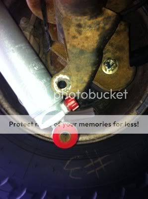

Well I hope to be picking the Jeep up from the shop today, but it looks like it will probably be tomorrow. Not particularly happy about it, but at least everything will be finished up. As I am stuck in a hotel room, thought I would update a bit.
During the initial install, I felt as if the shocks were too short so I talked to Gerald and he sent me out the shocks that are supposed to go with the 4" kit. Seeing as how both kits use the same bumpstop, I can't see how the shocks won't work. The original shocks allowed for a little less than 2 inches of down travel. These pictures are taken at normal ride height with weight on the wheels.
I didn't take pictures of the new shocks, but they give about 3 extra inches of down travel. By my math, I should have between 1/4 and 1/2 inches of up travel left at full bump. Seems like the perfect shock.
I have also started the UnderArmor installation. Good bye stock shovel. Clearance before was 14.5".
After pictures to come as soon as I have the Jeep back from the shop. I'll also have wheeling pictures after the weekend.
