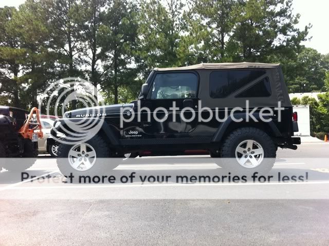

A quick update. Tires are on!!! 255/85R16 Toyo MT

Well I got to drive it a little bit yesterday and today. All told I think I have about 50 miles on it since picking it up from the shop yesterday afternoon. I am extremely happy with how it turned out. There is so much less side to side sway, that it's hard to believe. I would love to see what it would be like with a full out board on the rear shocks. Maybe one day. For now, the Jeep tracks true down the road. I have had it to about 70 mph and it is completely vibe free, either from the drivetrain or the steering. In fact, the steering is incredible. I don't currently have a steering stabilizer installed, and the steering is much better than stock. The Currie parts work wonders!!! Now I just need to play with the tire pressure a bit. I am sure the shop over inflated at least a little bit.
