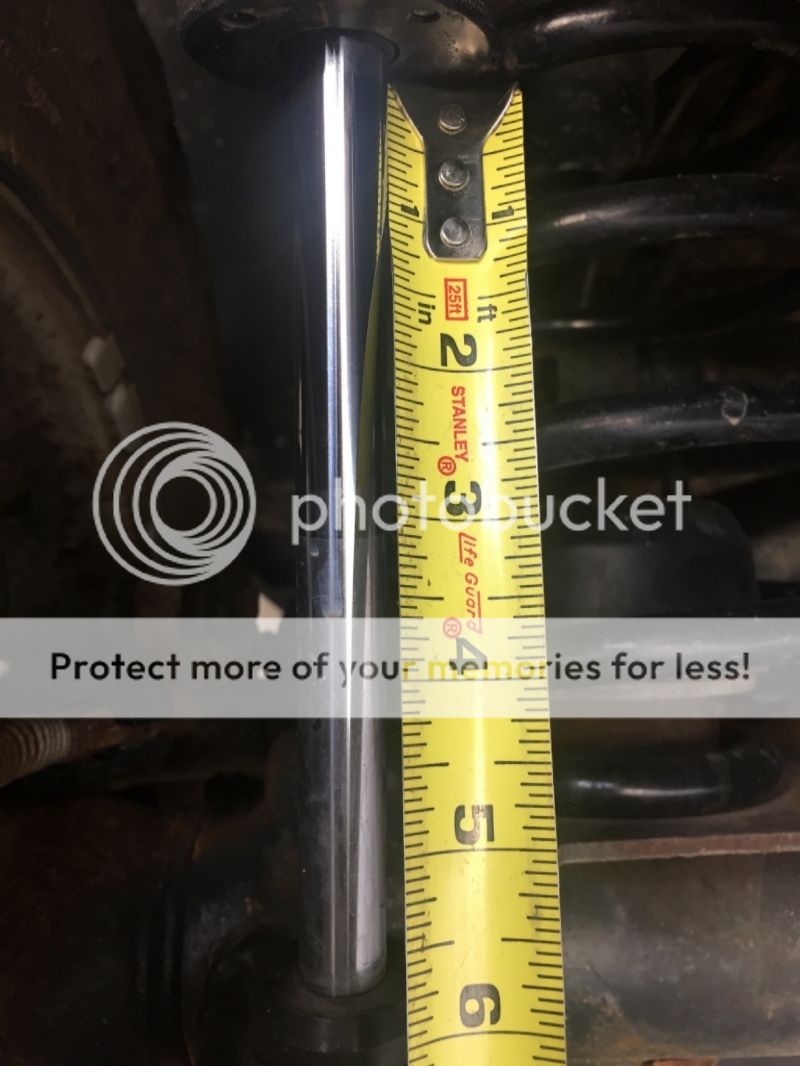

I'm still loving the rear suspension overall and I'm still delayed on getting to the front. Both the on road and off road ride have drastically improved with the work that was done. I need to move the lower shock mounts slightly to regain some down travel. My original plan had been to squeeze out an extra inch of up travel for an even split up/down. That is how the mounts were set up. After wheeling though, I've decided that I'd prefer to gain some droop. I'm at 5 up right now when the bumpstop is completely compressed. I'll leave it that way and take full advantage of the 6 down that these shocks will allow.

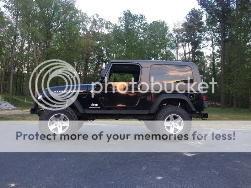

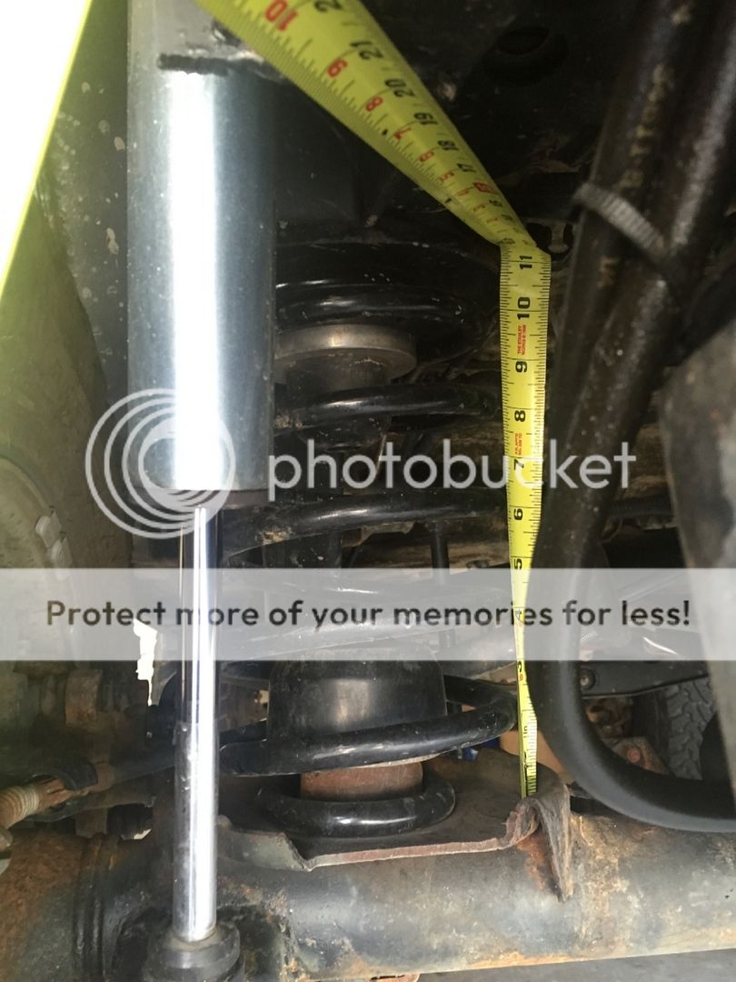

Some pictures of the final results. First, the achieved lift height followed by a close up showing how much shock travel I use during every day driving. Springs sit at exactly 11", or 3" over stock. The shocks are a little tough to see, but the clean shaft on the shock shows about 3" of usage. My bumpstops are 4.5" apart with the soft top on, so I'm not anywhere close to using all of the available travel.

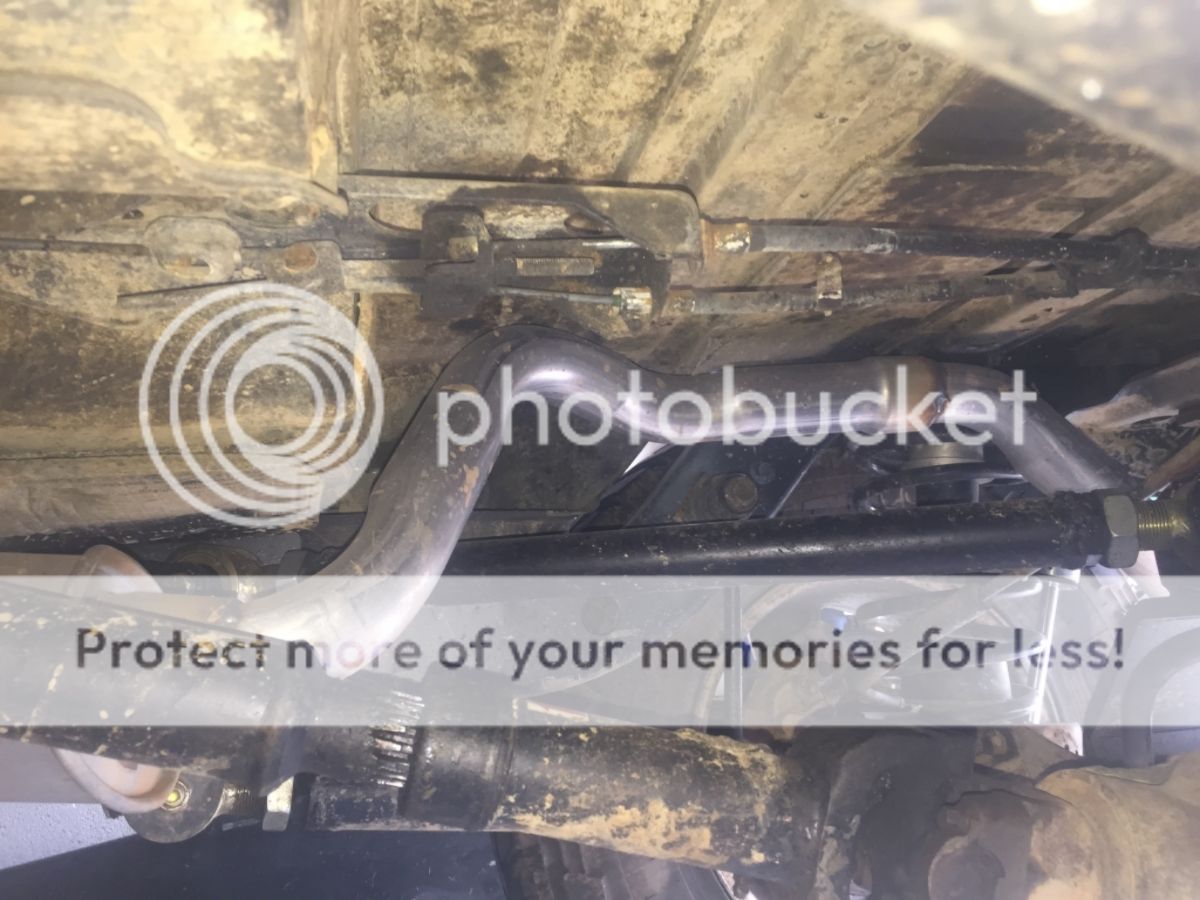

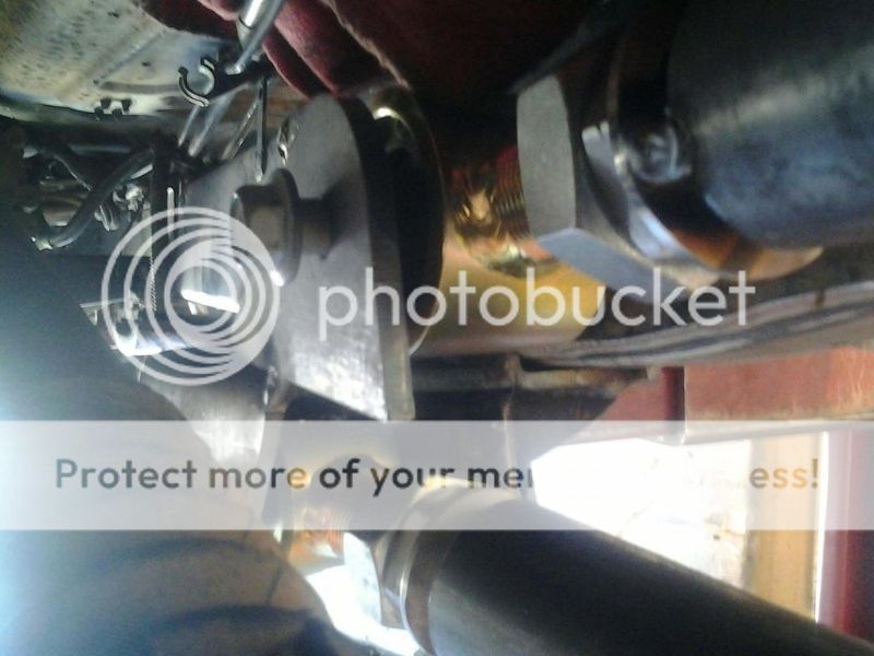

Now the exhaust routing. Oceana Muffler did an amazing job running this. It's a Dynomax muffler, cocked just slightly so that I can get to the bolts on the upper control arm mount. The bends around the arms clear everything with room to spare.

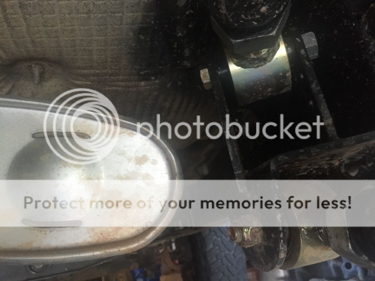

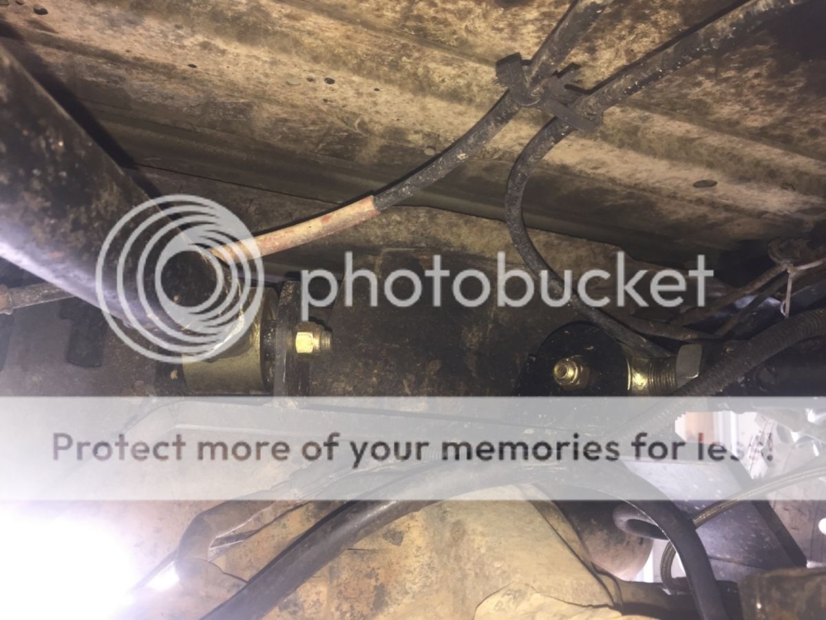

And some random shots of the mounts. The axle end of my lowers are slightly lower than mid axle. They are as high as they can be while keeping the lower arms from making contact with my frame at full stuff. You can also see how much I scraped along on my mounts and arms on the Wheelin 4 Hope trip back in April. I'm trying to get some pictures of that.

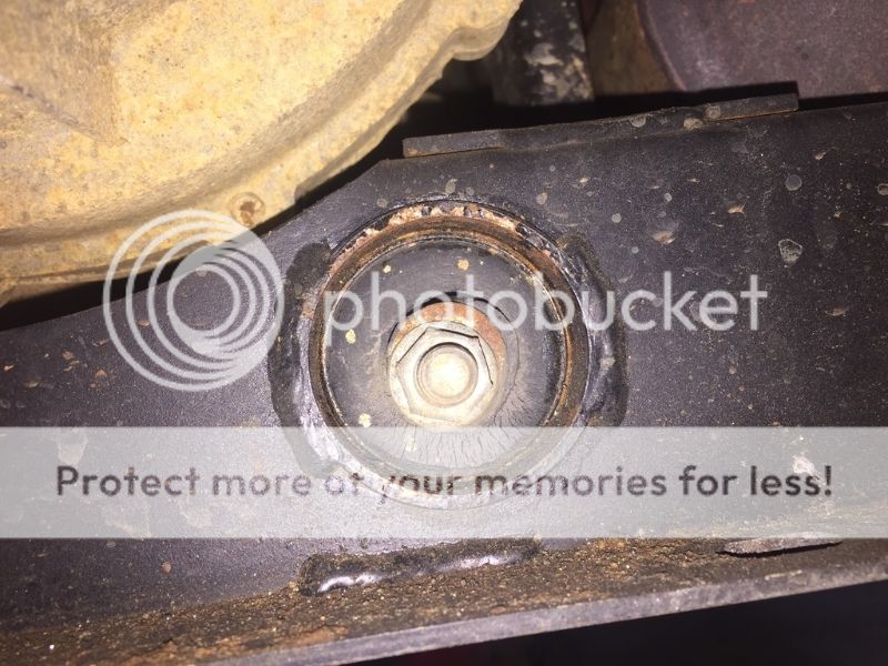

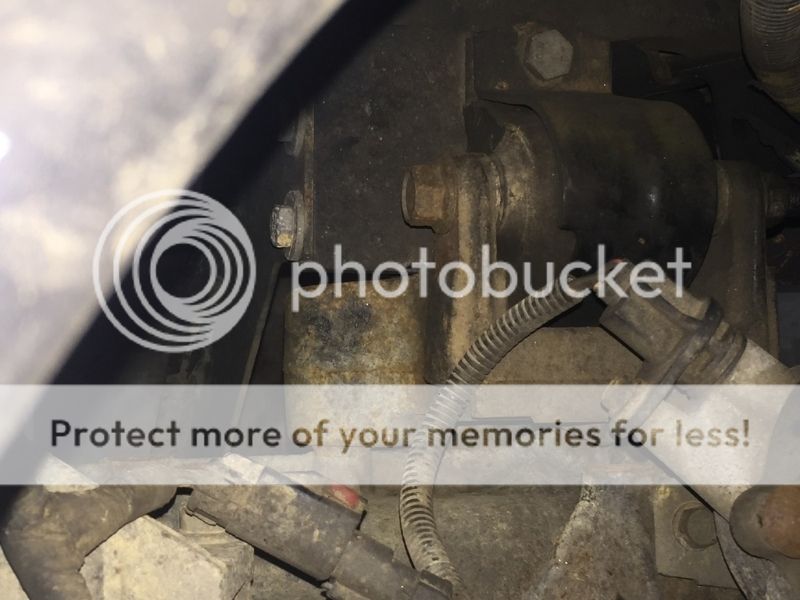

It's been a while since my last update, I finally have something to add to the thread. I had a buddy come over yesterday to help me install the MORE motor mounts that I got for Christmas. I had asked for these because I thought I was getting a lot of play in my stock mounts and because I needed to remove them anyway to grind down my Savvy MML block. I'd had contact since day one of installing the UA and 4 and half years later, I figured it was finally time to fix it. Thought this was going to be a pretty simple job, as being my Jeep, it was anything but.

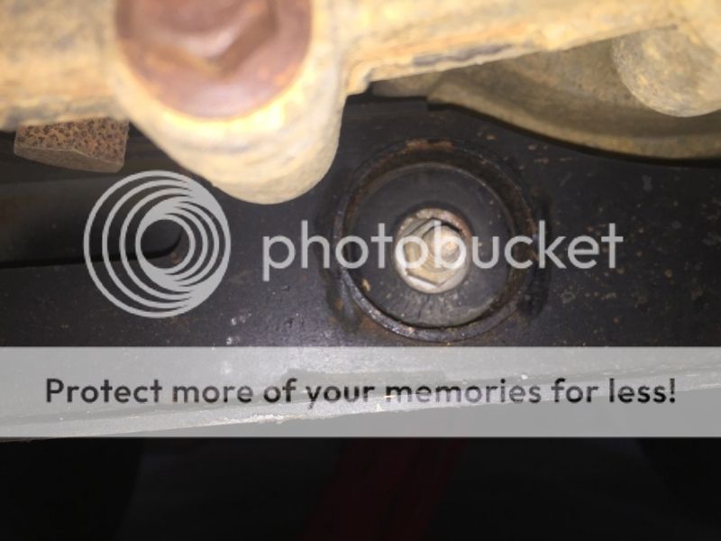

Started by loosening the bolts at the crossmember and the transmission mount. That's when I found the rubber in the crossmember needs to be replaced. So apparently that would be some of the cause of the driveline play that I felt. I'm pretty sure Savvy uses control arm bushings for this, but I'll try to get in touch with them this week to verify that. I needed to talk to them about my old springs anyway, so I'll just add this to the list.
Pictures of the mounts. The passenger side is worse than the driver's side.
Next we moved up to the front and started removing stuff. Stock mounts don't appear to be in bad shape, but they are almost 10 years old and have been through some abuse. Pics of the stock mounts installed. You can see the contact point on the lift block on the passenger side.

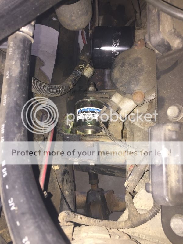

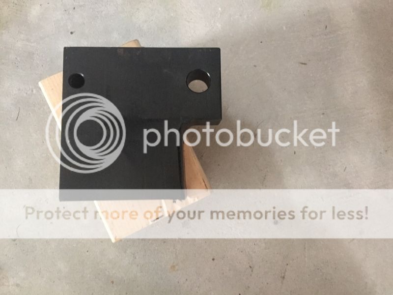

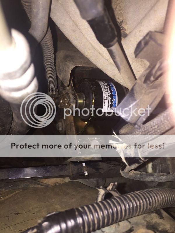

Once we got the old mounts out, I remembered that we would have to cut down the attached screw in order to make it work with the Savvy MML block. I had completely forgotten about this step. Oh well. Next, we hit the lift block with a grinder. Not going to get any more contact there. It took us a little over an hour to get the bolts through the new mounts. Things just weren't lining up well, but we got it done.
Once they were installed, I checked for clearance everywhere and found that the entire engine is almost a half inch higher than it was. Clearance between the fan blades and shroud used to be really tight and now I can fit my whole finger in the gap.
New Mounts
Savvy MML Block shaved down
MORE mounts installed

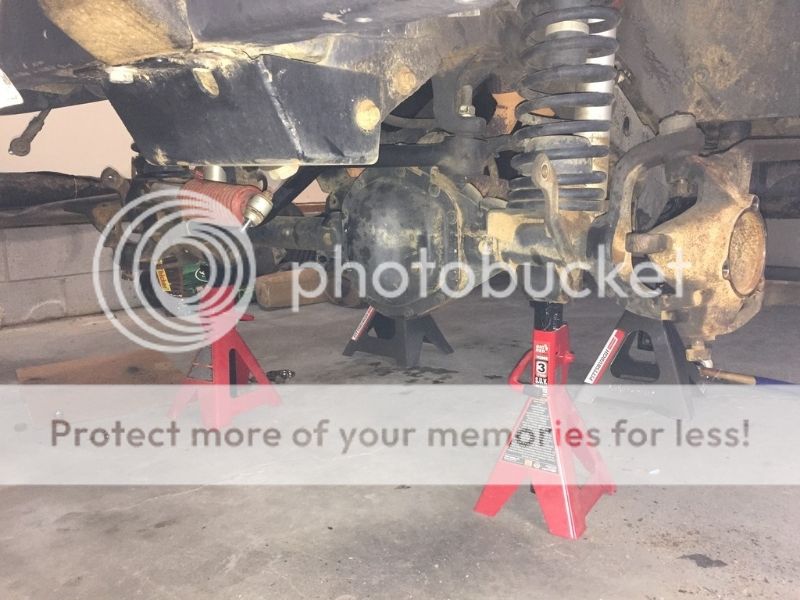

Sad to say that death wobble has found it's way to my Jeep. Happened a few times recently, so I decided a refresh was in order for the front end. I had some Jeep money set aside for 35s, but it looks like tires will be waiting another year.
Lots of parts and an almost torn down front axle:

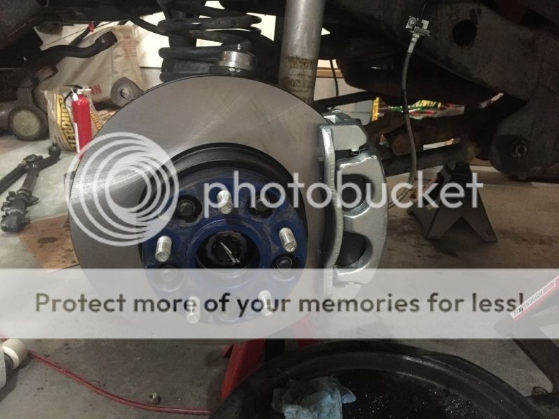

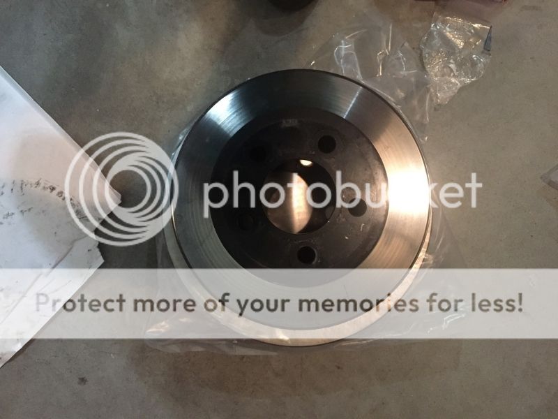

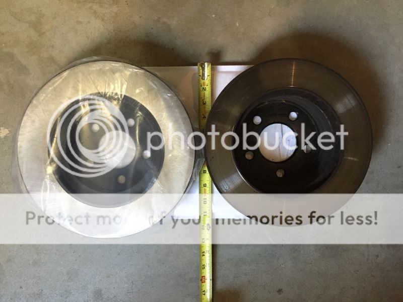

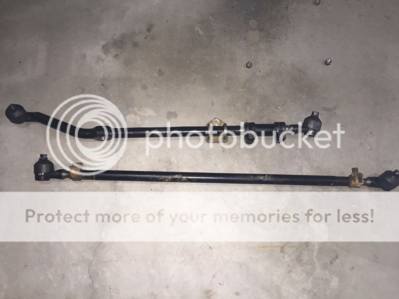

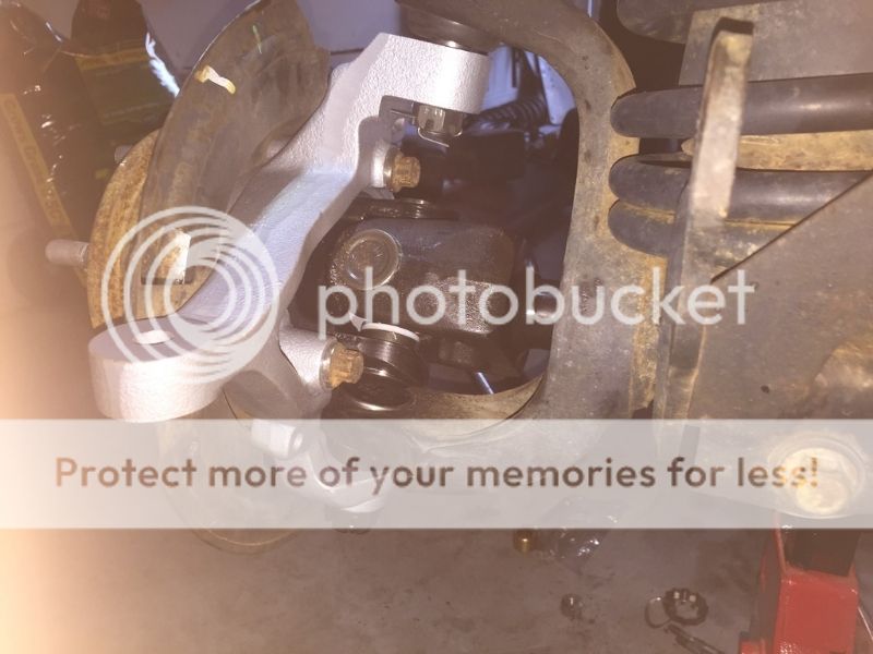

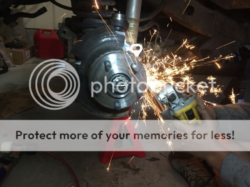

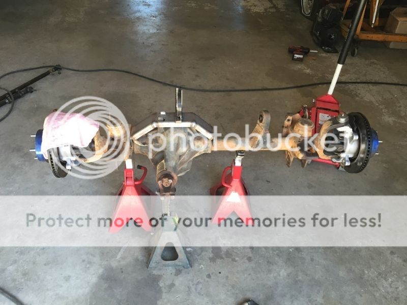

So the refresh is done, short of tweaking the alignment a bit. I installed new Spicer ball joints, Revolution front shafts, extended brake lines, and a 16" Vanco kit. My new unit bearings are lost in the mail somewhere, so we ground down my current ones and reinstalled until the new ones show up.

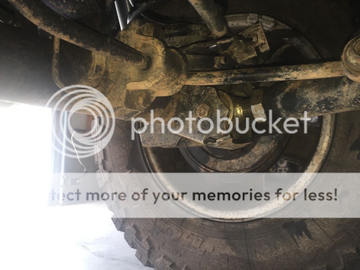

Revolution shaft vs stock shaft. My stock shafts have never been out and the U joints are original. 10 years and 64,000 miles, but they still moved around freely.
The refreshed Currie steering. All new TREs, including the drag link end which is where I think most of my problems were coming from.
New Vanco rotor vs stock. This is the 16" kit.

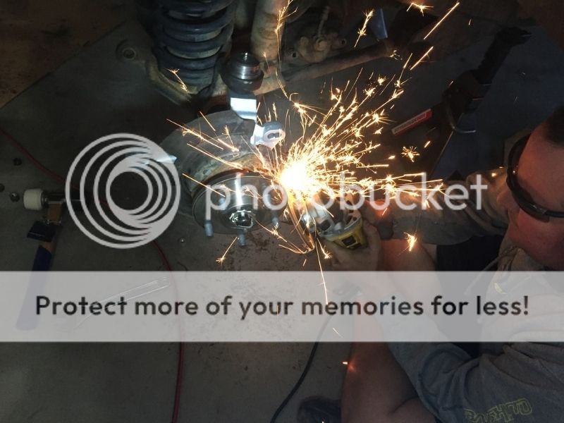

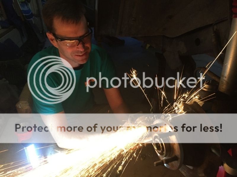

Grinding down the unit bearings. All four corners up on jack stands, engine running, 4 low, lockers engaged. We just held the grinder in place and let the turning axle do the work.

And fully installed. The brakes are incredible. They are honestly boarding on too good for 33s. I can lock up the tires pretty easily and that is on dry roads. It is good to know that I am well set up for 35s or 37s now though.

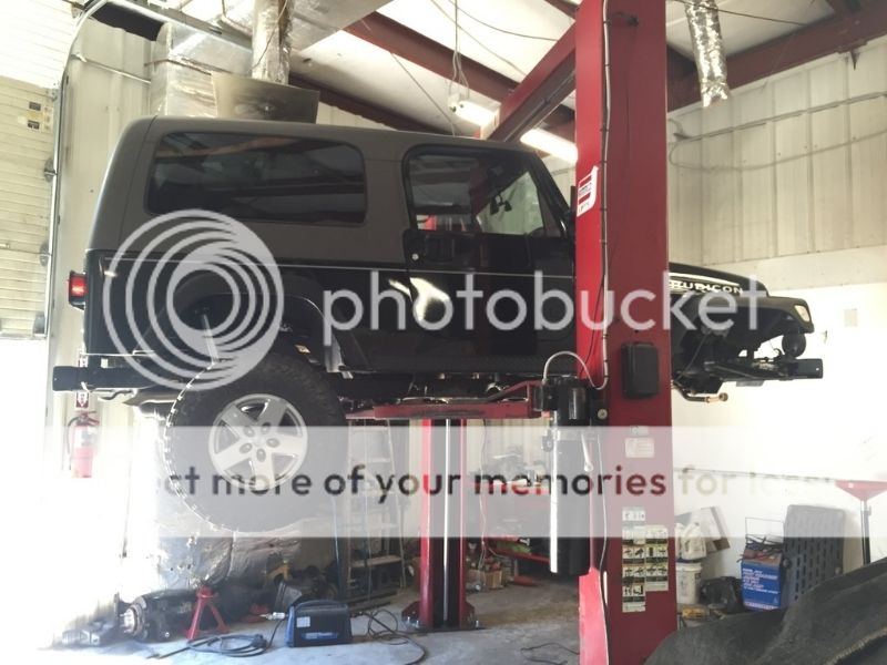

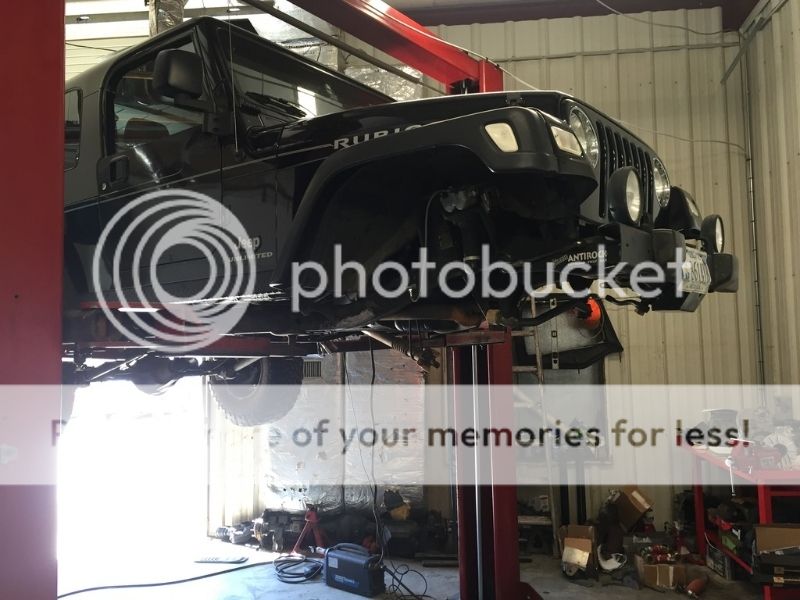

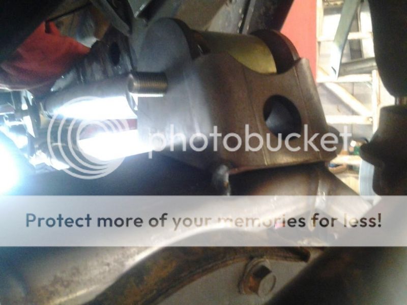

So I've been a bit busy with life lately and haven't been around the forums much. Been checking out a few threads, but not posting a lot and that left this thread undated. Big Update today is that the 3 link is done and the Jeep is driving great

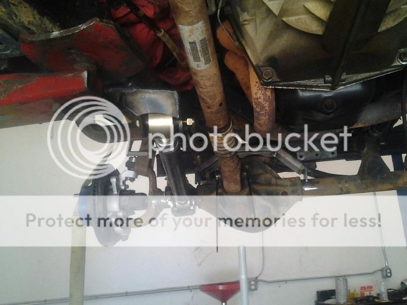

I decided that there was no way that I was going to get to this project any time soon so I talked to a local dealership about doing the work for me. They have an off road shop in house and a course on their property. The service manager quoted me a good price and said it would take a week, so I committed and dropped it off. Long story, but it ended up taking a bit longer than that and I finally picked it up last night. Flexed it out on their RTI to check clearances and everything looks good. I have a few tweaks I'd like them to make, but all in all, I'm really happy to have it done and off my plate.
Pictar Time ;D
Up on the lift. Way better than on jack stands in the garage.
Axle out for clean up and link bridge install.
Lower tacked in place.

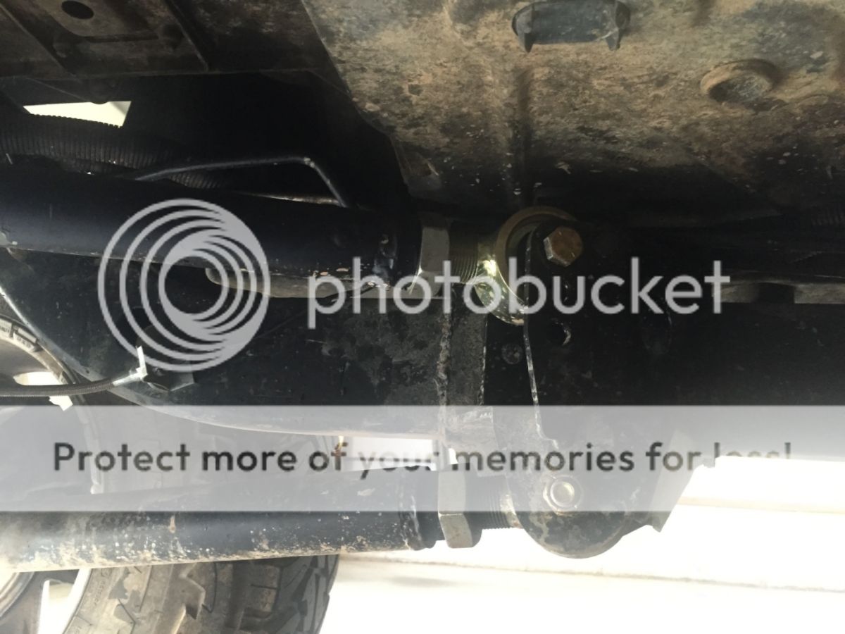

Custom upper mount. No Interference with the driveshaft, but not as much vertical separation as I'd like to have seen.
