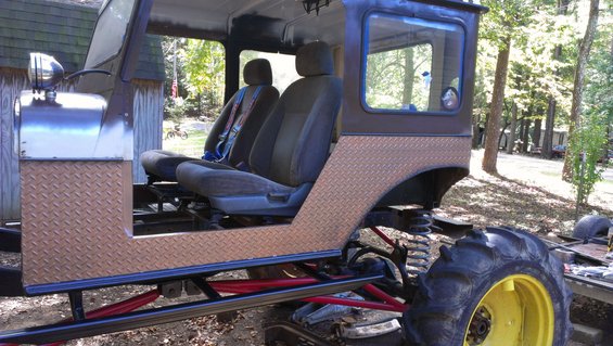

Ok so not a whole lot of progress this week....did get seats in and body armor welded on...going to edge it with 3/8 round to give it a finished out look as well as get rid of the sharp edge in wheel well...oh and ordered the stupid high dollar radiator i needed since the space i have to work with is oddsized...plus been under the weather just a bit..hopin to feel better tomorrow so i can get some work done...

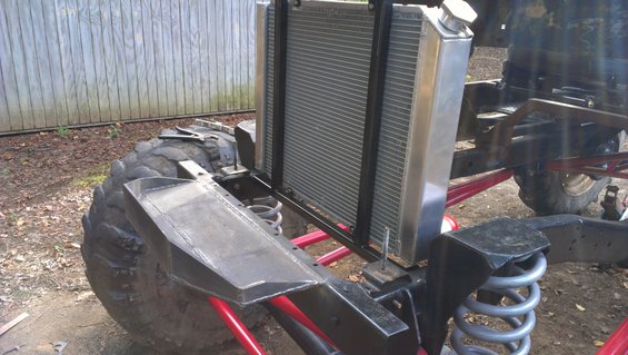

Ok so like yesterday i was able to get core support(radiator mounts) fabbed up and tacked but t-storm was hot on me arse....so no pics of that yet or the finish work on armor but will have later today....today ill be finishing up burning most everything in that has just been tacked and fitted so should be ready to move on to drivetrain install starting tomorrow..have allready move clifford( the xj) to under the pullin tree and drained it....so like they say on the "jeffersons"..."im moving on up"....lol...well check back in for more exciting news......muahahahaha...

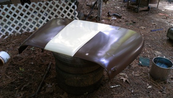

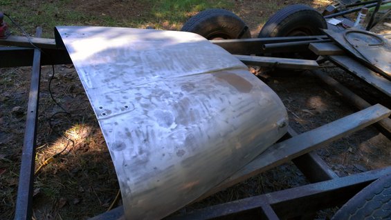

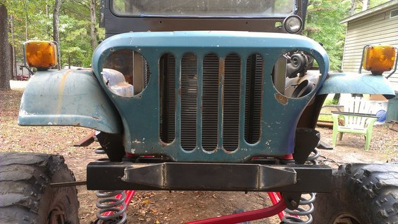

ok so heres a quick pic update...lol...i decided to take a small break from fabbing and slap some paint on the hood....lol
after a quick sand

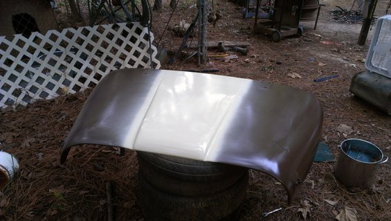

after fist coat of both colors...i like to overlap the colors before i mask off for edges...
after masking and final paint...

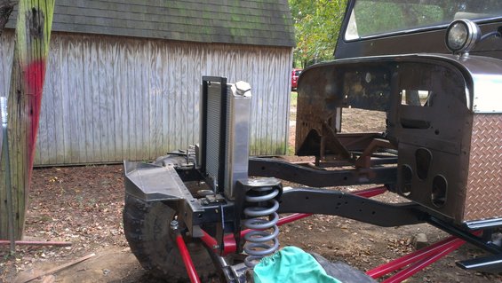

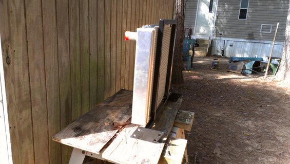

on to core support...lol

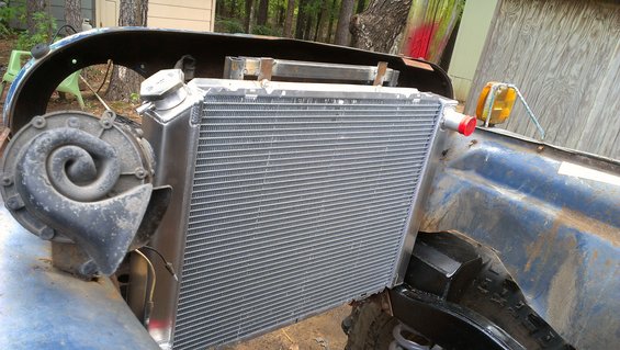

first heres the core...woo hoo
and here the finished support
some pics with panels bolted on for test fitting before final welding of support
finished support with core
core support bolted temporarily for giggls
back up lights...lol

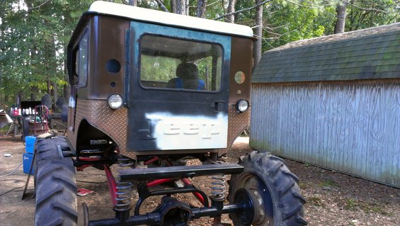

here is a pic of the finished body armor with the 3/8 round added and seats in...lol
the seats are from a 94 accord.....the core is a Be Cool from summit.....the core support is made with 1" 10 gauge square tube and 1/8"x1" flat drilled for tabs
