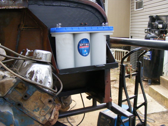

ok so more pics...lol...and rambling...

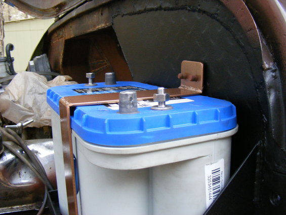

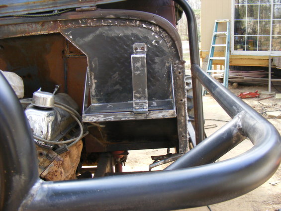

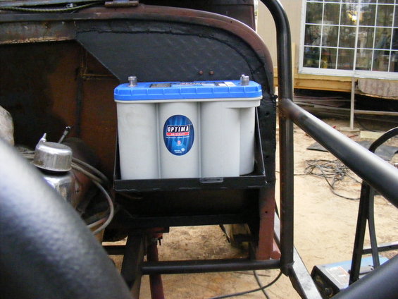

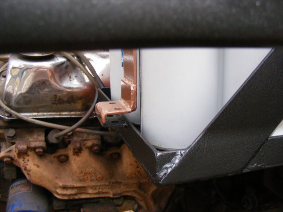

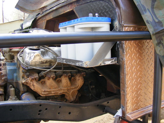

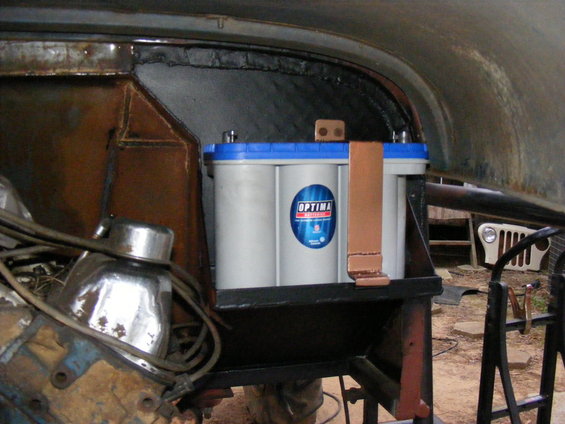

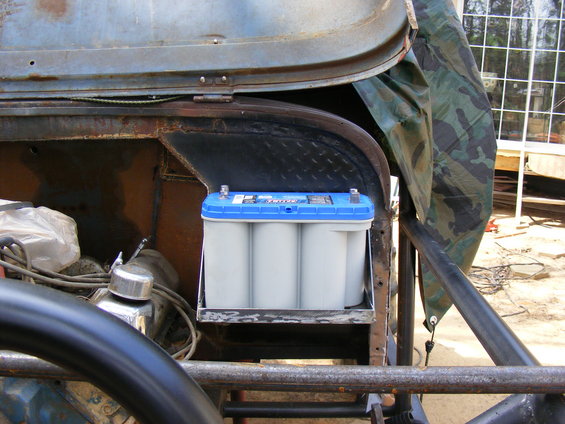

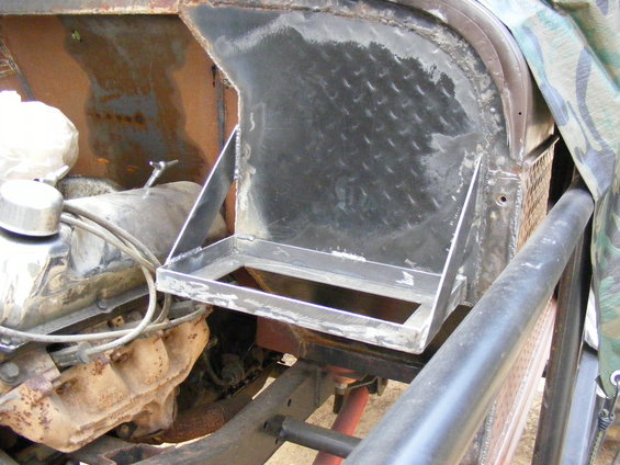

well despite the impending rain, which never came thankfully I got out all the tools and decided the new Optima needed a home, as it didn't have one....

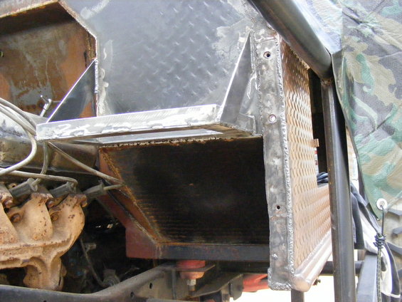

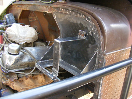

being as I had looked online for a cool battery box and really couldn't find one for the D31 series I decided to just whip one out...
started with some pieces of 1/8" flat bar in different widths...
somehow I thought I had taken more pics during the process...but here it is tacked in place for a test fit...
and burnt in....

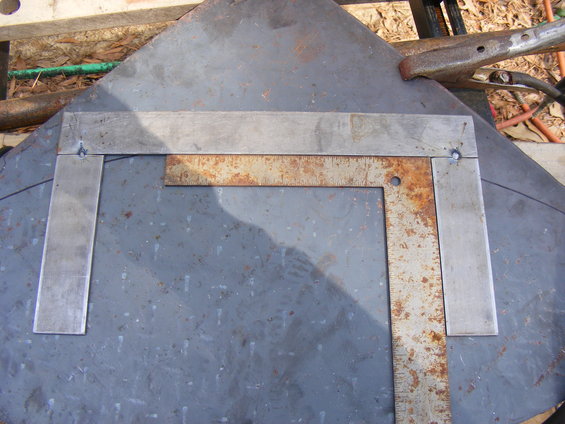

and then I whipped up a hold down....to do this I simple scored the 1/8" flat where I needed it to bend then used my bench vise to hold whit I bent it into shape...note that the bends must be scored on the opposite side of the bend itself, then I simply welded up the scores when done, then a little clean up....
coated it all with some bed liner...as well as the front bumper and some of the front tubes...I was working with leftover cans so didn't get a lot of the cage done yet plus im still working on parts of it...
don't it look pretty...
new to me ...old crusty booster/mc assembly...lol

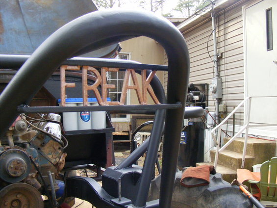

oh yeah talking bout the "freak" baby....woot woot....

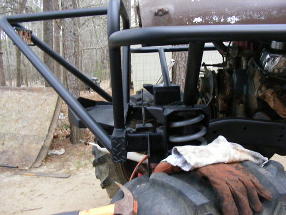

hold down all painted up...waiting on me to make a trip to get it some bright shiny nuts(in reality a waste of money as I prolly have over a hundred or more that will fit it...lol)
couple of random artistic shots...lol
plenty of clearance....
and some tan bed liner on the inner firewall and cowl section, getting ready to start on the wiring and final placement of dash....from the bend/angle change in the floorboards down the bedliner will be black even tho the tan is rapidly growing on me...lol

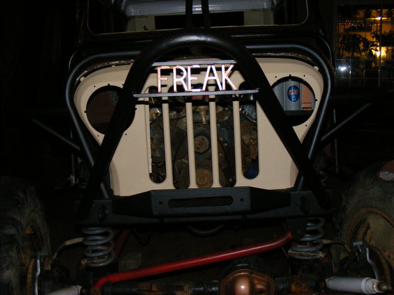

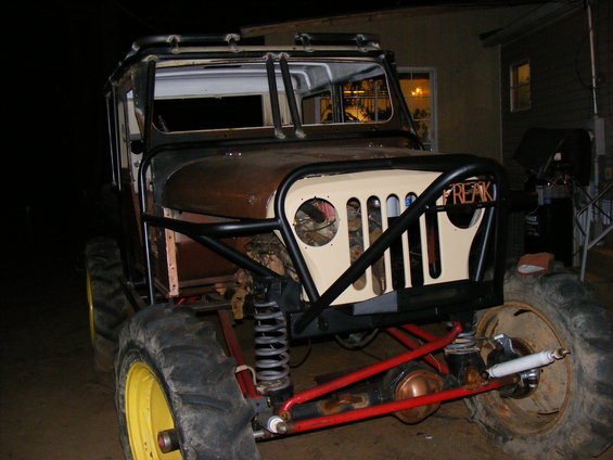

and just because I couldn't resist....a fresh coat of bedliner on the grill as I figure it will see heavy abrasion from bushes branches and constant use of the winch....
and so ends yet another fun filled pic update...hope yall enjoyed....its nice to finally get a glimpse of what my finished product is gonna look like....im kinda excited....well till meet again jeepers

your quite welcome...consequently I used the same process when I made the front winch mount...you can draw out your plan on a piece of cardboard cut it out see if it works(folds up right) then use it as a template.....another note is if you have holes to drill make sure to plan them out well and drill before bending....particularly if you have access to the much easier drill press method of drilling holes..

ok so after looking at the grill I painted with a nice coating of the rust-o-leum tan colored bed liner, I really really like the overall look especially how the color pops with the black exo.....am seriously contemplating coating the entire remaining body(not the diamond plate just the upper body) with it....I have to consider where and what type of terrain I ride...the trails grow up in the spring and usually first rigs thru catch h***....so to not have shiny slick paint showing all the scratches and scuffs might be really cool....have done the whole "Flat Black" thing before after a week it looks like s*** and the mud doesn't wash out of it and and and.....so any thoughts? objections?....my only concern is the cost....in theory I have the paint to paint it the way I originally planned(actually I have it), but I could use it to finish the paint on the little dj as they are the same colors just reversed(pretty much)....I know I cant ever make up my mind.....
