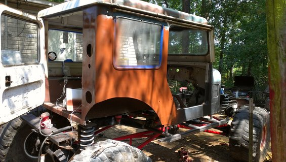

ok so here it is long awaited update time....i can tell you were all hanging on the edge of your seats...lol
some pics of finished interior mods to make room for seating...(umm comfortable seating that is...lol)
roof almost done
finally got around to drivers side rear quarter sheet metal...if you look back you can see this used to be awful

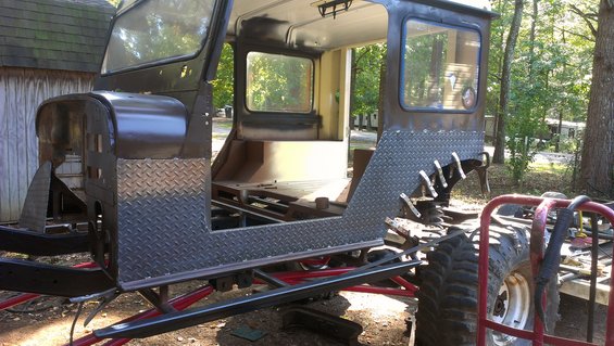

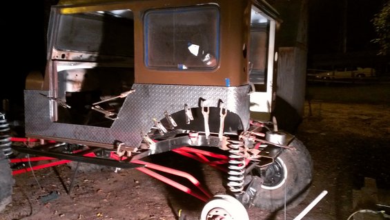

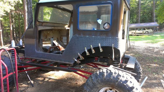

now on to fun stuff..."Body Armor"...yee haa...this was made out of 1/8 inch thick diamond plate...all cutting was done with the plasma and grinder...every thing else should be self explanatory except the fact i chose to weld on instead of bolting...
pretty much finished here but need to remove tire to stitch backside at fender opening
ok so like thats all i got for now...just got the plate for the other side today and got most of the floor cut out of the scraps from first piece...so should have another pic filled update soon

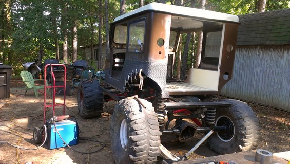

ok just in case no one was paying attention my 2 favorite fab tools are in several of the pics...lol...not to mention my trusty trailer/welding jig on wheels...

How did you make that bend so nice where the diamond plate curves around to the rear of the cab. Did you just heat it with a torch? The reason I am interested is because you seem to be accomplishing a lot with limited tools and no roof to work under.
"The problem with quotes on the internet is that you never know if they are real or not" - Abraham Lincoln
auburnhunter is offline
post #73 of 995 Old 09-30-2012, 09:23 PM Thread Starter
freaknajeep
1971 DJ
Location: Tupelo
Posts: 937
I just strong arm cold bent it then when it was close enuff i used 3 clamps two on top and one on bottom and would tighten each just enuff to make the others loose till it was tight around...and walla pretty bend
