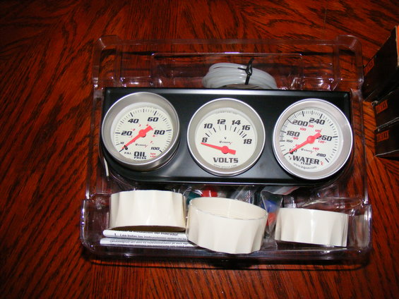

ok so here are some pics....nothing special or fancy mind you but pics none-the-less....enjoy..

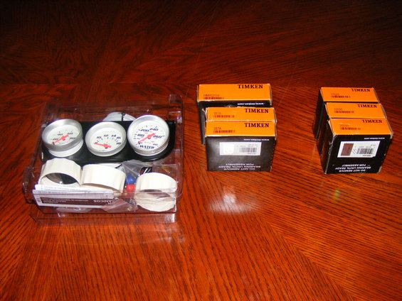

starting with parts.....
gears, carrier/spool, install kits, alt, solenoid, and gaskets...

dangit wrong button...so pics continued...lol....
more parts...

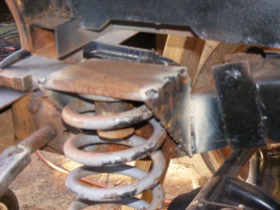

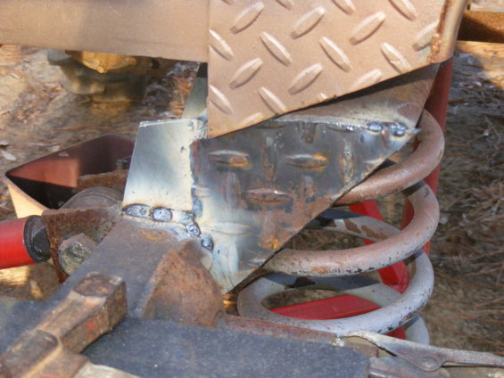

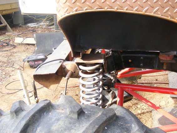

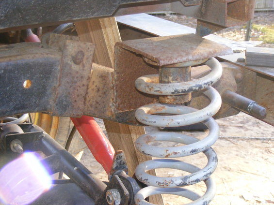

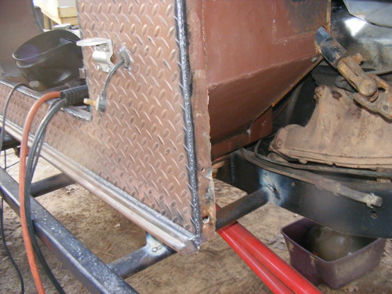

ok so on to some minor fab pics....i.e. upper rear spring mounts....
before as temporaried in....
after....plated and gusseted pre-cleanup....

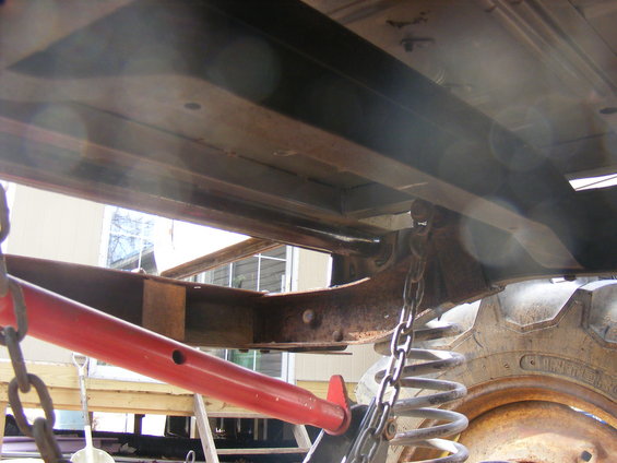

if you look hard you can see the brown piece of 1" sch80 connecting the two upper spring mounts...
limiting chains....

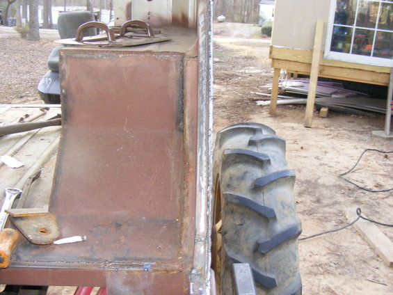

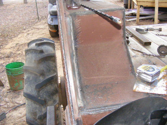

ok on too a few pics of the miles of welding and rear filler panel....
starting with filler panel....
before...
after...
in conjunction with upper spring mounts...there is 1/4" spacing between filler and mount....

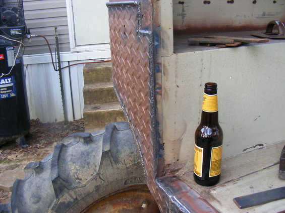

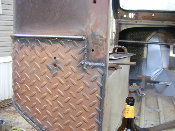

on to the miles of welding...all the 1/8" diamond plate is fully welded to prevent mud and water getting in between it and body....fun ...fun...

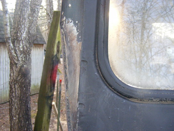

clippin the ears....

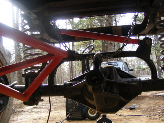

So I am new to the extreme fab world, could you explain to me how those arms work having the uppers and lowers attached at the same point on the frame?

Not sure if I can explain it but I can tell you from the xj I had with same setup it is plain sick....I had to strap everything to keep from running on the sidewalls when in extreme twisty situations......you have to understand that one side only has one connection at axle so it kinda like a bastardised 3 link, having a y link on one side prevents axle wrap and track bar keeps it in place side to side. ...the front is basically a long radius arm setup. ...ill prolly go back with rear setup in front if I dont like how the radius arm work...which is how I had it set up in the xj

CommandoSolo here is a pic to show some of the axle to body flex...ignore the body roll, one of the front shocks is frozen preventing the right front from pushing up...I am still going to go with some softer rate springs in front as well tho....I know that the pic only depicts a small amount of flex and im nowhere near full stuff which had I a second floor jack I could have achieved...but should give you an idea of net end result even tho I still cant explain it....it took many many twelve packs and about 3 proto types 6 years ago to design....er-body said it would never work but it did and and uber well I must add.....
this being the xj, and if you look up under it you can see the exact rear setup im using now...
and heres the flex pic...
hope this helps a little...like I said you would think it wouldn't work but it does....
