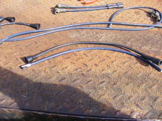

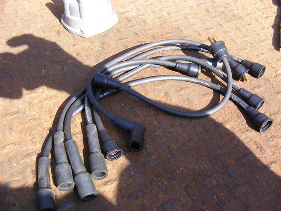

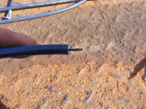

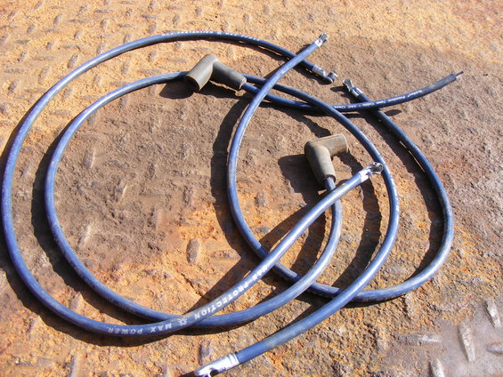

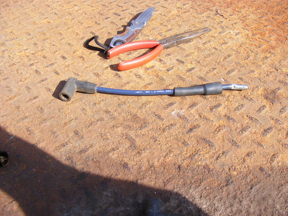

ok so pic time again.....ill start with the broke d**k tech section....
sparky wire 101.....
first you need some supplys....
the new wires I just bought for the points distributor...
a few high quality HEI wires I never used that came with a chevy...with most of the boots removed
the boots for future use...
then a few basic hand tools..
ok now to make wires....the gm wire set had the same type of terminal on each end which was perfect for the distributor connection....using the boots set aside earlier I was able to get 2 new wires out of each of the donor wires...so heres how I did it....
wire cut to length with 90* boot replaced....
then using a nice sharp knife carefully cut back the insulation exposing the core...about 3/8"...
I wanted straight boots at plugs so I took the terminals from the points wireset...then folded the core over and recrimped the terminals with the wireset crimper from the tools pic...
i slid the plug boot on before i crimped on the terminal making it easier to complete the wire....
and walla a nice new set of HEI style wires which other wise would have cost me about 40$.....
