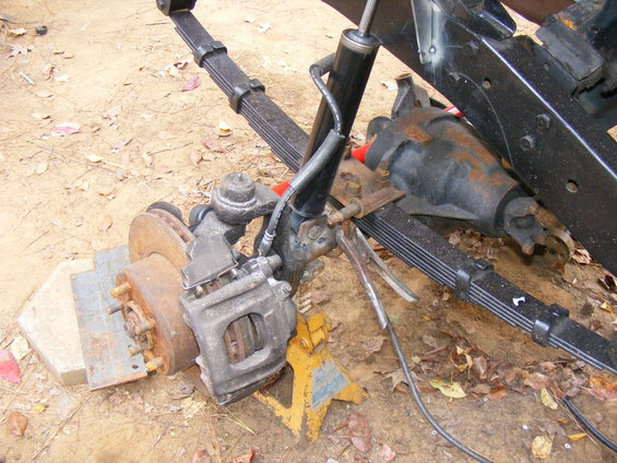

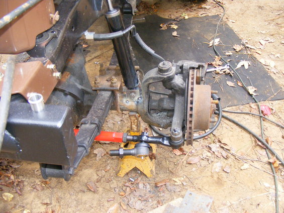

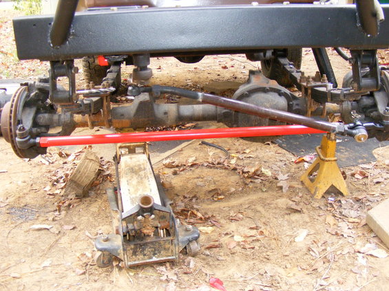

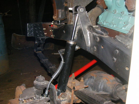

pic update time..

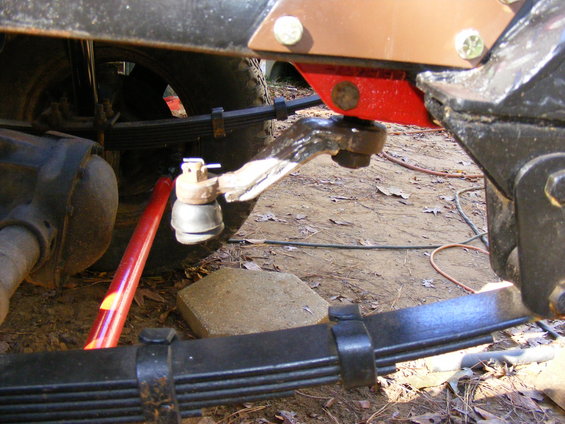

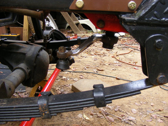

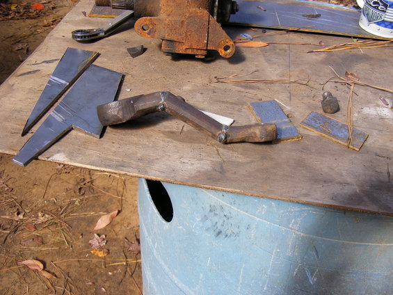

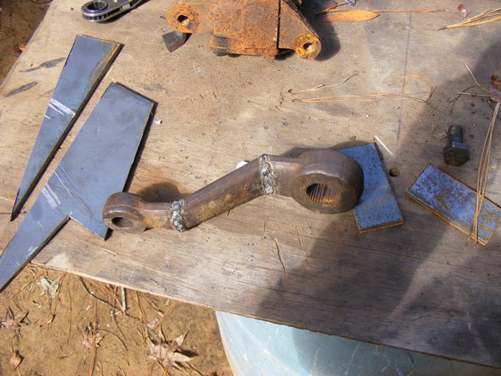

pitman arm...

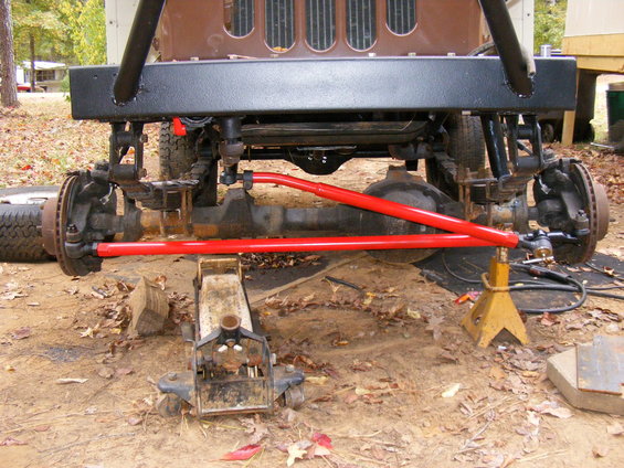

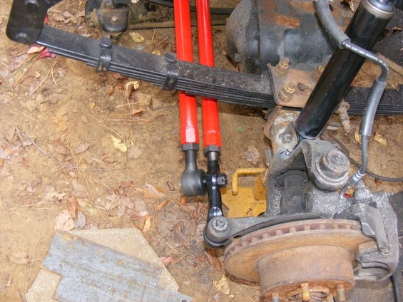

shock towers/mounts...

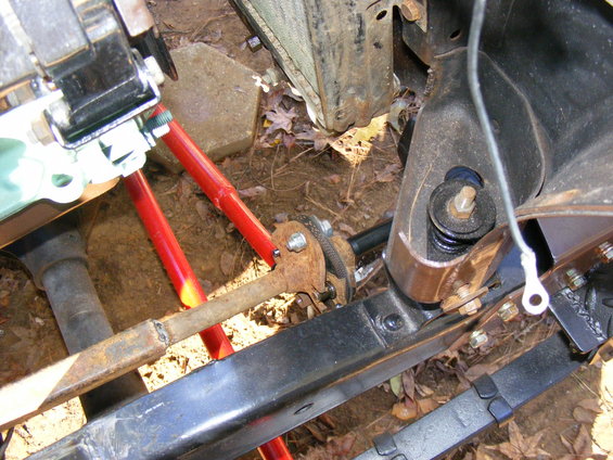

steering coupler...
before...
after...
finished steering with plate added to pitman arm(just in case...lol)

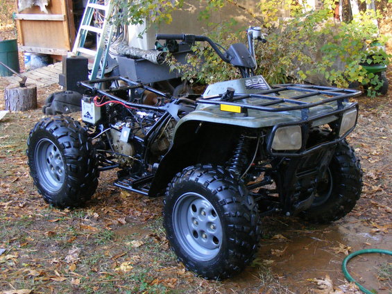

and the new toy...
yes its a complete bike just doing some cleanup

Awesome! How did that Pitman arm weld?

Posts: 12,037
its cast steel, i imagine fine as long as he got it hot enough
some are cast and some are forged depending on the year and applicaton....it welded like it was forged but I plate it anyways..since it wont see any offroad use it should be fine...but they don't make a drop arm for the dj box...so I had to do it...lol

post #606 of 995 Old 11-18-2013, 08:33 AM
spyder6
Got that Toyota chit
spyder6's Avatar
2010
Join Date: Feb 2006
Location: Louisville, KY
Posts: 12,037
I mean even if it's forged you just need some hella heat.
Did you peen your welds on cool down?
since I weld with flux core I used a slag/chip hammer to remove the slag...it was still pretty hot at that time, so I guess that might count as peaning...lol...I found the slag comes of better that way and by the time I ran one solid bead all the way round the precisely bent piece of 3/16"s plate the entire arm was red hot..i allowed the plate to be oversized by 3/8'" of an inch then filled the huge v (pitman arm is slightly oval shaped)...used about 1/2lb of wire....I do have rods for use with my torches specifically for welding cast tho but my torches have been empty for about 4 year now(since I bought my plasma/tig, which is fixing to make a trip to Cali to be fixed)...I bougt the rods to weld up a 40k mile 4.0l I got from a fella for free since he somehow let it freeze...ran it for 3 years then started a project left it sitting on a trailer manifold side up...it filled with water and ruined(stupid tarp)....but I still have the rods...friggin 75$ a pound..ouch
