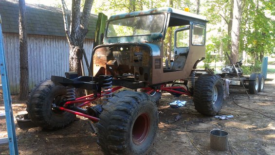

thanks man im glad you like it...i sometimes cant believe it thinking back to what it looked like when i first saw her sitting all alone and neglected in the scrap section at an auto wholesaler....i gave 500$ bucks for her and was paid 200$ for the scrap motor and suspension from under it so before all the new stuff total purchase was 300$...however in my mind she was supposed to be a little closer the ground...but she is completely unloaded at the moment...so im hoping she'll squat a little
I hear ya, what size tires are you running? With those tires and the lift given from the long arms it could squat more, but it still seems like it has a solid stance. How in the heck did you think up how to make the suspension? I would like to attempt this one day, just need to get a little better at welding. Keep up the great work.

well originally those were 39.5x18 boggers...now they are like oh say a 36" drag slick...lol my other tires at the moment are 43x11.5 tractor tires..but i hope to level out with a new set of 38.5x15 boggers on 15x8 rims

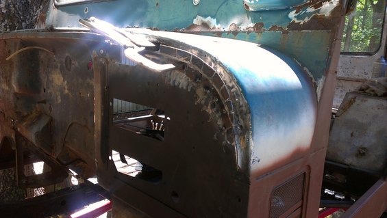

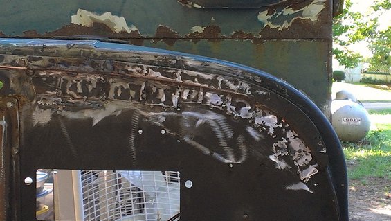

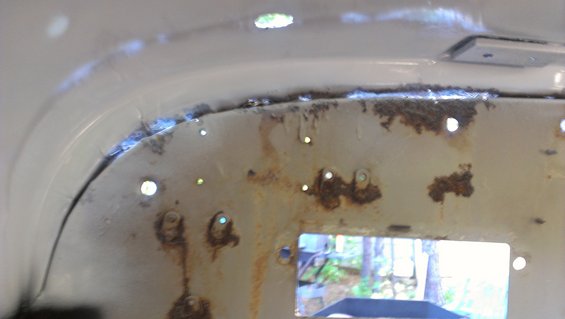

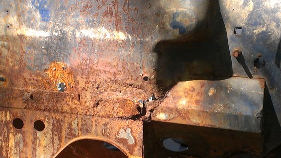

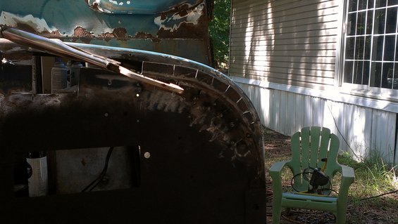

here once again its update time...lol....
this one focuses on more stupid cancer and in a yucky place too...i had been putting it off cuz i new it was gonna be a total pain but i guess it turned out ok not like anyones gonna see it anyway...lol
so here goes....

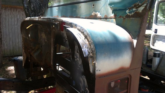

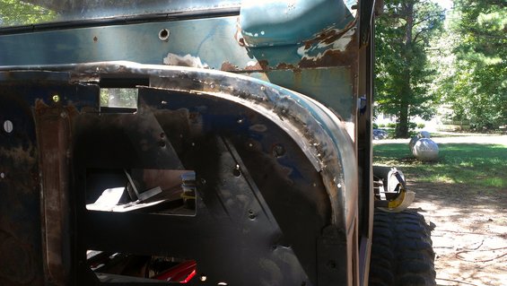

front clip removed again...lol
some pics of the rusty cowl-to-firewall pinch seam/driprail..
just some floorboard rust will get to it later...lol

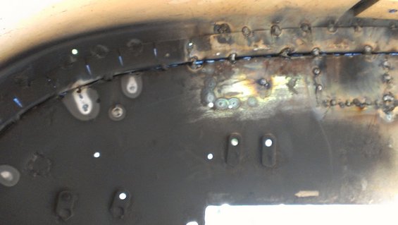

temporary backing plate to make sure nothing moved during cutting...this is held on with sheetmtal screws to both cowl and firewall, and by loosening the screws it allowed me to use backing plate as a clamp to get new pieces in tight
after cutting rust away
you can see the screws...lol
first piece in ...i left it alittle long so i could get thee lip right
second piece going in...i spotted up all the little cuts...it wasnt any fun..this piece has 2 90deg bends as well as the swoop...uugghhh
a shot from inside the cowl...you can see the welds penetrating thru...
finished product...took 5 pieces and about 6 hrs to fix that area and i know its not pretty but a piece of mat and quick coat of glass and i could make it dissapear but why its a 41 year old service jeep thats finally gonna get its day in the woods it deserves its battle scars ...hehehehe
a little more filling a little grinding and a quick swipe of seam sealer and we all good...lol.......
well stay tuned for the am update ill be adding more tube to the subframe to allocate for the trans tunnel and getting final position of cab on frame,,,cant rally call it a tub can i???...lol

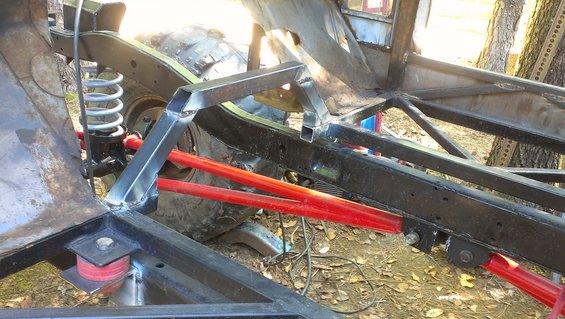

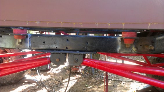

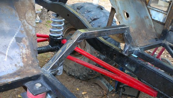

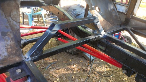

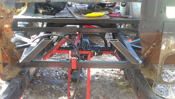

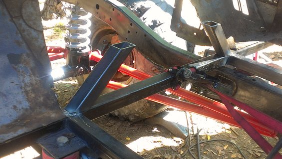

ok so its like shortly after 2:30 in th morning where im at...lol....my dad used to be a musician and every night he'd come home sometime between 1:00 and 5:00 and i would have to help get all the gear inside...so even now 25 years later i still cant sleep thru the night so........blah blah blah...so well on to the point,,,pics...yay
body mounts tacked in final position
trans tunnel work..lots more to come on this need more steel...lol
all ground down before primer
in this pic im just showing the little 45'd piece in between tubes a second one has been added

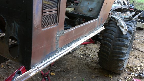

just a little something to finish off the bottom of the tub/cab....(can anyone guess what im using for this....hint its an original piece of the jeep)
ok well once again we come to the end of a........ahh who am i kidding there is no end in sight...however did get one of the sliders made up today and tacked into place...will take pics as i build the second tomorrow and show you the finished "bottom of cab piece"...hope some one has paid enough attention to this build to figure out where the metal came from...lol...tomorrow hope to push/pull truck out to the pulling tree(about an acre away) and get the motor set in chassis....then back to behind the house where there is power
