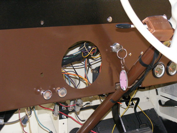

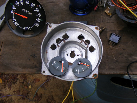

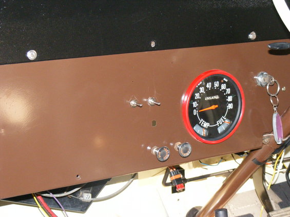

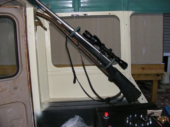

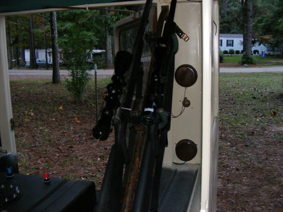

ok so a few quick pics...lol...
so this here would be a pic of the opposite of progress..
all back together...

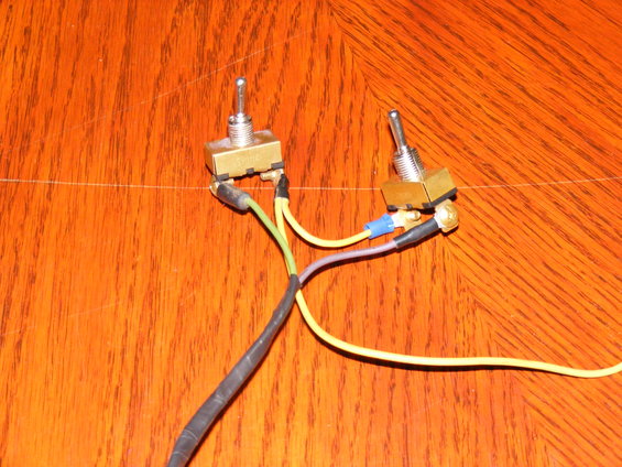

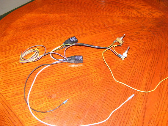

relay and switch harness for the blower motor...
pile o parts.......

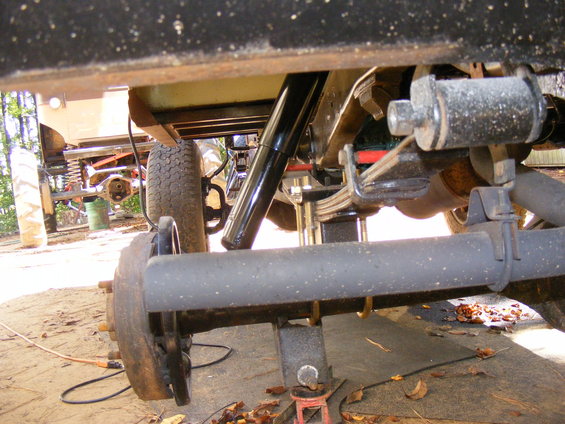

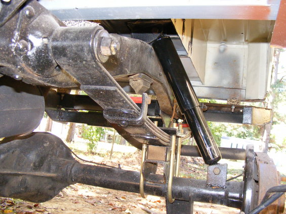

shocks installed in rear...
new fuel pump..

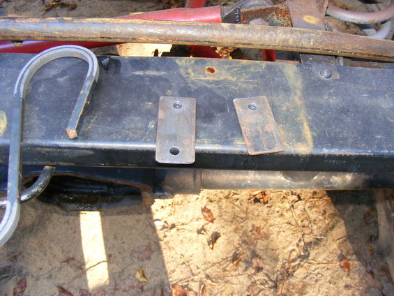

now on to fun stuff...on board arms rack...
some tabs..
the hooks...
the tube...
just add arms....
I still have to drill the three mounting holes and fab up the pieces that will allow me to lock everything up....I found that I didn't have enuff steel for the front shock mounts so gonna make that run tomorrow...man it seems like the list of itty bitty things is never ending...well till the next post yo....
