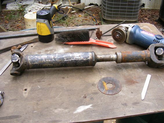

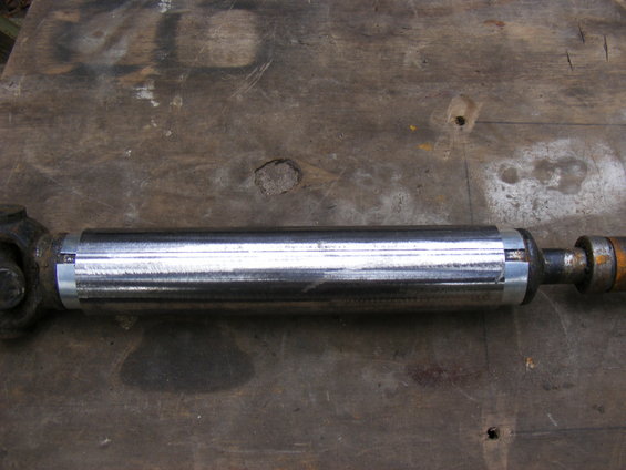

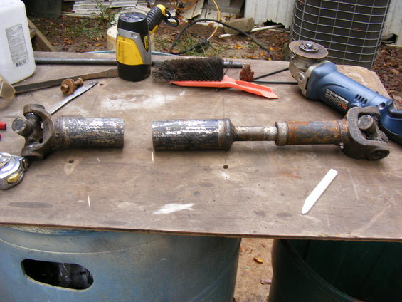

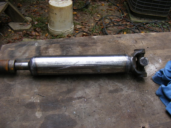

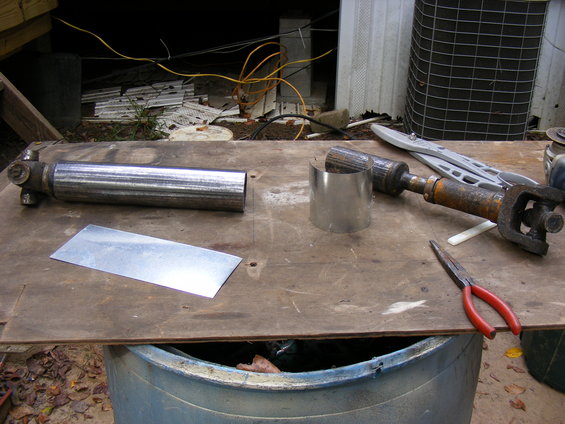

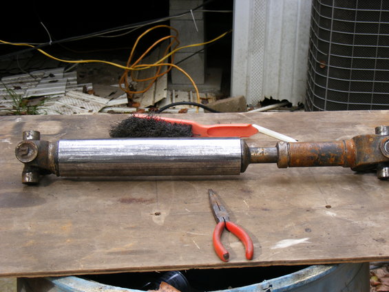

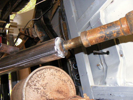

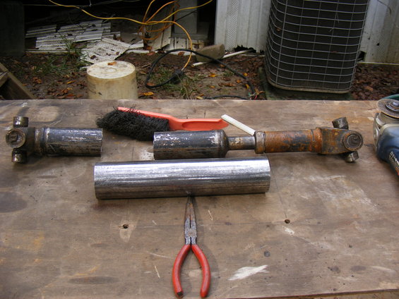

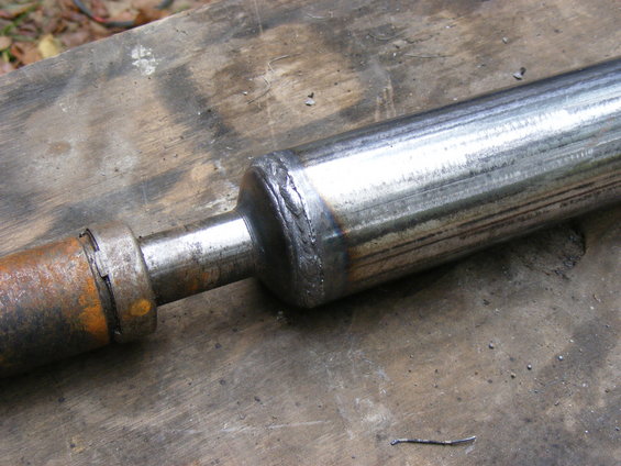

ok as promised driveshaft 101....
I started by cleaning up and cutting a section of tube from a previously lengthened shaft....
next I cut the factory shaft in two...
after using a short section of angle iron to align the two pieces of shaft I was able to get an accurate shaft measurement....sorry no pics of that the skeeters were after me...anyways the heres the sleeve..
test fit for snugness,,,it was l little loose not much so I cut some strips of 26ga and shimmed it...
one for all you uptight peeps out there...chillax yo its all-good!!!!!
after a couple quick tacks...the final test fit...
all welded up....yeah I know not as pretty as with gas but hey itll do...
well that's the end of pics for today.....one other thing I forgot to take pics of was I scribed several alignment marks down the entire length of shaft, before cutting....this helps to keep the factory balance close..hopefully I wont have any issues otherwise ill have to have a custom shaft made...ive done this several times with good results, so here to my fingers being crossed....hope you enjoyed

Great work man! I'm very interested in how the vibes are going to be. Let us know. I might try doing my own and try saving a 100$.

Simply amazing, everything you're doing, you're doing with min. tools, and no garage over head. Nothing high tech.
That pinion angle looks like it may give you some vibrations. You thinkin' bout shimmin' or just see how it does & address it at that point?
Keep it goin, I wanna see Picts of it runnin!
Oh ya, keep your rants, run-on sentences, & lack of caps / punctuation. Love it & "F" anyone whose got a problem with it.
Thanks....I tried to get the pinion and trans yokes as close to the same angle as possible...I think the axle will shift upwards a small amount oncei go thru and put the final torque on it..it's not fully seated against the springs yet.....in the past I always eliminated the non slip single joint for a CV double joint section...which eliminates all vibes caused by angle...now as to weather or not it'd balanced or true, is a completely different subject altogether...I did my best so we shall see...
Don't worry if I haven't learned how to control my opinion or learned how to type by now, there's about a 100% chance it's not going to happen...lol...
once again thanks for stopping in and saying hi and giving your advice...while I've owned several XJ's these little jeeps with frames different creatures...it's very different when you try to build a streetable version...

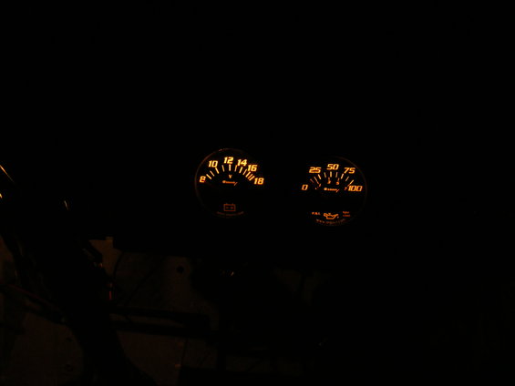

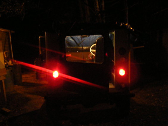

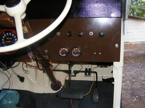

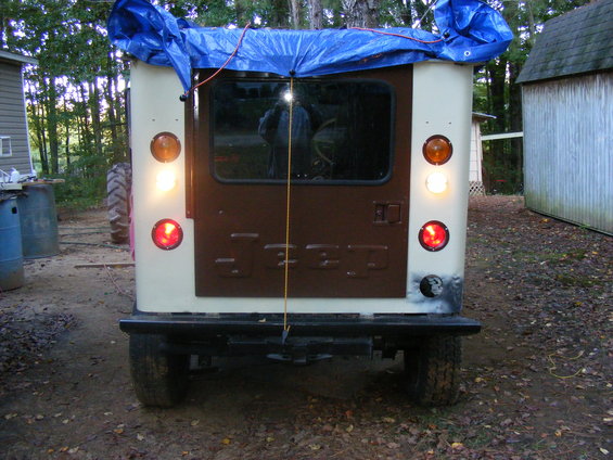

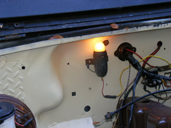

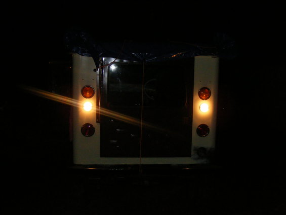

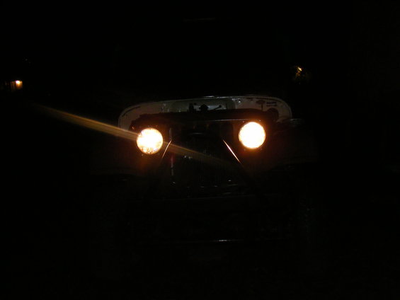

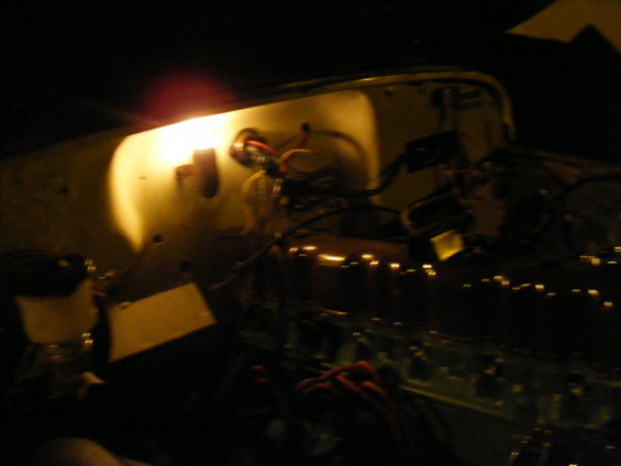

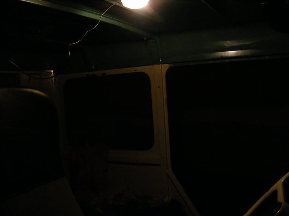

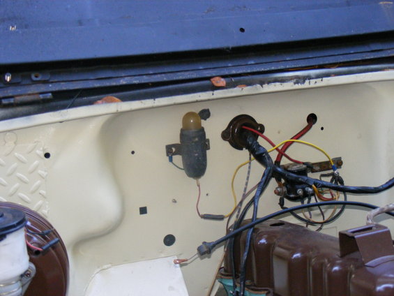

ok once again as promised pics...
first up the little under hood light form one of my retired 72 Datsun 240z's....it looks factory.....i prolly ought to paint it up all pretty like...sorry for the crappy nighttime pic my hands were shaking pretty bad...oh and it has a 3ft reach cord is stored in housing..
rest are just lighting pics...some day some nite...
gauges
disappearing reverse lights...lol
rear parking and check out the brightness of the interior light...ha ill need to get some nightshades...lol
interior light...originally this was mounted on the bottomside of the cardboard headliner which coverd its wire...im going to have to extend it a little in order to route in a manner as to attach it...
and then head lights.woo hoo so so exciting...yay go teamzzzzzzzzzzzzzzzzzzzzzzzzzzzzzzzzzzzzzzzzzzzzzz zz...sorry fell asleep...lol
once I finish the final routing and clean up, ill take more pics...its so close I can almost taste the bugs in my teeth......a
