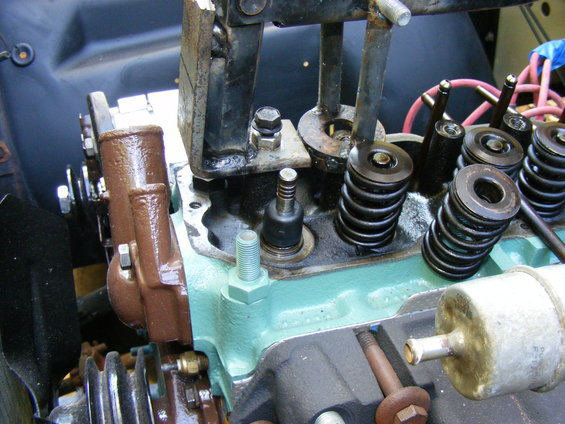

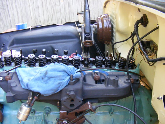

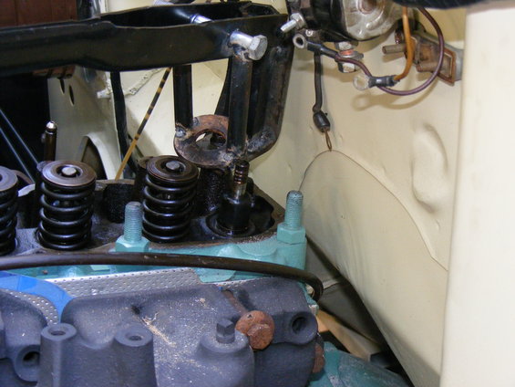

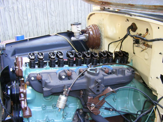

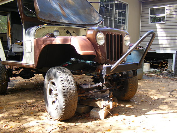

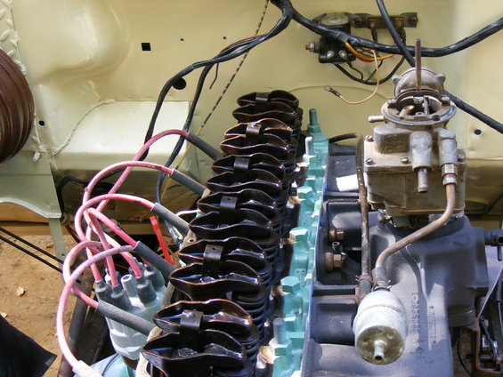

ok so for all you folks hounding me for pics...I wont mention any names^^^^^^.....heres the latest set of pics...
first a couple more of the stinger(with bedliner)
bits and pieces of stuff gathered to make valve spring compressor...I ended up using 2 pieces of 1/2" round solid 3 1/2" long instead of the 2 bolts...
the finished tool...I drilled a 3/8" hole thru the jack handle for a pivot for the actual contact piece, and added a stretched out piece of tube around the bottom side of the washer to prevent slippage....took about 30 minutes in all to make and cost well....nothing...
valve cover removed...
and rockers...
first spring off..new seal on...as you can see im using the rocker arm bolt with a nut to secure the tool to the head...it worked super easy, with out all that fuss of trying to keep it from slipping off the springs, or binding up like the ones from the local parts stores....took about 1 hr total to replace all 12 seals including time to pull and stuff cord...
rockin right along over half way done...woot woot
yay last one...this was a little tight to the fire wall and still took less than 5 minutes to do both the seals...
all back together...
whats left of the old seals...
even tho I have a rather large air compressor, I chose to use the old school rope method to prevent valves from dropping...just in case you don't know what I mean ill explain...No I did not tie a rope to the end of the valve stem......you simply make sure piston is at its lowest point , then you stuff about 3-4ft of 1/8-3/8" braided or woven nylon cord in thru sparky plug hole turn motor till it stops and walla valves cant go anywhere...
the one fender that is on is there till I have a replacement it has a couple of cracks ill weld up on the inner fender part..i may end up fabing up my own flatfenders not sure yet...
im about 80% on the wiring and am not sure if I like the steering setup or not(I have to take in mind its manual not power)...even tho I said I wasn't going to do anything to the passenger/left front fender I have decided to at least grind all the bondo off of it, id rather it look like a piece in need of repair than a piece with a really bad and deteriorated repair...well my immediate goal is to get everything I can done that requires the least amount of funds till the 25th...then ill get shocks(I know I didn't get them), brake shoes and hardware kit, window seals, spark plugs, points, alt belt, and steering gear.....I told the wife I need approx. $600 to finish it to good running condition with a little paint work left..she said we hopefully should be able to swing it so I gots my fingers crossed....well that's all for now
