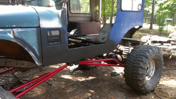

ok time for another pic filled update...lol

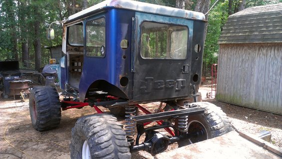

so heres the body going back on...notice all the extra folks around to help with this...lol...ha i did it in about 10min with 3 peices of pipe and 2 ratchet straps...
and "POOF" its a jeep...lol....front clip held on with like 3 bolts just for s**ts and giggles

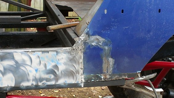

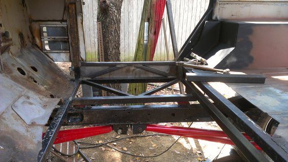

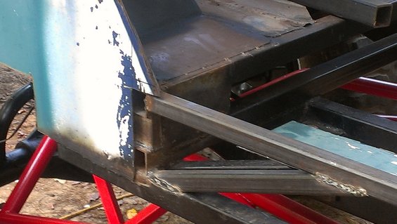

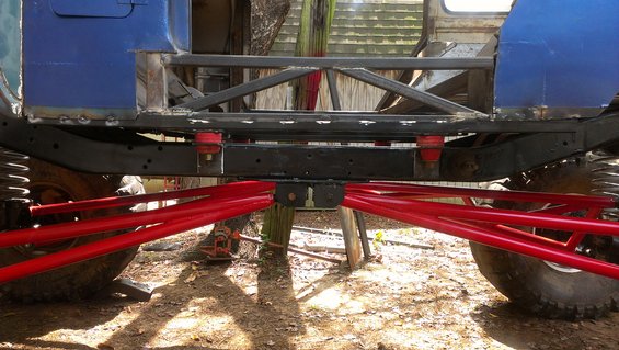

forward body mount and their relation to link tabs..oh yeah not welded yet...lol

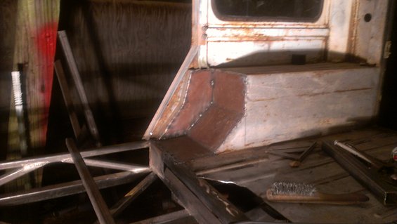

subframe and lower door sill bracing

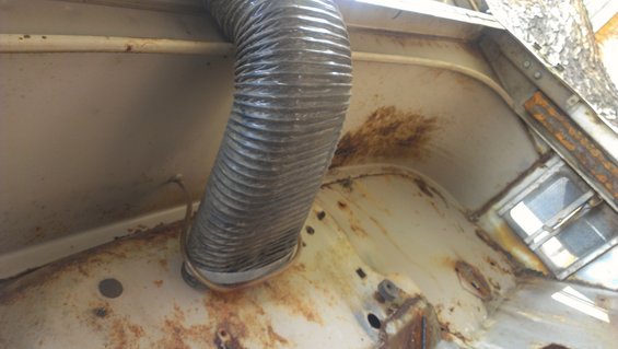

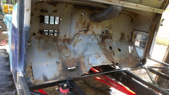

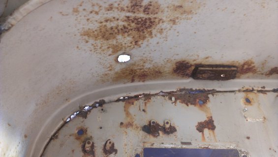

some shots of interior sheetmetal and under dash/cowl..got a little surface rust here but nothing i cant fix...lol
couple more poser pics...lol

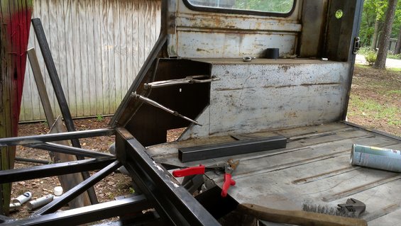

ok so much for resting...i test fitted a seat(you know a couple 2x4 blocks) and realized that with out modifications to subframe and rear floor and fender wells ill never be able to sit confortably...so now its back to the "funtimes" drawing board...phooey...will post pics of the new carnage shortly

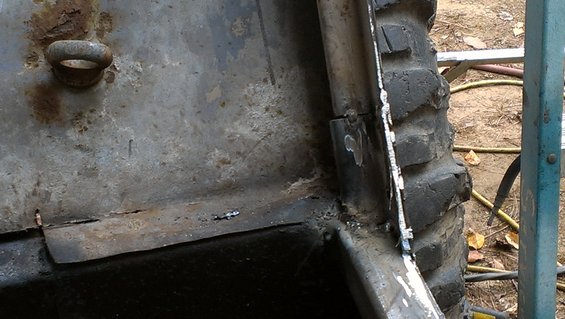

ok so i promised pics of the carnage also known as make room for seating...well heres a few pics

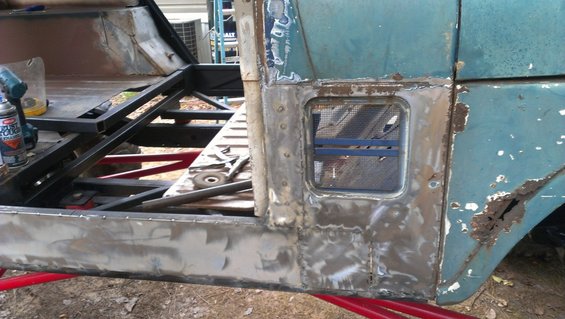

ok so as i promised time for pic filled update...lol..so lets start off with something easy...like
Drip rails(lead edge of doors)...lol
as they originally were..granted this is the driver side but i had started cutting on passenger side before pics
passenger side after first cut
second cut and final modification...still have to finish weld and grind but you get the idea..now i rolled the factory lip down to the body edge so it looks like jeep did it

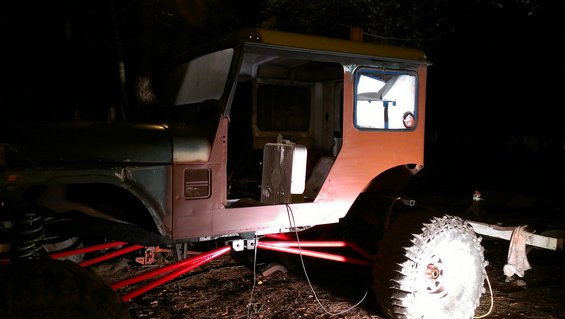

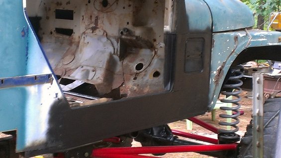

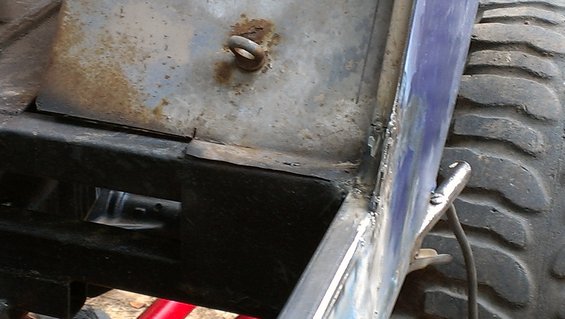

Passenger side sheet metal(body, dont forget its right hand drive...lol)
before...
after..once again im concentrating on getting everything tacked in will finish weld later in week after rain goes away
the stupid little corner..uugghh small but a PIA none the less
after a coat of rust reformer even tho it wasnt rusted(knew rain was coming...lol)
after rusty metal primer in the dark...lol

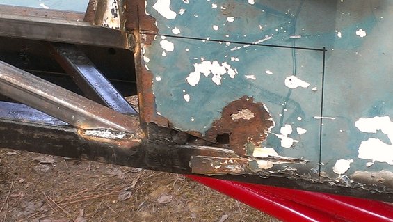

Drivers side sheet metal(body)
cancer...YUCK
there was cancer here but i cut it out
first piece in...thought i had a better pic sorry
from the inside
more cancer oh no!!!
after some surgery..i coated the pillar with rest reformer before replacing sheet metal
after tacking all metal in(the piece on the pillar has holes drilled and plug welded)
after coat of rust reformer
well thats about it for today its posed to rain thru tomorrow...so wont be getting to much done..might try and clean up heater box components...and one of these days ill figure wtf is up with my phone and the random pic sizes...lol
