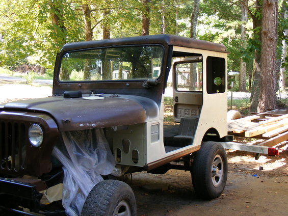

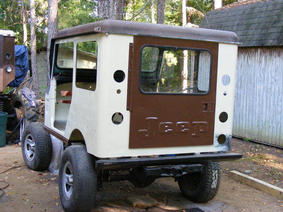

thanks...just been trying to get a first/sealer coat on everything and in the correct colors so I can see what my finished look will be..i have noticed that due to the rear upper side maker light having been bowed and leaking fo sometime and or the roof to body seam sealer having failed in gonna at some point actually have two 6' lengths of custom bent metal made then cut off roof replace the two upper structural channels and weld roof back on and reseam everthin....yeehaa yay me...oh well that can wait till the frame stretch...ill have more pics tomorrow or the next day, got another drs appointment in morning...did manage to get interior roof sanded and a heavy coat of rust reform on the rusted areas then a coat of final color on tho, as well as around the windshield inside and out...so now once its dry I can get my windshield back in

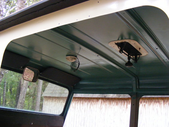

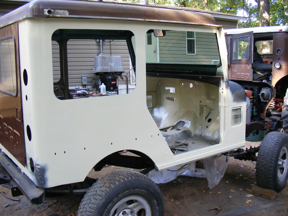

ok so no pics yet got dead batteries in the cam again...lol...but anyways...another waste of my time drs visit...but on to the progress....got windshield in...got wiper trans in...went to put what I thought was wiper motor on, ahh-ha knew everything wasn't going to be easy...turns out no usable wiper motor came with jeep...even tho wiper motor was good, it was no where close to anything I could use...so I was left with no other option than to make a template from the 71 with the externaly mounted motor and cut holes in the metal I just got thru replacing...lol...well at least now I got wipers once they have power..:;D:...which also means I had to use defroster diffuser from the 71 as well...wondering if any of the big jeep will b left by time im thru..gonna get battries tomorrow and get caught up with the pics..on he bright side both of the sunvisors were in like new shape and just needed washed as well as the dome light...so at least that save me a little time and money...and I got those installed as well...at this point deer season is rapidly approaching and my daily is rapidly dying so a few things are gonna get rushed....

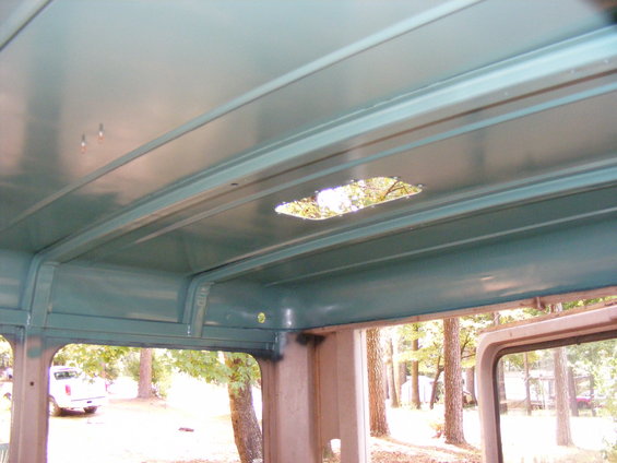

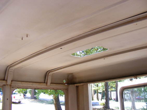

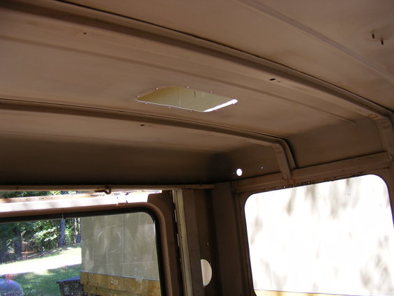

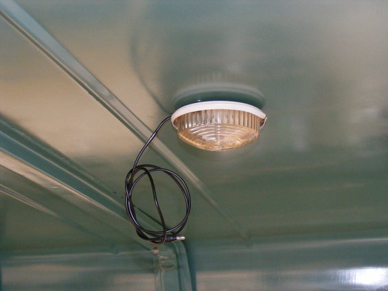

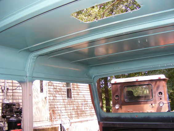

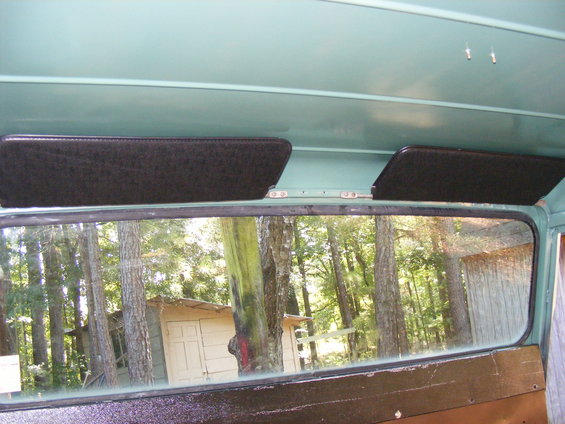

ok well I guess I can post these now as opposed to later....since I was finally able to upload to host site...lol.... just a few of interior roof before and after...
sorry there wasn't more but as I said ill have catch up pics real soon...

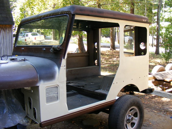

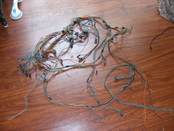

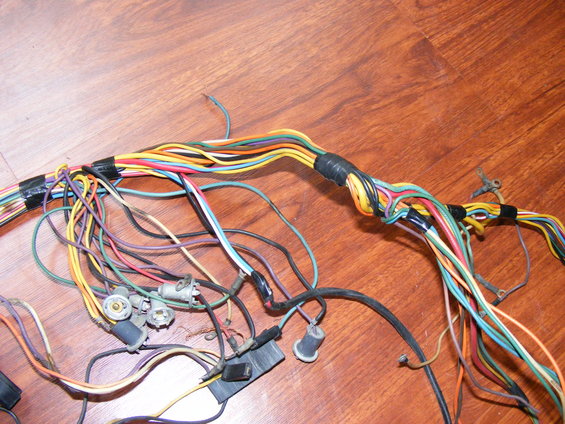

ok so first a few more misc. body and interior pics...

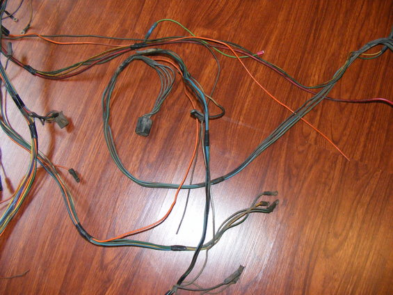

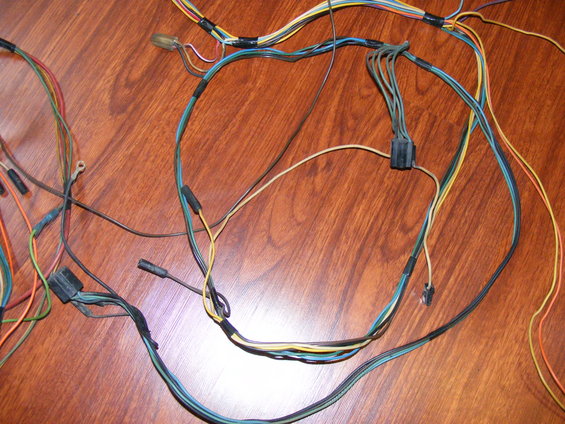

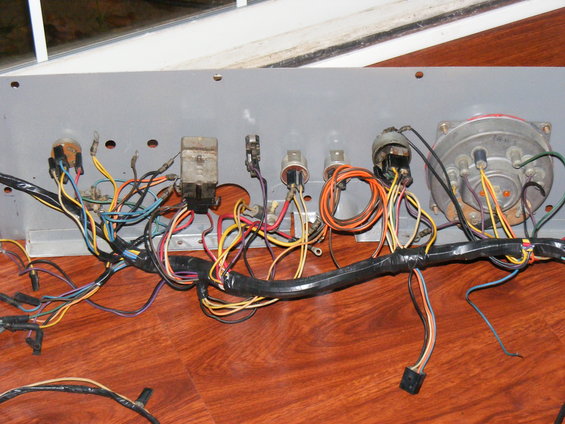

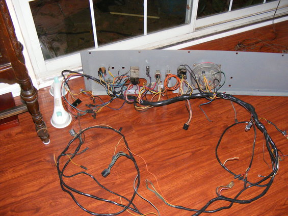

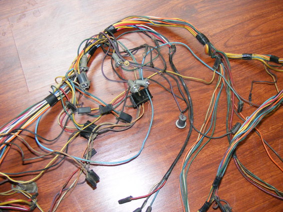

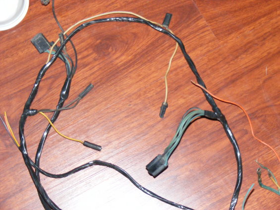

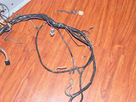

and now on to todays segment..." Spaghetti, Continuity, and fun with electrical tape....
harness after removing all preexisting tape, wrap and conduit...
after washing...
after testing, repairing and replacing...oh and about 3 rolls of tape and 3 hrs later....
some other stuff was done but no pics or even memory of what I did yet...lol....spent a total of about 6hrs on harness...but much easier to do all that wiring on dash on the couch as opposed to on my back upside down in the jeep...oh and word of advice to anyone!!!! go ahead and tell your self you remember where all those wire connect to before you unhook them but umm also go ahead and make a few notes as well...particularly if you have something weird like I do and cant find diagrams anywhere...still got about 4 connections I have to trace once I have everything I do know where go are hooked up...hrrmmpphh...

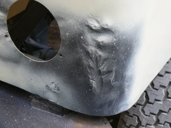

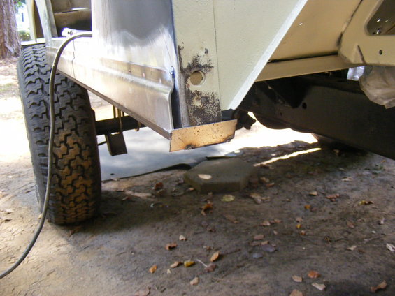

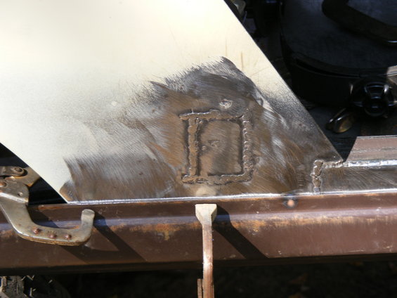

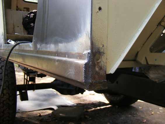

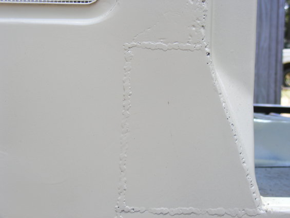

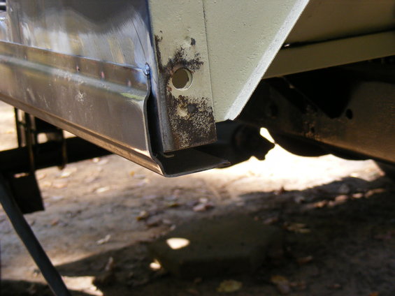

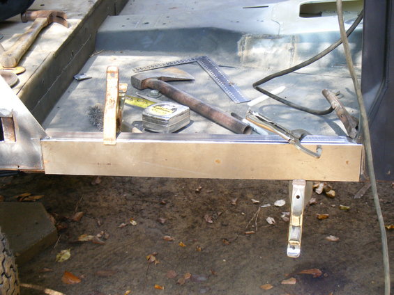

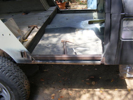

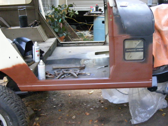

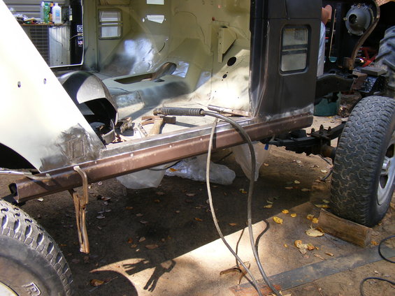

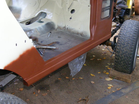

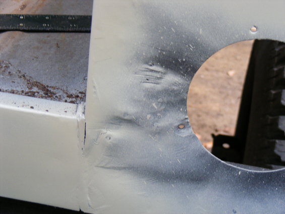

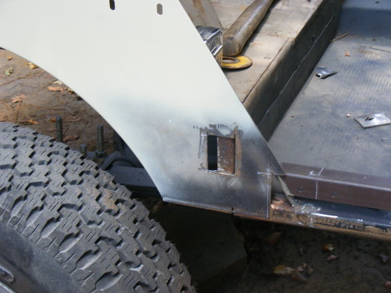

ok so got a little done today....got the right/driver side door sill and stuff done and got some paint on it still got a little work to do on the cowl so its still not painted yet...remember this is really just a sealer coat so im not to worried about overspray or overlap...itll all be wet/block sanded before final color...ok so on to the pics....
first up some close ups of damage I have to repair and also of some repairs I did on other side showing my finished(scarred) look "no filler"
starting the door sill mods....and a little cancer fix to boot...
all welded up...
some primer...
some paint...
and one from the rear...lol
well tomorrow should lead into getting the lower parts and walls of interior both prepped and painted so that dash/wiring/column etc... can start being assembled..

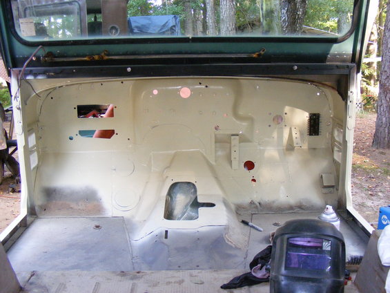

and so begins the rain.... well I did manage to get one side of the interior prepped and primed and the rear floor/bed are cleaned scraped sanded and reformed...now its ready for bed liner...ill try and grab a few pics before it rains too hard...ok well back to trying to make sure I have nothing I want to stay dry left outside...
