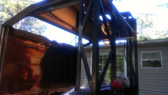

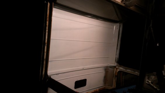

ok pic time...woohooo.....
roof before
roof after lots of work....black areas are the rust reformer the brown area is where i primed over reformer with rustoleum's rusty metal primer..
a pic of the lower door bracing and part of inner roof cleaned and reformed...
an after pic showing most of inner roof with first finish coat...somehow didnt get pics of the in between..sorry..
under side of rear with first coat of glossy...this will all be under/truckbed coated ventually
well once again thats all for now but more to come real soon...lol
