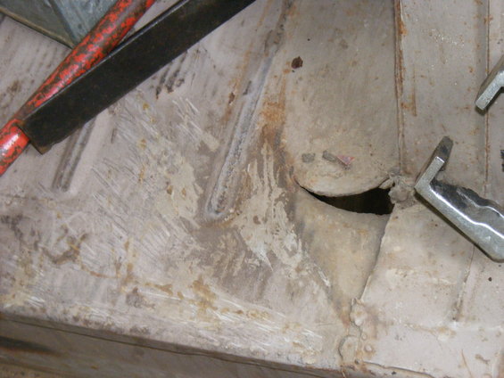

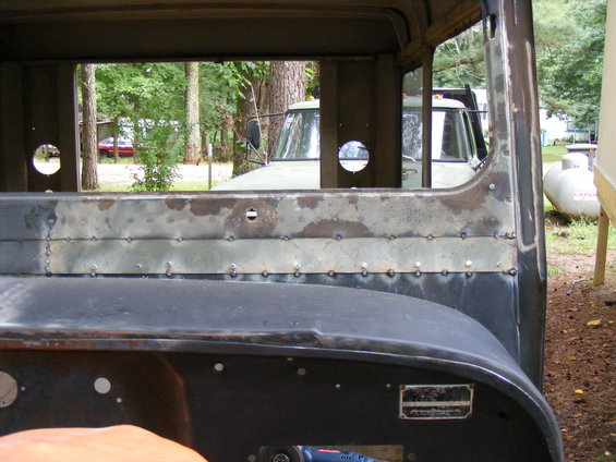

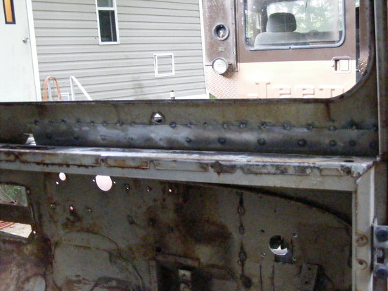

Well made a gruesome discovery today.....it would appear that some hack of a government employee halfway scabbed factory replacement floor pans in with pop-rivits...allowing dirt and water to get in between the two pieces and basicly well rust out everything from the topside...thanks a-hole government postal vehicle service person.....so lookin like I'll be fashioning a not so radical subframe out of 1x2 10guage tube...on the bright side I have one usable 16guage floor pan, and a usable template for the other...being as the original brake pedal went straight thru the floor and well it drove around with driver's door open all the time the second pan on driver's side was also rusted...(this was what I thought was my only floor rust)....I'll have pics of this later today or tomorrow...well at least of the damage...be a quick minute till I get it fixed...

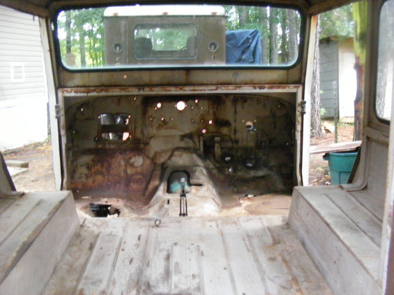

post #247 of 995 Old 08-06-2013, 10:51 AM Thread Starter
freaknajeep
1971 DJ
Location: Tupelo

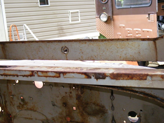

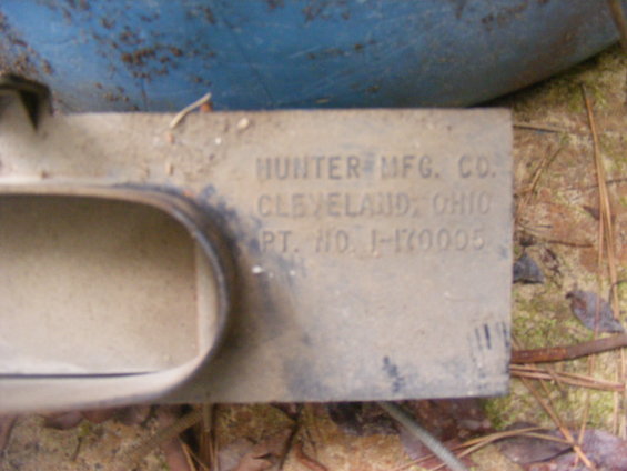

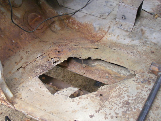

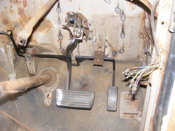

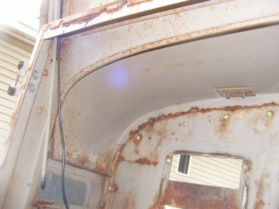

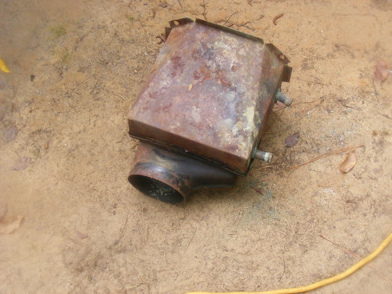

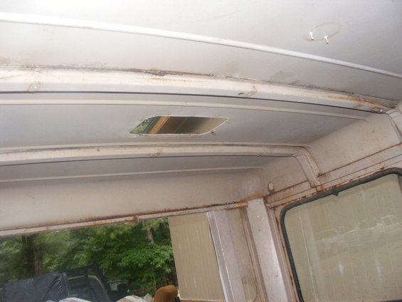

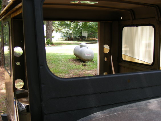

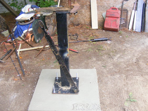

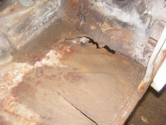

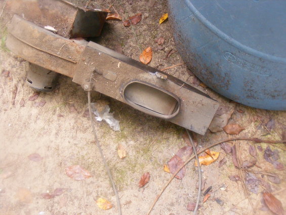

Posts: 937

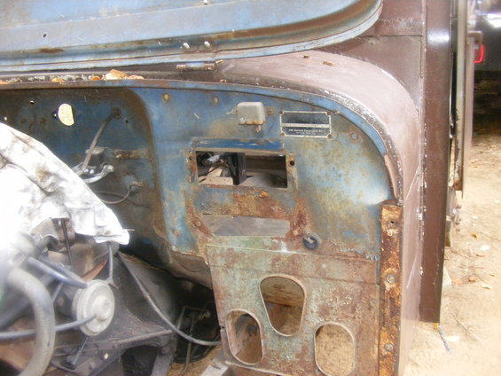

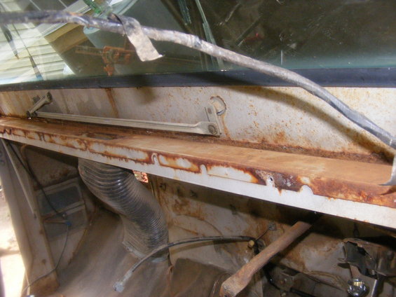

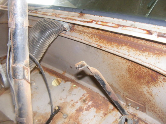

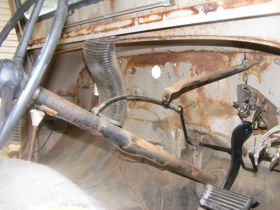

well as promised its pic time again.....now i must warn you some of these pics are of a heinous and graphic nature and may cause distress even hysteria in those persons weak of heart and fab skills...lol
ok enuff babbling already on to the pics....

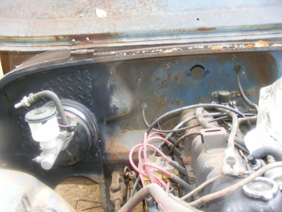

inside of cowl/firewall after removing dash and all wiring...you can see the surface rust and some spots at the cowl corners where there is daylight showing thru....
a better pic of pedals and modified linkage...
outside of firewall/cowl...
some yummy pics of heater box assembly and core...

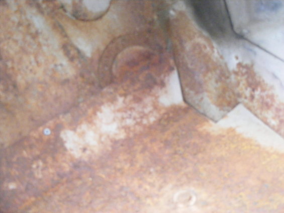

and now for the cancer pics...and other sheet metal carnage...

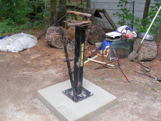

nice new pad for bender...
well once again we have reached the end of our post....will have pics of the drivers side cancer soon...it was totally depressing to see what i found on passenger side so i just couldnt bring myself to dig any further at the time....stay tuned blah blah blah....

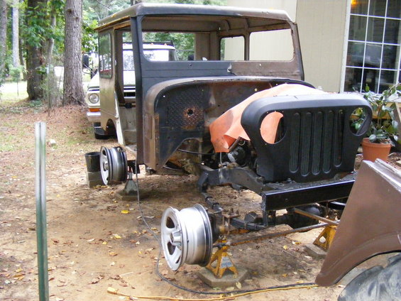

post #250 of 995 Old 08-06-2013, 05:37 PM Thread Starter
freaknajeep
1971 DJ
Location: Tupelo
Posts: 937

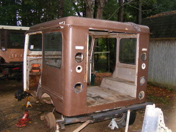

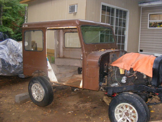

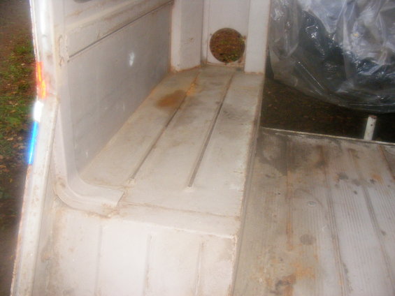

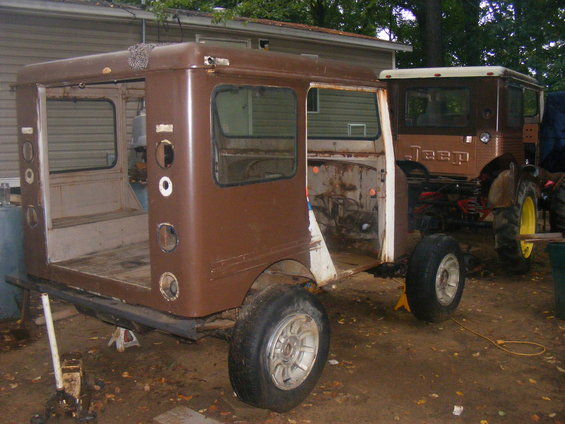

ok so on to todays progress...

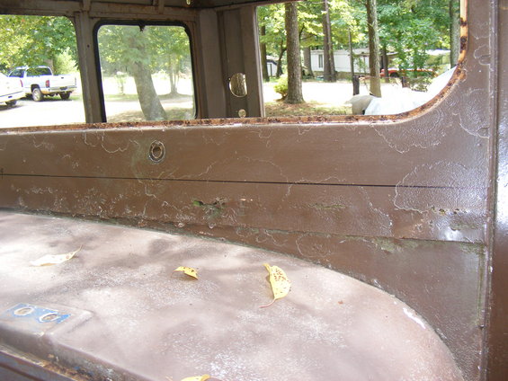

interior after full strip...well the ebrake handle will come out after i flip the body up on its back....
theres paint under that grime....
exterior shots...
after hanging the rear tire n rim i can plainly see ill need to work a little more on the bastard packs for the rear and or just add about a 1.5" block...just really dont want blocks and it will be easy as pie to re-disassemble after body is off...well looks like it quit raining again...ive been working like a madman between the thunder storms...lol...self washing build...haha

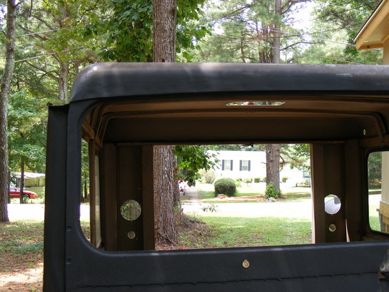

Well I noticed something nifty about front windshield gasket...it is a two price basicly the main gasket then a small piece that pops into a channel to lock it in...and it was nice and supple...so popped out front glass and noticed that someone took a torch and cut a decent sized hole in the left a-pillar in order to install some jank antenna....I'm beginning to understand why they say never buy a used jeep...there is no such thing as stock once it leaves the showroom floor....lol

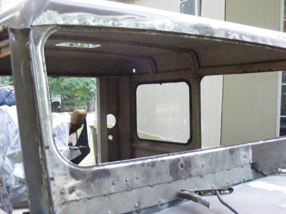

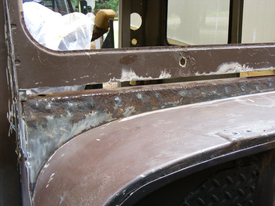

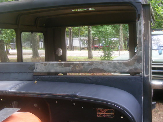

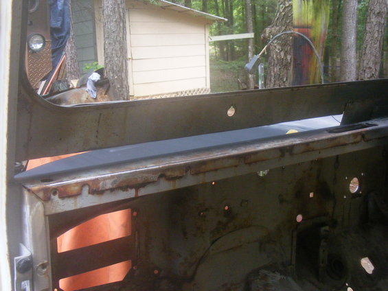

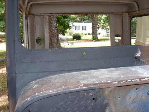

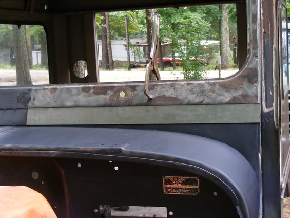

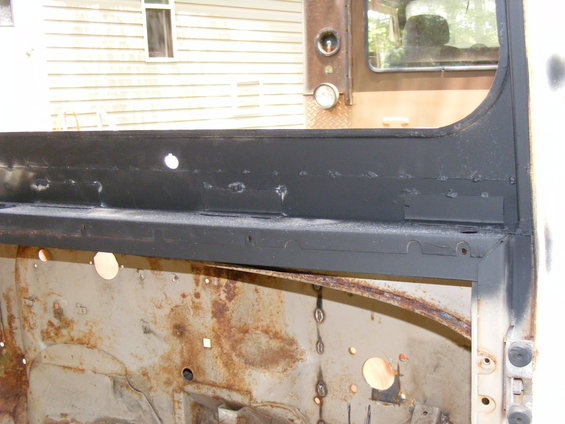

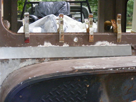

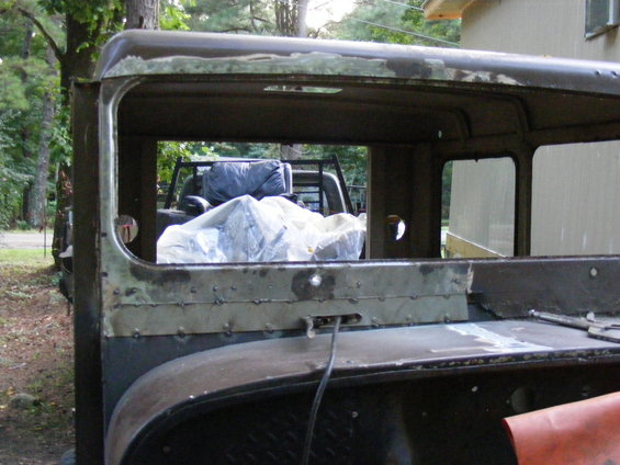

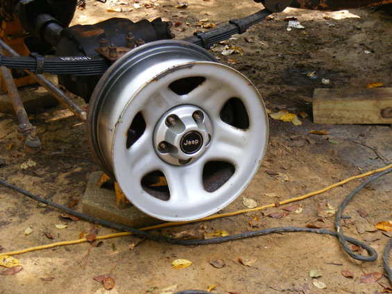

ok update time...so todays update deals with the cancer at base of my windshield frame..i did not butt weld this for two reasons...1st off being as area was pitted pretty heavily and i needed to insure strength...second sometime in the near future i will procure a cj windshield frame and hinges and make the hard top removable(you know like a jeep)..plus nice flat area i figured if 1/8" of filler is considered acceptable for high dollar collectible cars why not my daily driver..ok so on to pics.....
we will start with a few shots of rims...lol
ok so on to windshield frame cancer....as i was battling the t-storms i did this in two stages...i started with the right side(drivers side)basicly drew a cut line where i had good metal...chopped, pieced,and welded...i let the pics tell the story....
some small l braces for extra strength...
passenger side...
well i did manage to just barely get a protective coat of paint on the passenger side before the rain started again....next ill get the hole in the a=pillar patched up the ill flip body up on its rear and start on floors...hope you enjoyed this...im in sheet metal h--l...uuugh...stay tuned more to come...lol
