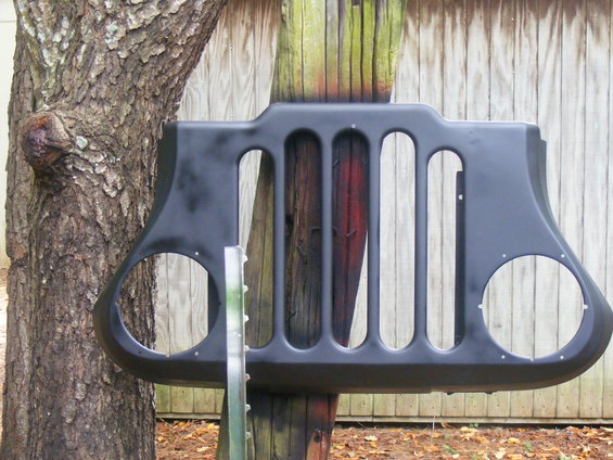

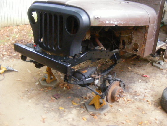

ok so started on the facelift today before my angle grinder decided to die....so ill post what pics i managed to get..
so after sanding grill down i found a couple of cracks...
well some how i got 6 pics of the same crack...but there was one more it was about the same size...
after welding...
inside of grill after cleaning and a coat of rust reformer...
front of grill after coat of rust reformer.....

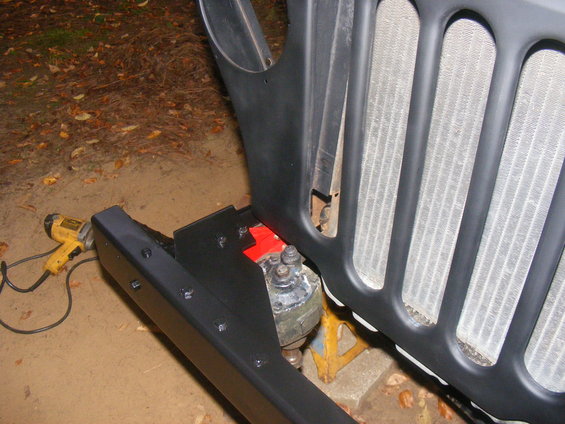

freshly painted bumper braces..
steering box remounted and a glimpse of mounting bracket painted red....also same cast piece on other side....
just a pic of it all back together for now....

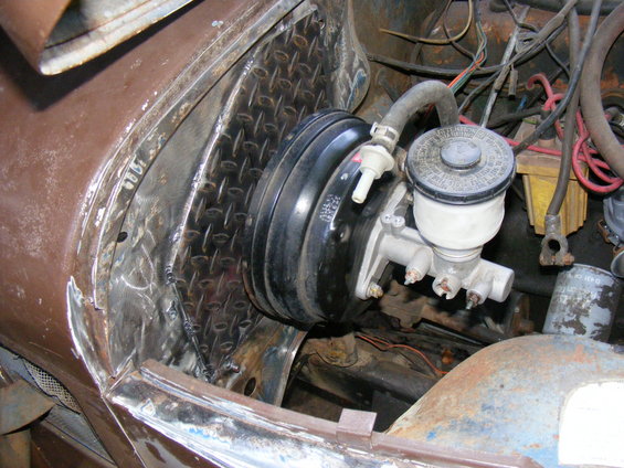

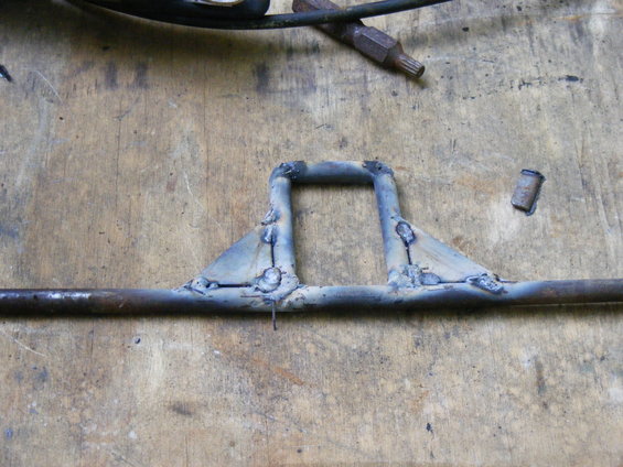

So got a bunch of things accomplished today....got the tie(wheel to wheel) bar made...still got to set initial alignment...got battery tray removed and firewall strengthend and m/c booster in as well as brake pedal and modifyed the accelerator linkage...so like I'm tired ...will post pics tomorrow...lol

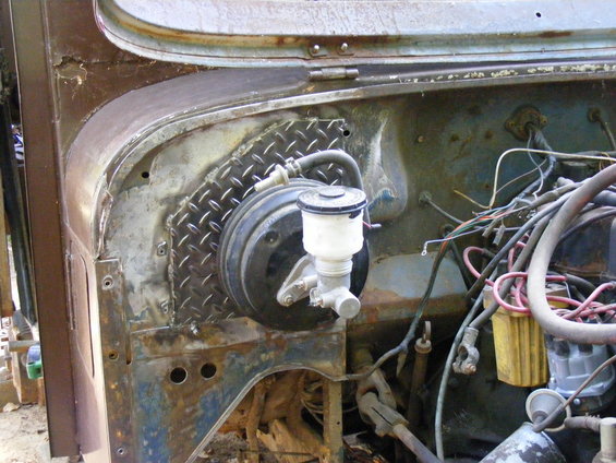

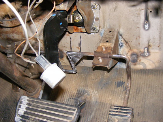

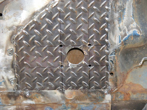

ok so on to the next pic filled update....basicly pics from stuff i talked about in last post....

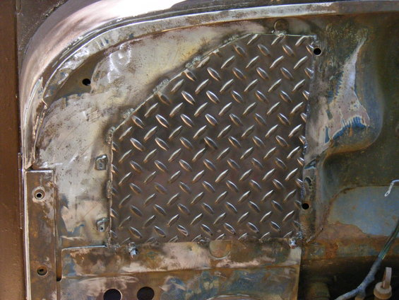

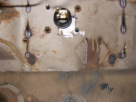

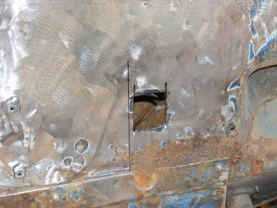

so here we go...firewall after i removed battery tray...
battery tray...lol
after initial grinding/sanding...
the black line represents approx where the first wo holes will be drilled...the darkish circle is come wierd indentation/outgrowth im guessing they used to take the tincan sound out of firewall(i.e. tighten up the sheetmetal)....
i didnt like how the firewall flexed when i put pressure on it so after cutting out the wierd section i plated a large area of it with 1/8" diamond plate..just some scrap i had laying around so its not super pretty but net end result was great...
weirdness removed...
diamond plating...
after some hole sawing and drilling...
test fit...like a glove baby...like a glove...

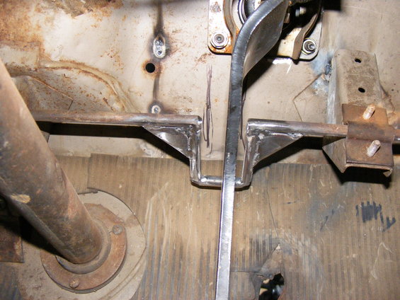

inside after removing existing accelerator linkage mounts...(that was a mistake)
pedal assembly...was going to use the gas pedal as well but realized how much extra work/crap to find etc that was going to cause...reason for this is brake pedal was going to hit original accelerator linkage...
after removing gas pedal...
modifying original linkage...
test function/fit after welding mounts back in...lol....
clears brake pedal and works nicely...
clearance and ease of servicability in relation to factory fender with no trimming...
linkage after a coat of paint and i changed out the pedal pad area as well for the matching pedal and pad to brake pedal

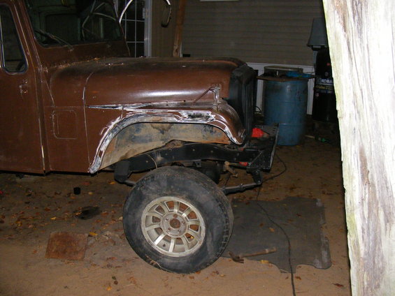

rim and a 225/70/r15 on with full weight on springs...i think a set of 30-31" tires will be perfect....
