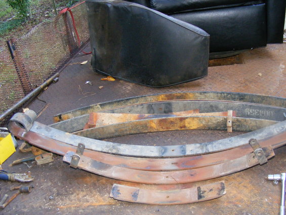

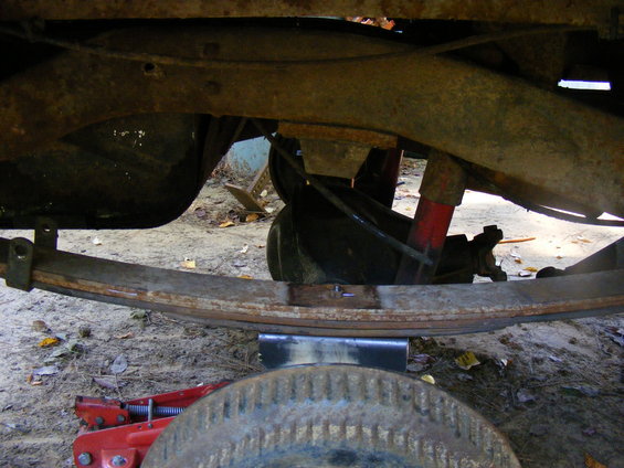

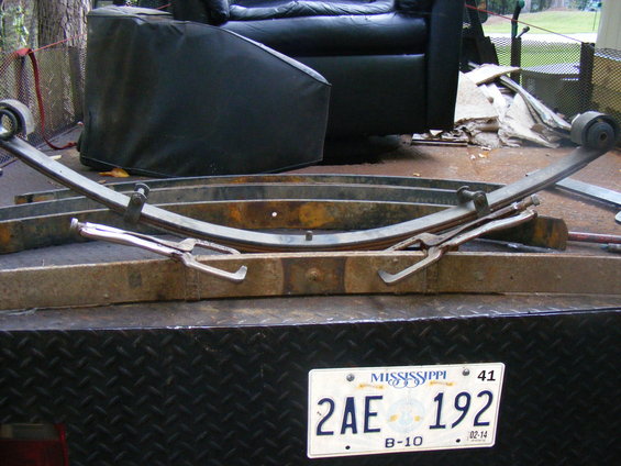

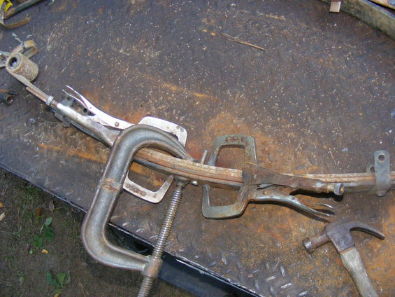

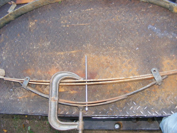

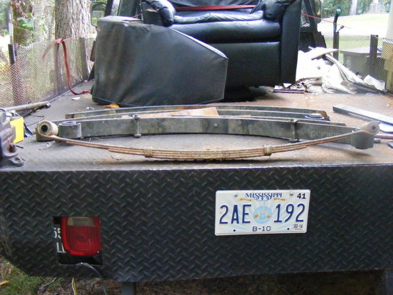

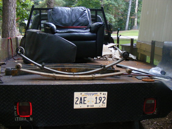

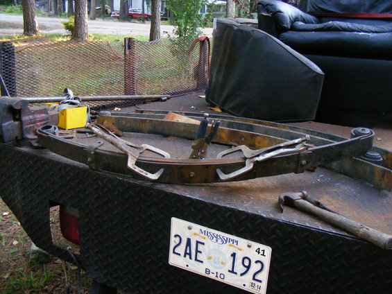

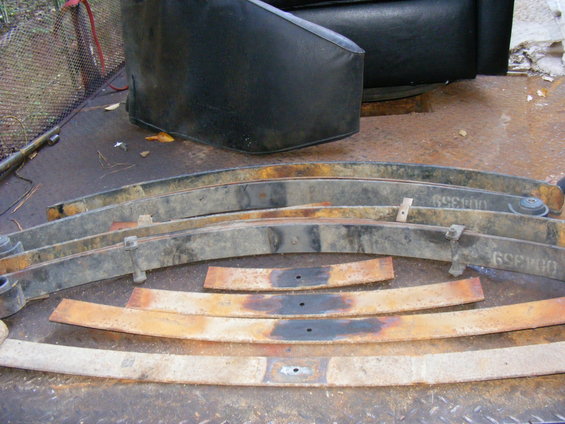

ok well heres a lesson on springology...i.e. "Bastard Pack" 101...idea is simple take multiple junk leaf spring packs, disassemble, mix and match leaves till desired result is achieved...
ok so on to pics....
before with 3" block, and stock spring....notice how flat spring is...also how close to frame/bumpstop..
springs removed..im only gonna show pics of doing one spring...as other side is just exactly the same...
the donor springs i chose to use...also have some single long leafs as well
comparison original verses donor...
you want to make sure to clamp all the leaves together before removing the spring pack bolt/pin
the 2 packs after disassembly...
original...
donor...
i decided to just replace the two short leaves...the two nasty one(top) are from the original pack the two slightly less nasty ones(bottom) are from the donor spring...
all lined up i used a 12" long 1/4" extension and then a large c-clamp to compress the pack....
once i got it mostly compressed i tapped the extension with a hammer till it moved freely in the spring alignment holes..then i used two weld clamps to add extra compression while i bolted it together...
the newly reassembled pack...
and finally after reinstallation....notice the nice arch and distance from frame...and no block...lol...
well thats about it for this post...i hope this provides usefull to someone else...i think it was a nice improvement for $20 cash and 45 minutes a side ....stay tuned for more jeep fun...lol
