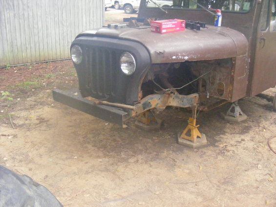

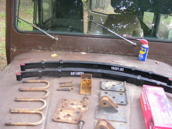

ok so a quick pic update....
parts...
awaiting axles...
front bumper cut down fenders removed getting ready for facelift...
also got some of the fab work done on spring mounting locations on front...should have pics on that tomorrow...

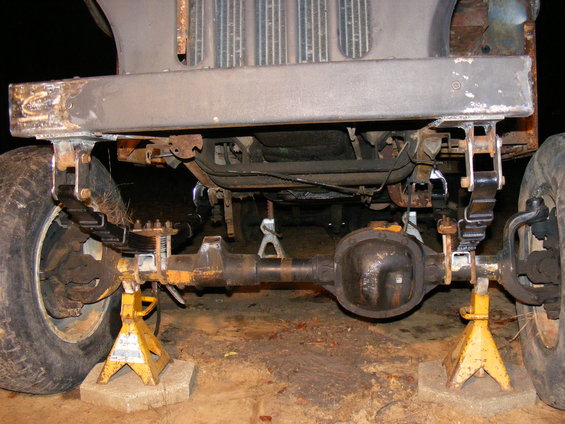

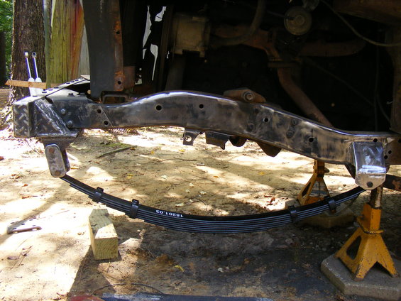

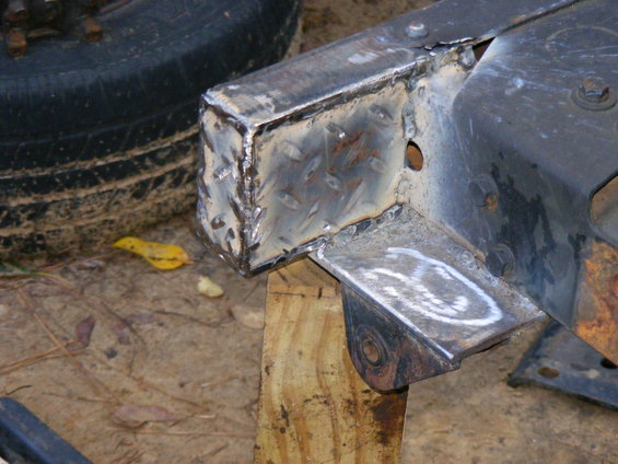

ok so time for a fun pic filled update of todays activities....wooohooo!!!!!!
ok we will start with a pic of "Poor Boy Fab Shop"
now for the before spring hanger relocation pics..front hangers have already removed for relocation....
front
rear

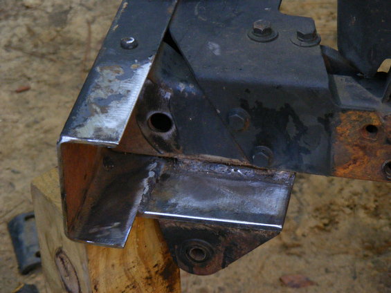

ok on to the fab pics...
i have step by step pics on the mounts if anyone would like them...and now for pics of the axle installed...i figured no need for step pics here its pretty self explanatory...i.e...i bolted it together loosely made sure spring perches were the same distance from the knuckles..set pinion angle to where i liked it and welded up the new perches...well on to the pics...

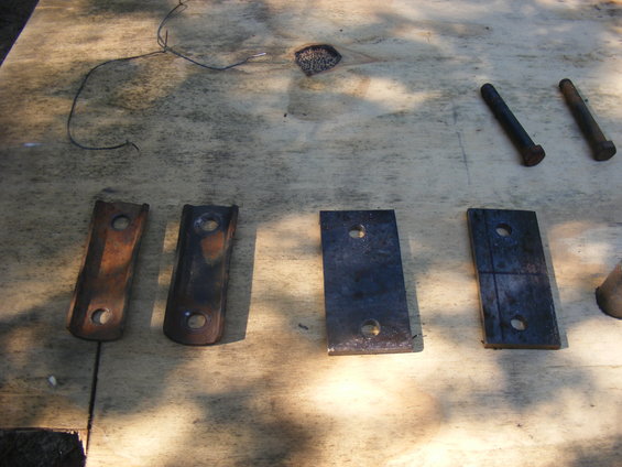

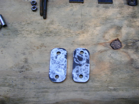

a couple of pics of new shackle pieces...
old ones and the new pieces after drilling...the originals were 1/8" thick 1-3/8" wide and 4" long....new ones are 1/4"x2"x4"....should be much stronger...lol

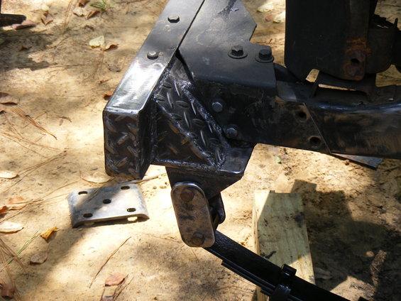

finished product...lol.....
well thats it for today....i guess i got a little accomplished today....everything still needs a little clean up and primer and paint...gonna get the rear in tomorow...well nite yall
