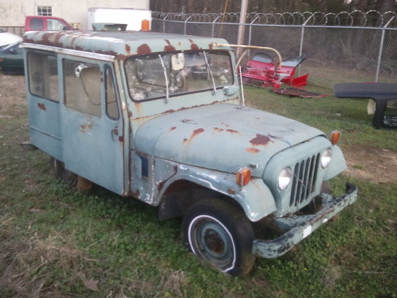

"Special Delivery" a '71 DJ5-B...
So since i pretty much finished up the xj project
and i decided sure it looks bad to the bone but didnt like the ride...i picked up this lil jewel for cheep
so here goes...lots of pics for now most should be pretty self explanatory but i will do a little narration

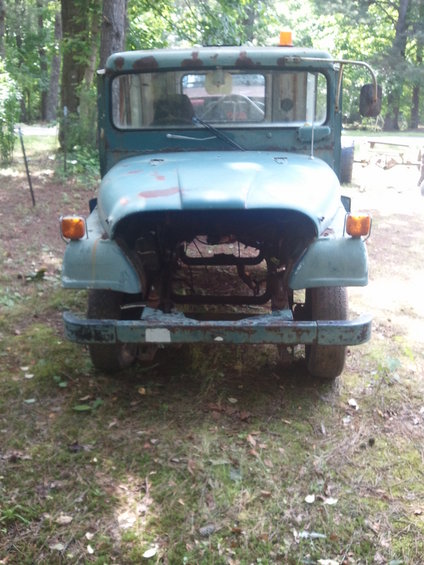

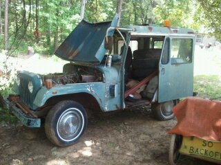

donor parts
bye- bye drive train
bye-bye suspension
haha drag jeep...lol

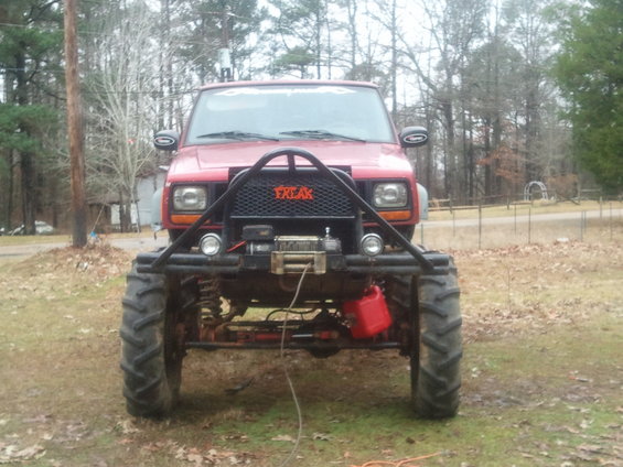

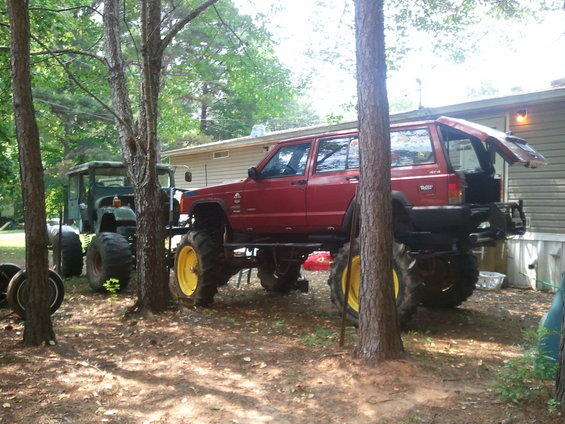

just a pic of the xj and mail jeep kisssin

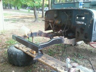

so now on to real work

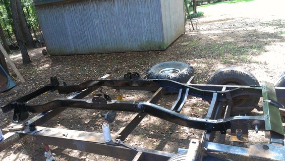

11gauge inch and 1/2 square tube subframe for tub/body
grill moved up to bumper
axle housings cleaned and painted
frame mostly finished
still have to make permanent rear upper spring buckets since i wont know exactly where the need to be untill i have drivetrain and body back on...

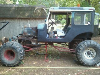

No the mock up was right at 120" i have a final wheel base of 110"...suspension minus shocks and front knuckles is finished...body is still sitting on my 72 1ton ford flat bed...im cosidering sending my front housing off to that guy in michigan for the d44-50 hybrid conversion...supposed to strong as a 60 but keeping the ground clearance

ok so a few more pics...lol

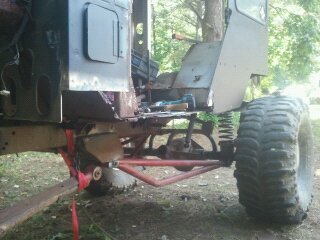

frame again...
front arms...
rear suspension
the front joints are currie "johnny joints" at frame and procomp polly at axle...where as the rears are all "johnny joints"
I fabbed th rear suspension about 3 years ago and had it under a 93xj till i basicly destroyed the truck...lol...and i know how extreme it flexes but i am unsure of my front hard to tell with no weight on frame...well thats all for now check back in a day or two for more exciting lack of progress...lmao

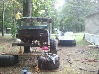

ok so finally got the body off of the back of my flatbed...and on the trailer and moved around to where the "outdoor shadetree fabshop" is lol...started hacking away at some stuff the PO had scabbed in there to i guess hold it togethr...lol what a mess...tomorrow i go to get some steel and will finish up fabbing the subframe...as well as im going to start relieving the XJ of its drivetrain front shafts/lockouts and recovery gear....hopefully i will have the motor and trans combo grafted in by friday and ready to start getting body back on...will have more pics tomorrow as well

AngryTJ
Posts: 4,468
That suspension and those control arms are very interesting. Have you done a jeep like that with the frame mounts all the way to the center of the frame?
Yes but it was on a xj and i didnt strengthen the unibody enough first..it lived for about a year before i ripped it in half...lol...but it flexed like u wouldnt believe the whole time...
I plan on doing an endo/exo cage so basicaly a buggy with a jeep body fused in the middle

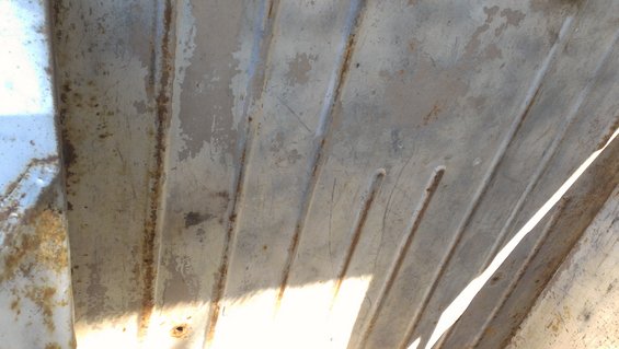

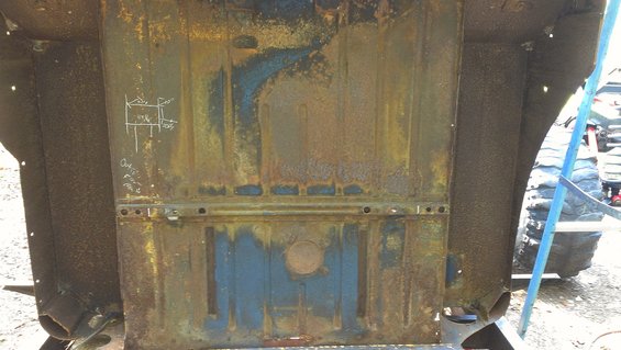

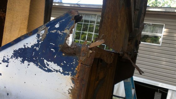

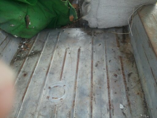

just a pic so others with rusty jeeps can feel my pain...lol also you can see where i startd hacking away at the midsection.
underside of rear floor...some surface rust soon to be delt with
top side of rear floor

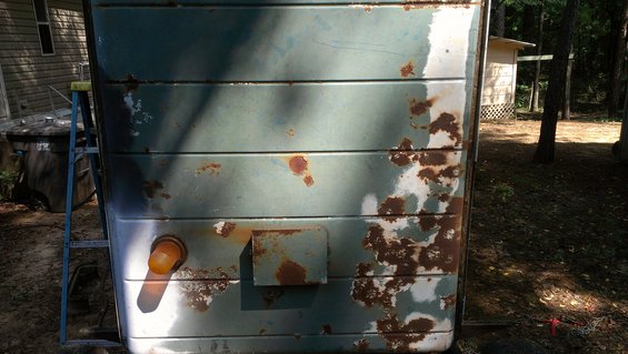

roof...also a little surface rust soon to be delt with...and new guts and guard for the strobe and the vent in middle will be the snorkle vent
