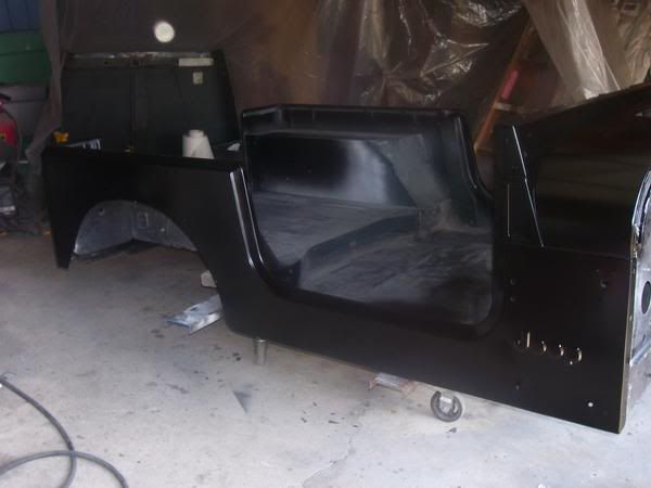

Then in late may of 2007 I began the surgery on my jeep.
I have to find all of my pics from the build.

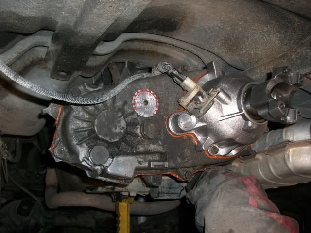

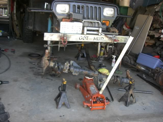

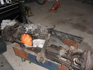

Ford 8.8 with 4.10, along with Np231 t-case with sye, front Cherokee shaft, and a 4.10 ratio D30 for my friends 94 wrangler.

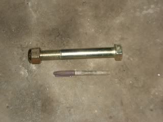

Shaft for my rear tire carier which is getting reworked since I have bent the old shaft . 1" by 8" long grade 8 bolt. $10

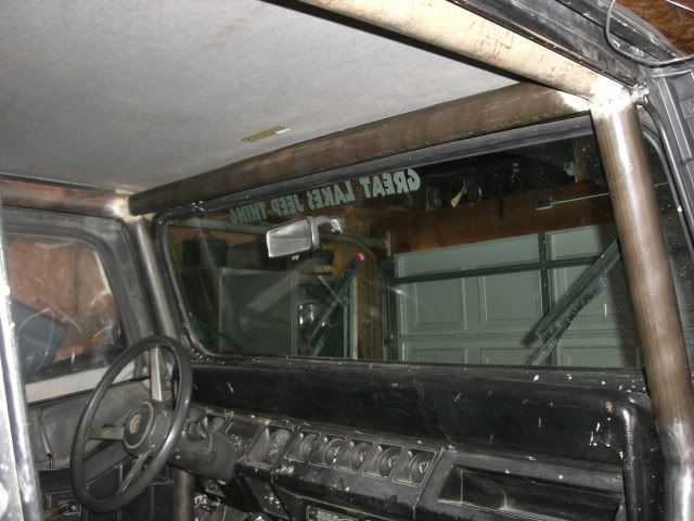

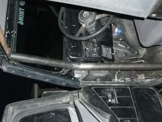

Doing a little work on fitting in the roll cage. 2.125 dom tubing

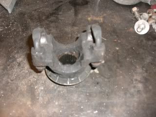

Grabbed a yoke of a 90's full size bronco yesterday along with a one piece Cherokee shaft with bigger u-joints out of a 95 for my friends 94 yj the other day. I want to see if i can swap the bracket style ford 8.8 yoke with this yoke. axle shaft was $26 and yoke was a freebie.

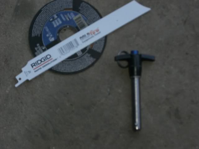

I also got my quick release pin for my tire carrier project today and picked up a few things from the depot.
The qucik pin was 18.88 from www.swracecars.com/ plus another $10 shipping. It is a 1/2" diameter pin by 2.5" grip length

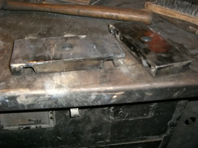

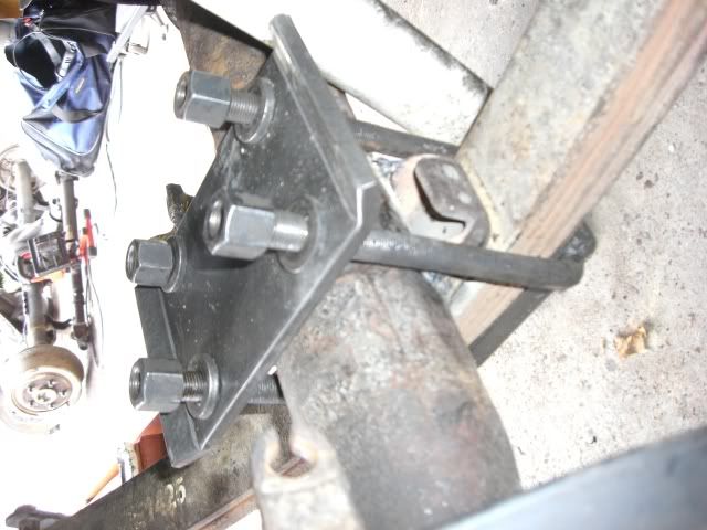

Last thing I began tonight was a chamfuring some of the parts for the 8.8 u-bolt flip brackets.
There is a bit of a mock up to show you what they will look like.

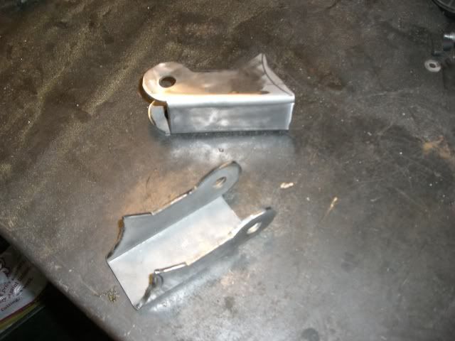

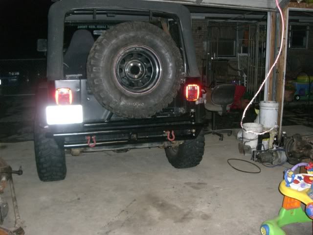

Last night at work I got the shock mounts made for the 8.8 swap. Just have to grind in the radius on the top when i know the final mounting position.
Got the reworked tire carrier back on my jeep.
Started welding together some of the parts w for the 8.8 u-bolt flip

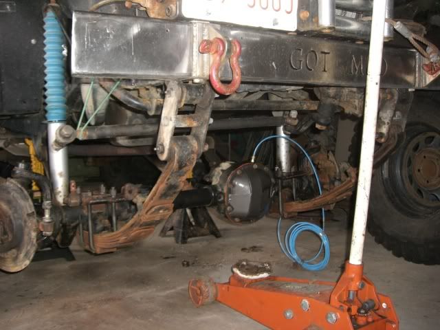

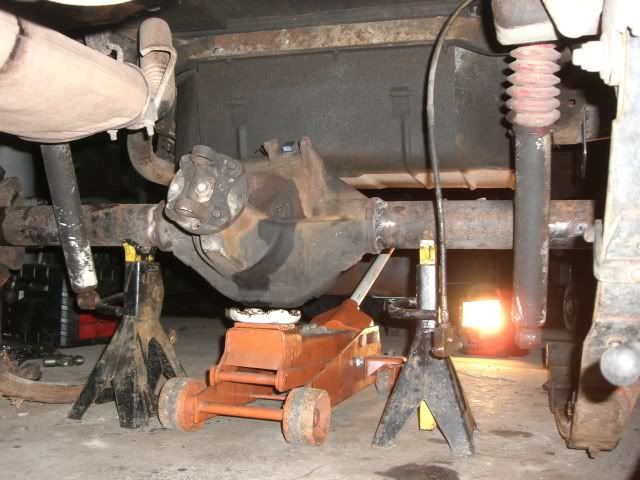

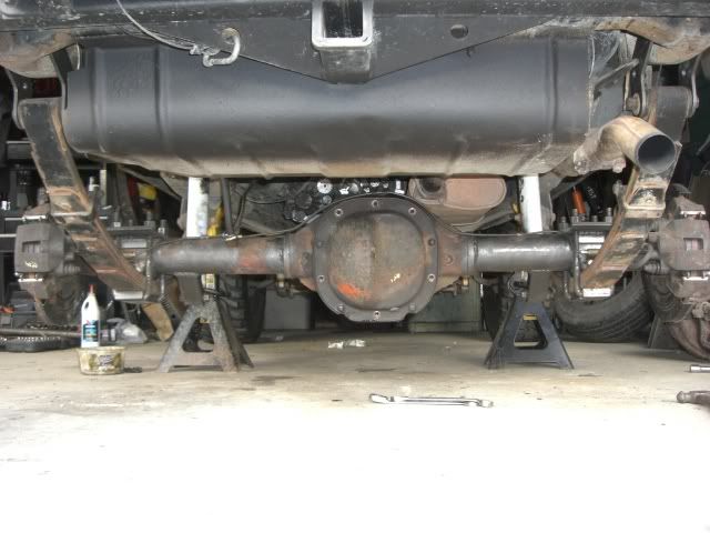

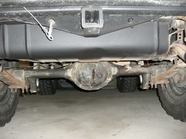

Well this was a busy weekend. Started out late Friday night on the ford 8.8 swap into my friends 94 yj. We worked on it from about 9pm till 5am then woke up around 10 went to a few stores and pretty much finished it up within 24 hours. Just have to get the Cherokee drive shaft cut to size which we sent off to Chicago driveline today to get shortened. All in all not any problems along the way and seems to be working out just fine.
Old axle

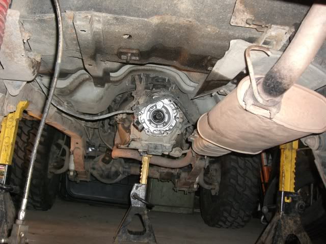

Took out the 242 t-case he had in there form when his 231 took a dump a while back to make room for a new 231 with and sye that we had put in earlier.
new case
8.8
u-bolt flip
just about done
Burgers for dinner. Those were good after a full day off work

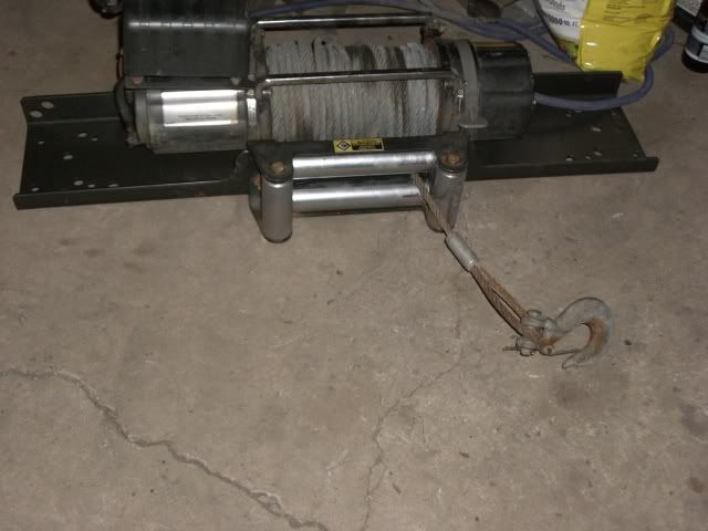

so after the long couple of days got to work on my stuff for a few minutes. I cleaned up the rollers on my winch fair lead and painted them. I don't expect the paint to last as soon as winch the first thing it'll probably come all off but just to make it look nice for at least a few weeks.

5-134x 1310 to 1330 conversion u-joint. Used in my 8.8 swap so that i could use my 1310 cv driveshaft with the stock ford explorer flange.

Tuesday night I painted up the winch plate and installed put it back on Wednesday night. I also got a bit more coping done on the roll cage tubes on Wednesday.
Friday got a few more roll cage tubes tacked into place.

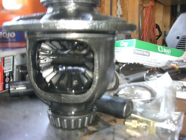

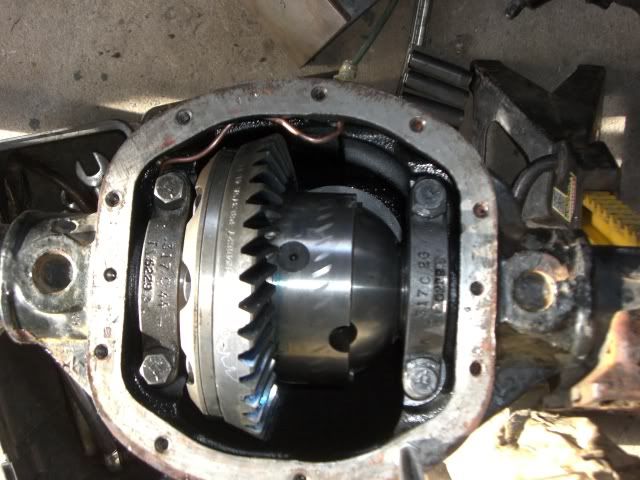

Saturday I started to install my arb in the 30. Installation went pretty good. Just followed instructions and ended up with a good teeth contact pattern on the gears.
Arb in.
Old carrier
Done for the night
Prussian Blue Part # 80038 at carquest $5 (gear marking compound)
Not as nice as the yellow stuff but still gets the job done.

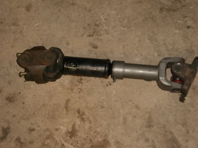

Also my friend got his Cherokke front DS shortened for $80 form Chicago Driveline in Chicago Ridge IL
Note* the technican said there should be about 1 inch in the slip joint when sitting in the vehicle.
