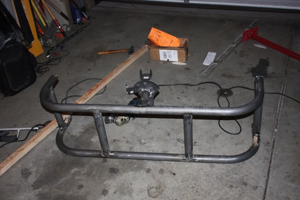

You know this weld is going to fail surely? there is approximately 90lbs of oscillating mass applying a moment to that weld. The weld will age harden and fail but at least your design won't drop the wheel. Just a word of caution.

A buddy and I were talking about it. He was a welder for a big commercial company here in Ca. before he started his own electrical business. He was saying that there would be signs before it would fail. After cutting out the side bars, I wish I would have put 3 in the middle, and used a gusset to support the tire carrier. I wont be redoing it any time soon... Thanks for the heads up!!!
