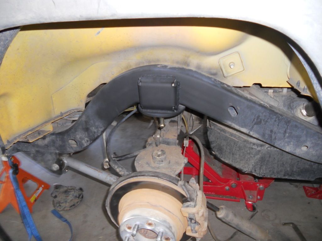

yeah, Full Traction "3 link upper"… I don't hate it, but this solidifies that my next step will be triangulated 4 link!!!
Annnnndddd…
How do you like these? I have a pair laying around and have wondered why I didnt just re weld the stockers back in place.
Also, Why didnt you weld the upper corner edges of them?

These worked well. I don't know if I really notice any difference. I wouldn't have been able to re-use my stockers since I cut them up to get them off... It was just easier for me.
You know, I noticed after I took the pics that I never welded the corners... It was just an oversight... But I haven't had any issues.

Ya, it shouldnt hurt anything just something I noticed
