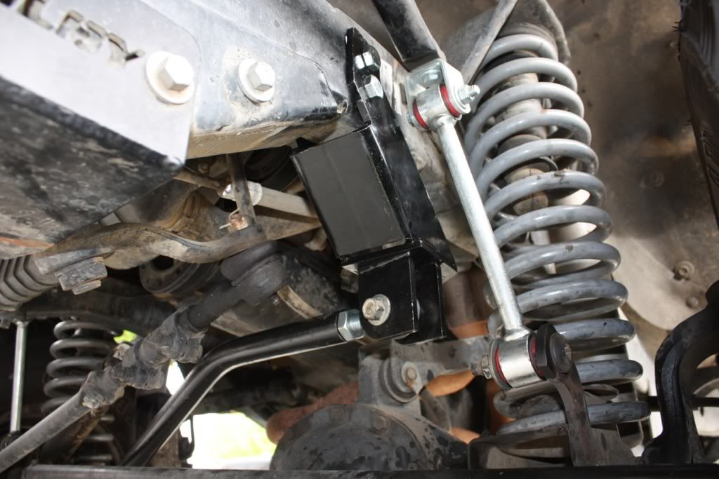

Is that the Rock Krawler track bar/bracket?
Be careful with that, here's what happened to mine:

Yes, and HOLEY CRAP!!!!! Any idea how it happened??? Did you call rock krawler???
edit: Just went back over your thread, I didn't remember seeing that before… I probably would have gone a different direction!!!

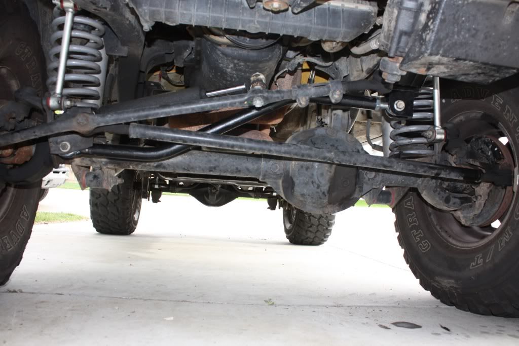

Still waiting on the bushing tool, but got the spacers for the track bar.
Doesn't look like they improved on the design much from the pics that Third posted, I'm hoping it was defective welds… I thought about bracing it, and may go back and put something on the corner, but most likely will get a weld on bracket.
and my original pic, for comparison…
