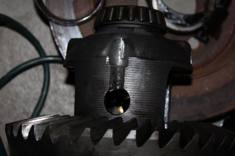

So, today was going to be the simple task of removing the brakes and brackets from the rear… After pounding off the brakes, stuck on the e-brakes, I broke off the bolt holding the cross pin in the carrier… YAY……… and the project comes to a screeching halt. I'm half tempted to cut it out and just go with a trutrac… but I was excited to see how the traclok worked. I have seen removal kits for like $30, but I've read mixed reviews about them working… sooooooooo...

Well, I got through it…
I went to the store and got a long drill bit and an easy out. An hour of drilling and easy outing and I got it to turn one revolution, then it wouldn't budge!!! I gave up on the L/S idea and decided to go with a full case locker…
A little bit of grinding, and viola… ok, it still took me a while to get it out! But I won!!!!

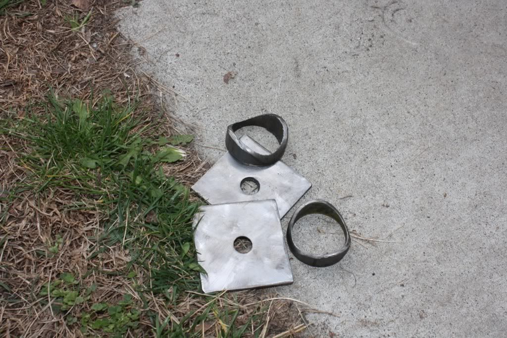

On a break from the rear, so I thought I'd try to make a mount for the high lift… pretty simple, big bolts, some scrap from the notcher and a couple plates cut from my 2x4x.188 square tube…
Now just got to weld the notched pieces to the base plate, paint and coat with some rubber.

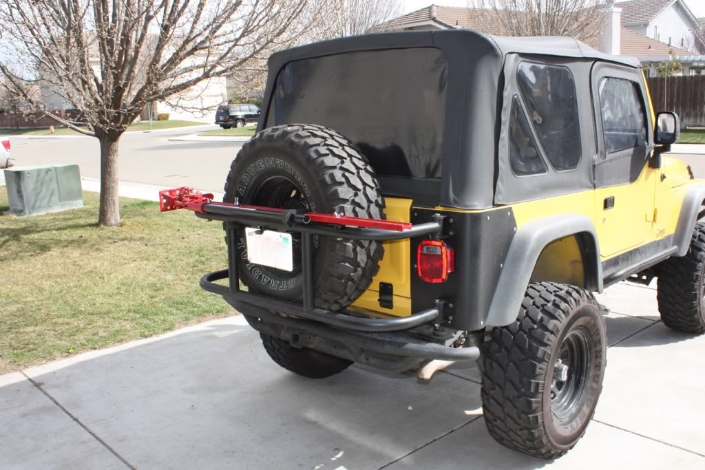

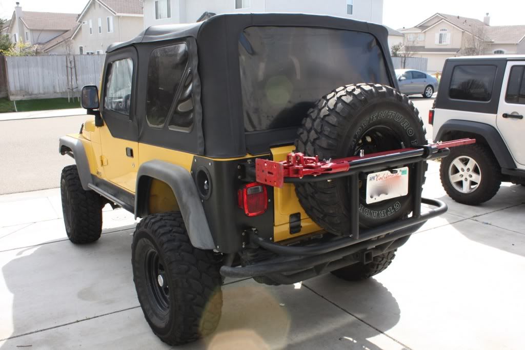

Hi-Lift done, for all intents and purposes… I may go back and cut the heads off the bolts and weld them in, but not for a while. I used a locking hitch pin to secure it. I was gonna us it on one of the ends, but it didn't provided enough clamping force to keep it from rattling.
