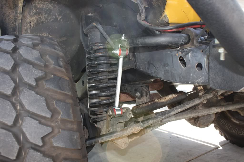

OK, so first thing is first, getting rid of all that body roll without having my front sway bar attached…
I never understood the ball joint idea at this link…

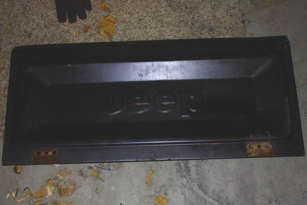

I have most of the parts to swap in my CJ tailgate, and build my tire carrier, so I figured why not. I started with this…

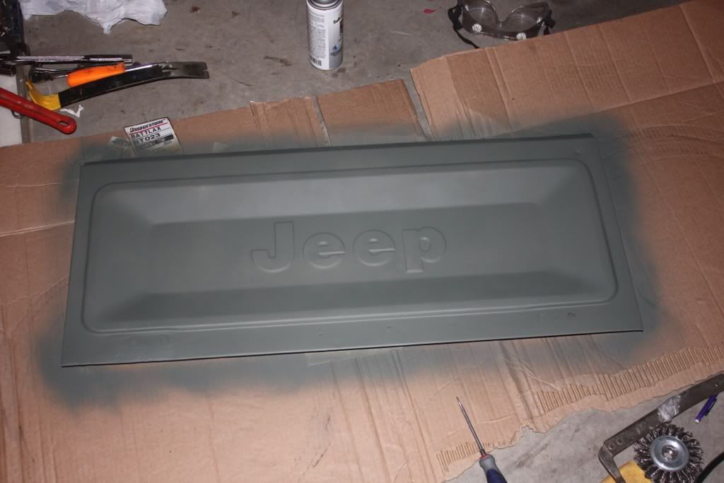

I had sanded it down previously to check the real damage, and it wasn't horrible, so today, I cut out some rot, welded in a piece of angle where the hinge plate bolts to it, and rosette welded it in for strength. I treated the rust then put the first coat of etch primer on it. I have a few spots to clean up with filler, but it won't be bad.
Don't know when I'm gonna get more time to finish this, hopefully next week… I hate starting something and not have the time to finish it, but I was dieting to do something!!!

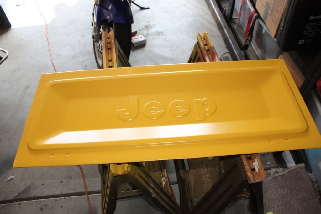

Thanks Jim!!! So the first coat went on real well, so I think I got a little over zealous and didn't wait long enough or used too much thinner on the second coat, that I started to get runs. So I have a lot of clean up to take care of… I'm not too concerned, it's just the tailgate, right???

Looks good from here Bill! Body shop friend of mine says a razor blade is the way to get rid of the runs.
