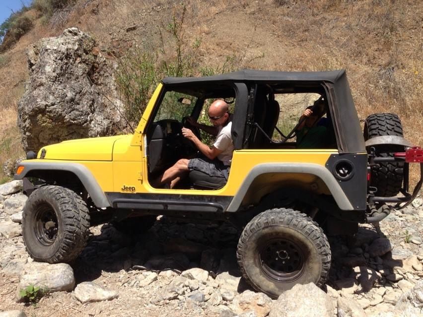

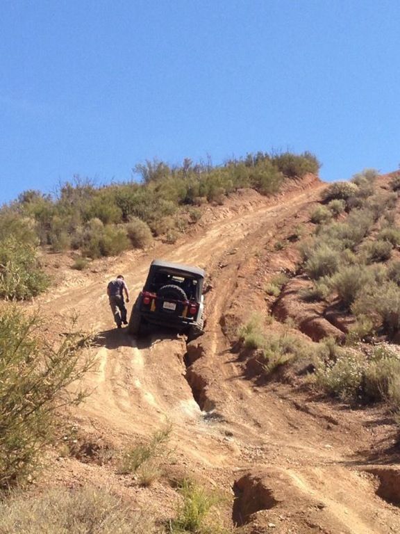

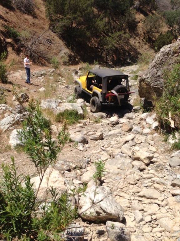

Went to Frank Reins Park in Patterson today… Lead the group… big mistake, I got stuck a couple times… I hate picking lines!!! I tried to idle up this and started to slip, so as I backed down, I slipped into the rut… it tore off my muffler… the first casualty of the day...
When I got stuck this time, I backed into that bolder…

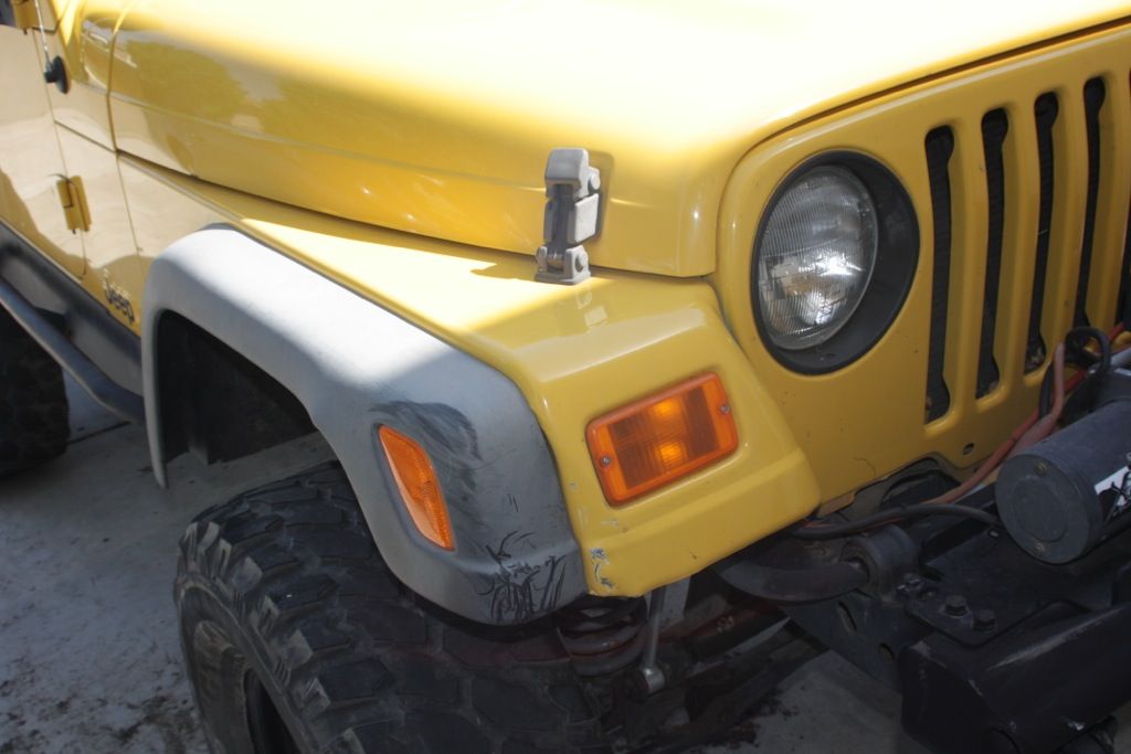

And sometime during my adventures, I did this… it was folded under a bit more, but I pulled on it and viola, good as new!!!

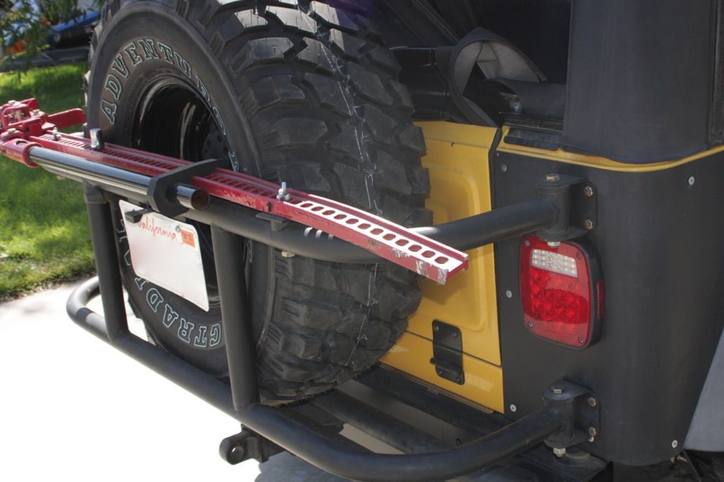

Nice pictures Bill. You must have some good bolts holding that highlift on for them to not break and bend it like that! The rack must be mounted solid too for it to not have tweeked that as well. Oh and I like the front bumper better after the cut job.

Yeah, Jim, I was thinking I shouldn't have used grade 8 bolts for the highlift... Hind site bein 20/20 and all... today I cut a bit of the tailpipe so it won't hang down as low anymore and I welded the muffler to the y-pipe/cat! It is a little louder now but it won't get hung up and fall off!!!
Oh, and I had a buddy point out, although the bumper looks better now, it would have taken the hit that squashed my fender! He also said that he has made tube fenders in the past (he is the guy who has the JD2 tube bender I used for the tire carrier), so that may be a project for this summer.
While I was under the jeep, I noticed the tranny skid got beat up real good, looks like there is a chip out of the tranny, although it may be old or normal... So I think I may be investing in more underside protection!!! My shock mounts hang down pretty low, so I may end up moving those too!

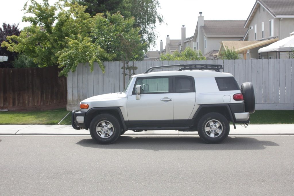

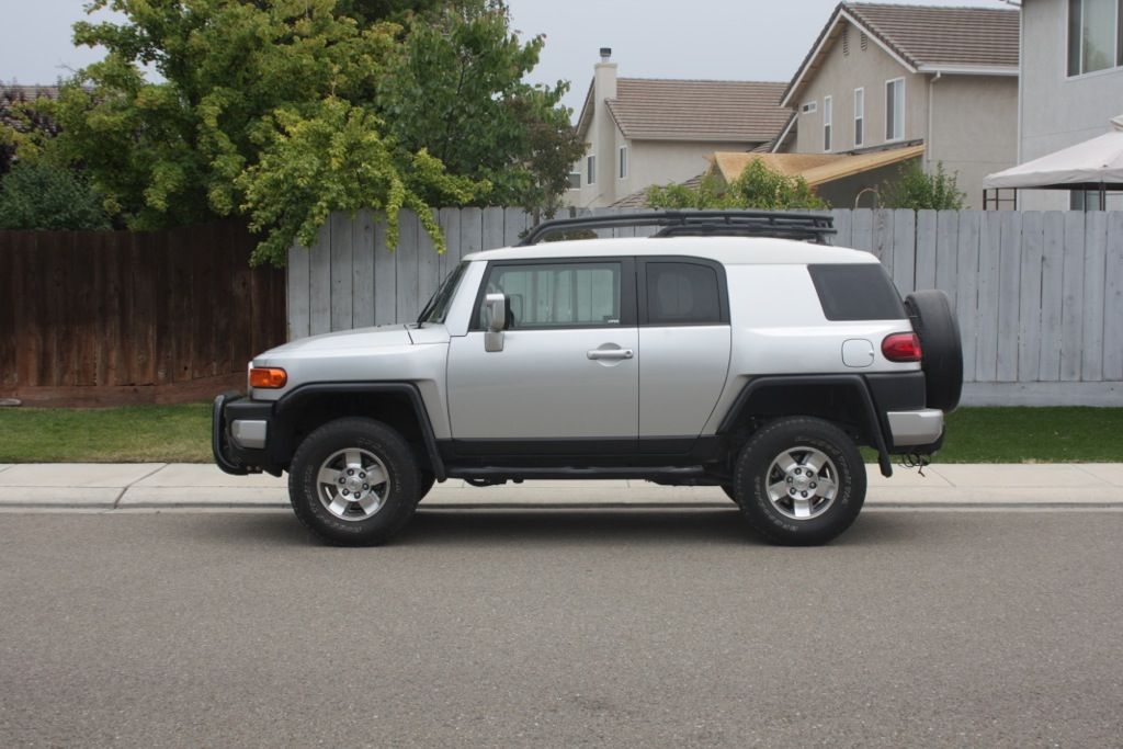

Also helped a friend with her FJ Cruiser today...
It rode pretty nice on the freeway after the lift!!!

Bill what's your friend think of the FJ? I like them and have thought that I might like to have one at some point.

She loves the fj!!! She is like one of us with our jeeps! She just put some bigger tires on it--285's... Now she wants to go wheelin. Anyway, I actually like driving it. Strong engine, nice tranny, tight steering! Only issue is the blind spots, but you can see fine if you use your mirrors and actually turn you head and look... . I don't like the rear door, a little tight getting in and out of the back. The JKU is much easier to get into, and the only issue I have with ours is power, buta really, it works just fine the way it is. It would be head and shoulders ahead of the FJ in every category if they put the diesel/8speed combo in it!!!

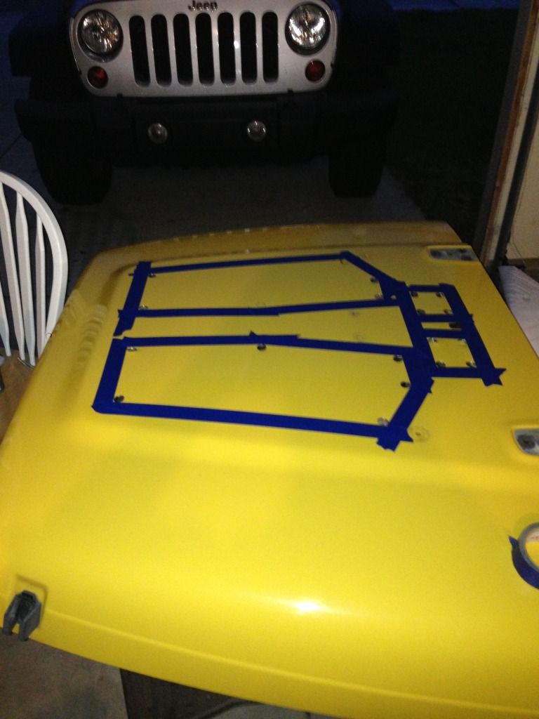

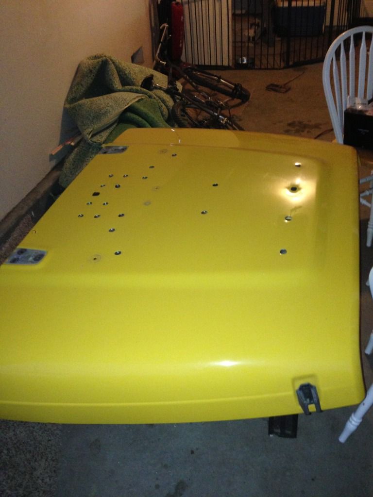

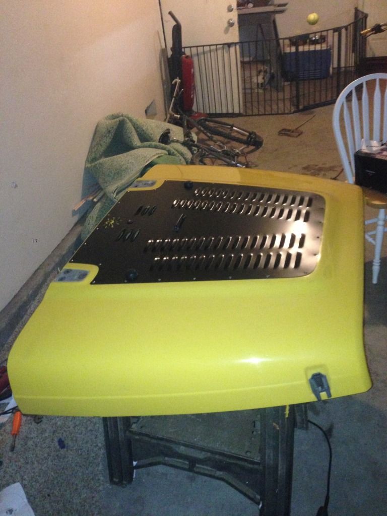

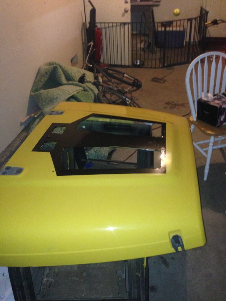

I couldn't wait, not to mention I did t want to wait because tomorrow is going to be over 100 degrees here, so I started on the Poison Spyder hood louver...
No turning back now...
I thought I'd use the tape for cutting guide...
That worked ok, I started with an angle grinder with a cut off wheel, but my round edged became square real quick when it got ahead of me. I tried a jig saw with a metal blade, but that was worse. I ended up going back to the angle grinder, but was more careful to cut slowly!!!
I had to go back over the cut edges with a flap disc! I painted the top and the bottom... Two reasons, to paint the no longer painted surface, and so the yellow wouldn't show through the louvers.
And here is the end product...
I'm done, it's dark, so no pics on the jeep, I'll get one tomorrow. I like it!

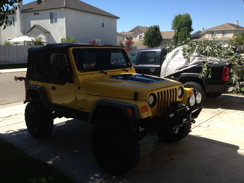

And here is a pic from this morning...
