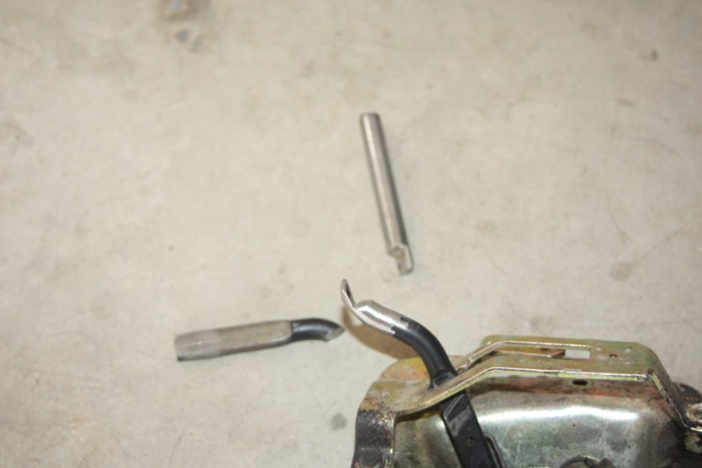

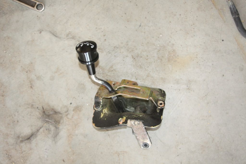

So anyway, I have been trying to think of a way to fix Jeep's wonderful way to shift the transfer case, since with the body lift I have a horrible clunk whenever the tranny wants to flex. I originally planned to make my own shifter like I have found on the internet, but that seemed too time intensive and too much fab work. So I have decided to go the route of the cable. I got a set of Shift knobs a while ago, but never did anything with the transfer case shifter since I didn't know where I was going, so today I started the modification…
Just a little cut,
Weld, and smooth...
And done...
I got to wait till tomorrow to put it in the Jeep, but I'm glad I got that done. Now I have to order the cable shifter.

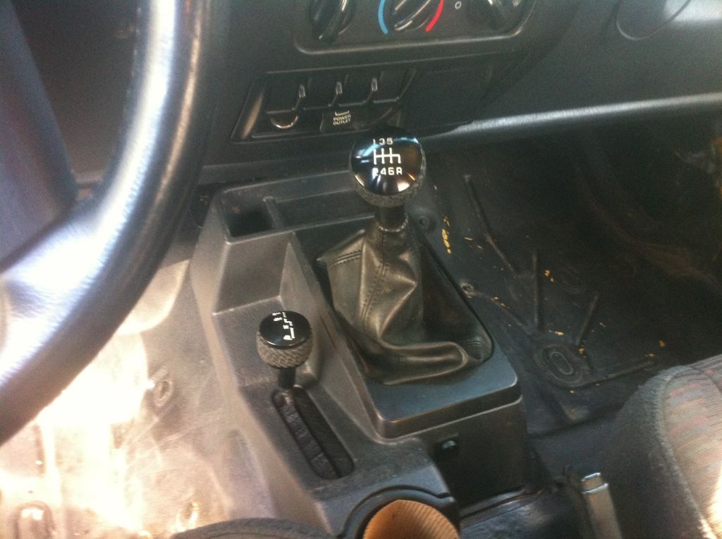

Well, threw the shifter together this morning, jumped in the jeep and ran to my parents house to pick up the kids, they spent the night so Jen and I could go to a banquet last night. Here is a quick pic...

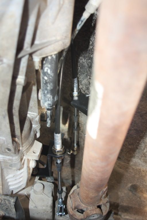

OK, It's done… didn't think I'd have time this weekend, after the 40 hours of overtime this week, but the wife took the boys to the park, and I got to spend about an hour putting it on. Easy, straight forward, I think I may have damaged the threads on one end of the cable, they are aluminum, but it seams snug… we will see. Anyway…
Before:
After:
Next step, steering… maybe in a month or so…

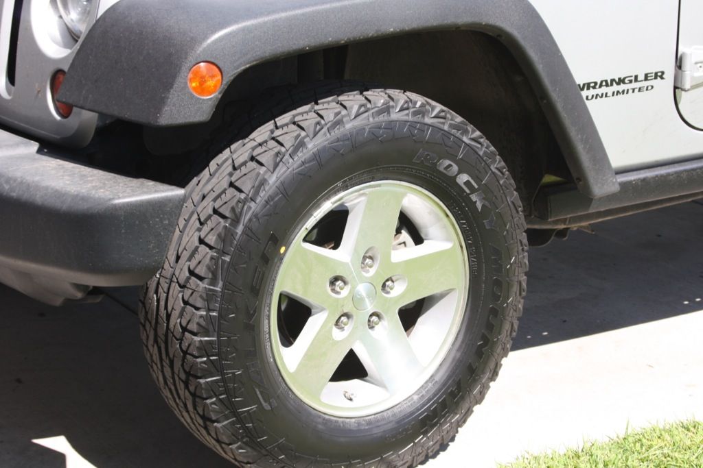

No TJ news, but got new wheels for the wife's JK… kind of emasculated the poor Rubi with A/T tires… went with Falken Rocky Mountains. We got 90k miles out of 2 sets worth of the BFG M/T's, but the wife hated the noise and they were out of balance more than not.
265/70/17 vs. stock 255/75/17… like half inch wider, but half inch shorter… but I figured since this thing will probably never see mud (until she decides to get something else and it becomes mine ), The size/price was right...
