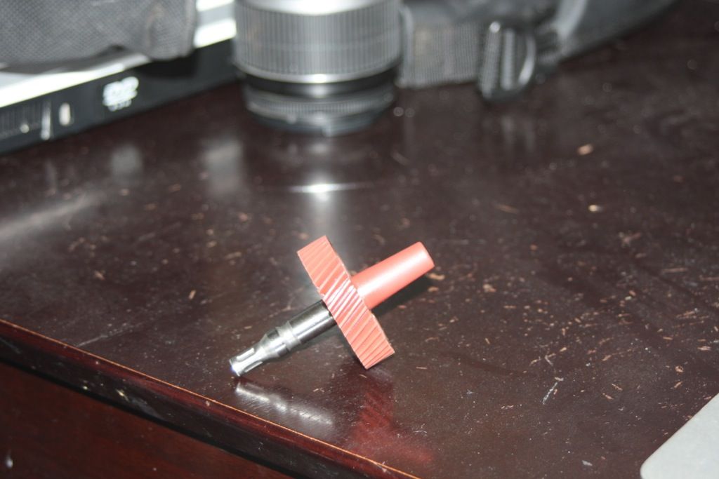

Well, back from vacation a day early so I thought I'd take advantage of the time…

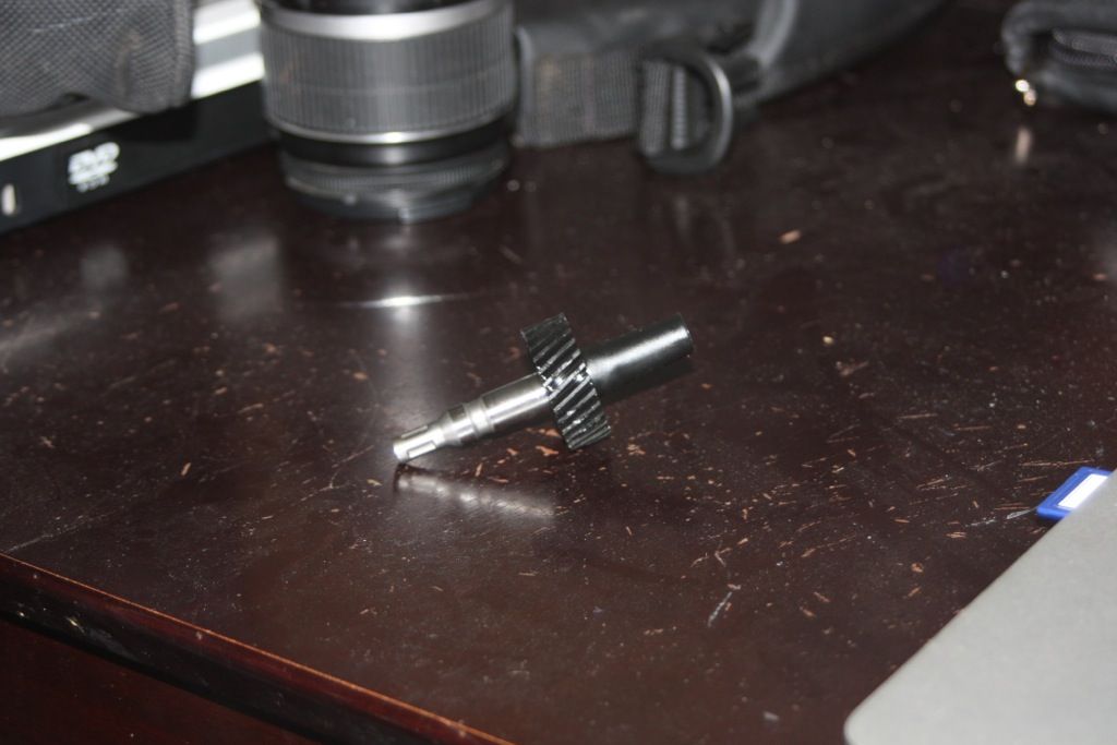

As for correcting the speedo, in with the knew 42 tooth…
Out with the old (no wonder the speedo was way off!!!)

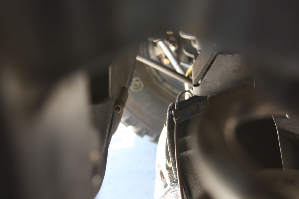

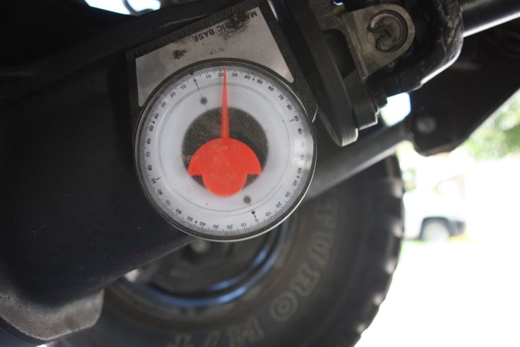

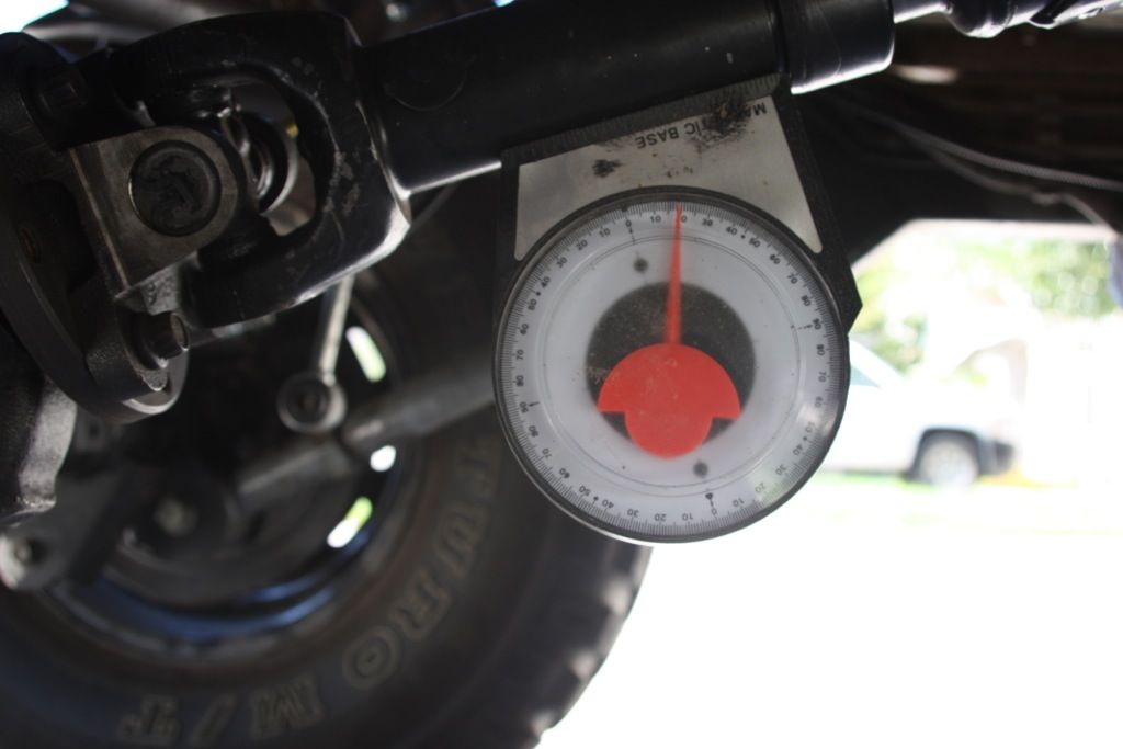

OK, I've been trying to track down a vibe, well, more like a growl at freeway speeds… I assume it's driveline, but my angles aren't that bad, maybe 5 degrees off…
But I guess the input offset and that angle really is a lot. I guess I got to work that out… I got some room to push the entire thing back, maybe an inch…
Although, it might be closer than it looks when it actually flexes.

Have you tried adjusting your arms to get rid of the angle gap? I think ideally you want to be within 2 degrees of each other.

Spent the last couple days getting ready... Adjusted the control arms... Thought I had it just about perfect with the angles, but there seems to be a little vibe... I couldn't really tell because the top was off, but I could kind of feel it. Anyway, my stereo face plate had a short so I replaced it. I put the rear sway bar on, forgot to put it on when I put the axle in... Wow what a differance... Anyway...

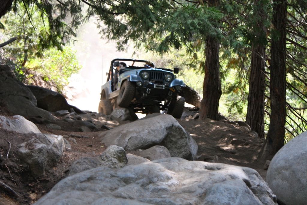

Here is a cool pic my wife took towards the beginning of the day of Mvigo…
Nice articulation for a leaf sprung jeep!!! At least it has round headlights!!!

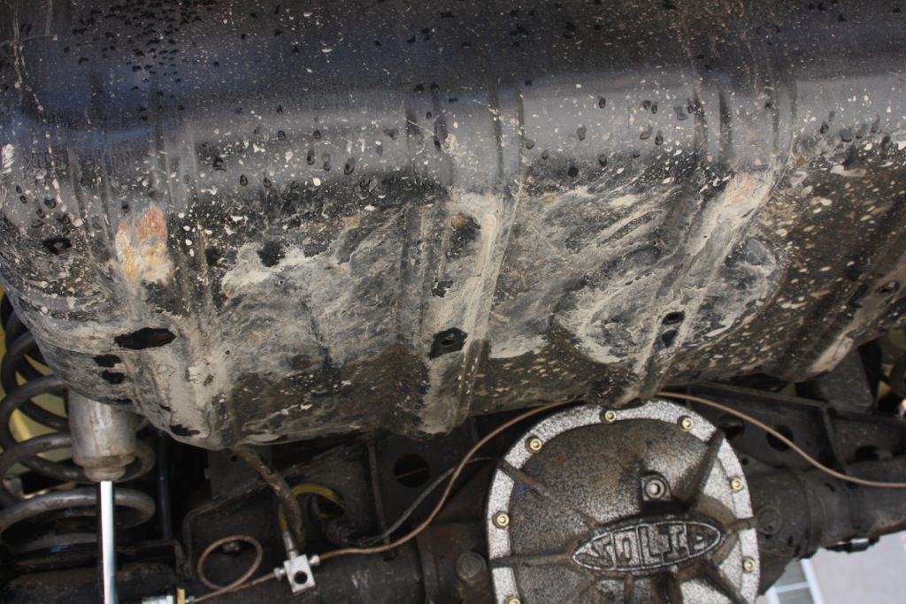

Anyway, the only real carnage was the gas tank skid…
You can't really tell from the photo, but there are three pretty good dents. I have a body lift… maybe a savvy low profile tank skid…
