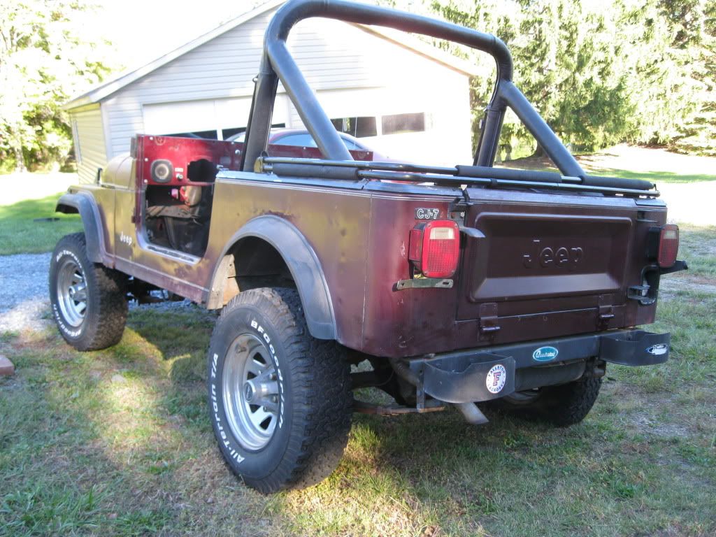

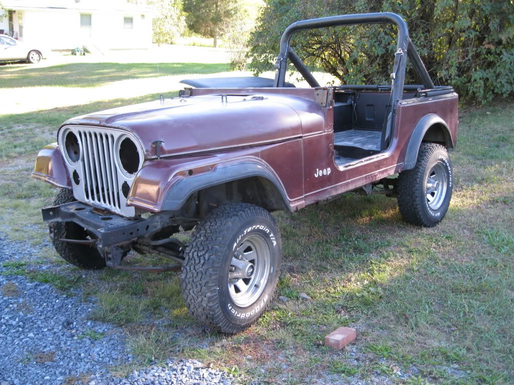

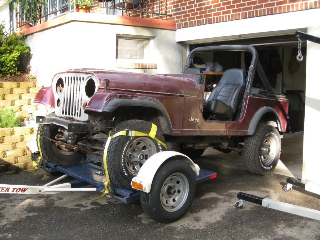

I have been building a 1985 CJ 7 for sometime now but it has strayed from being a trail rig/driver to being a very clean driver. So I found a 1982 CJ7 about 3 hours away from me that seemed very solid. My main goal is to build a mild trail rig out of it. It claimed to be mostly rust free and it had a reman 258 with 5,000 miles on it... the catch is that it was disassembled for resteration and the guy lost interest in it. Im a fairly decent wrench and always up for a challenge so I loaded up the truck and headed south to get it.
Here she is on the Dolly
Finally at home

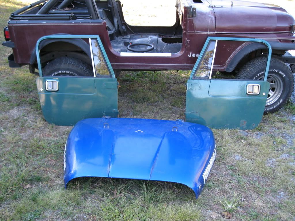

Knowing the rag top that came with it would be a little drafty I decided to steel the hardtop from my 85. She had a car bra on her at one time (god only knows why) and it trapped moisture and rotted out the hood. Fortunately I found a good hood today and also a pair of hard doors to go with the hard top. I gave $220 for everything
Ill get on her this week and post the progress

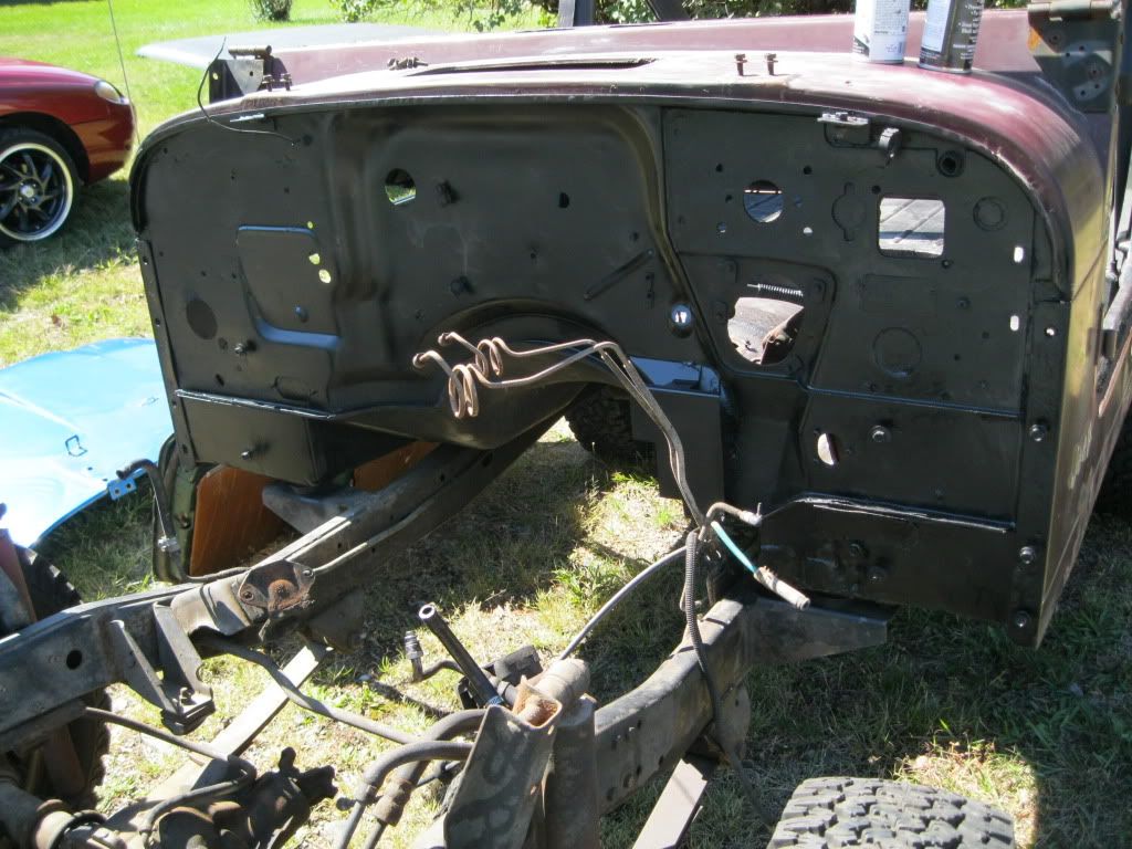

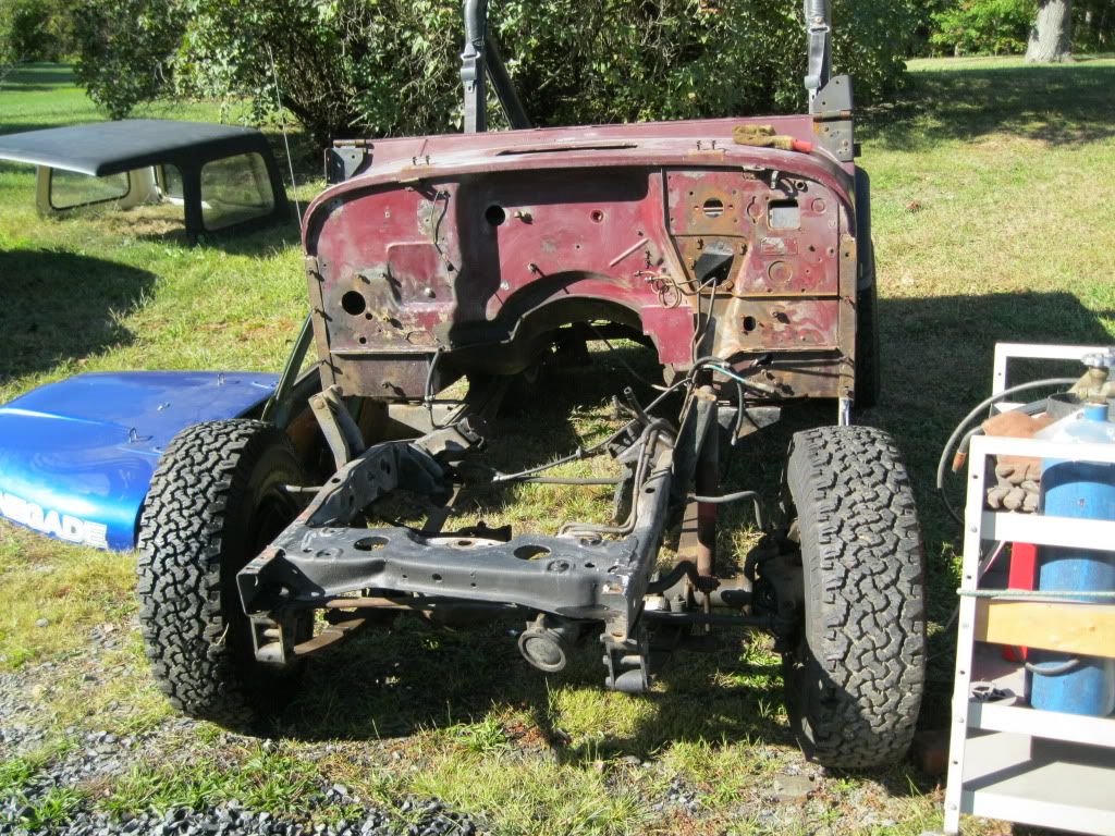

Class was canceled this morning so I got started. First thing I did was pull the front clip and got rid of the junk hood.

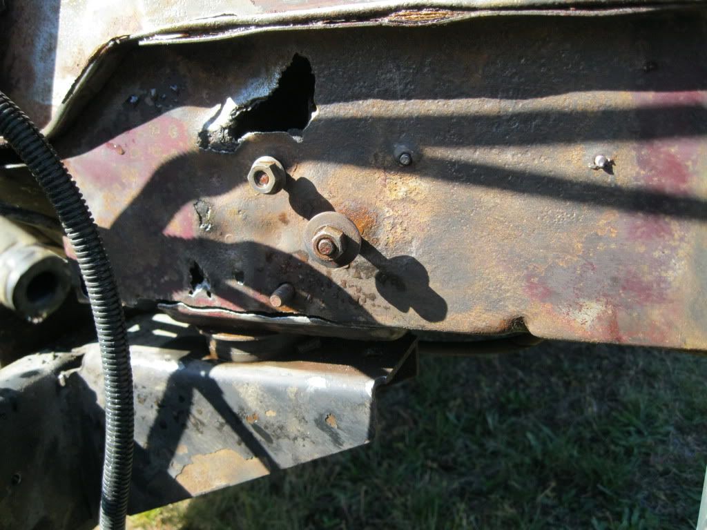

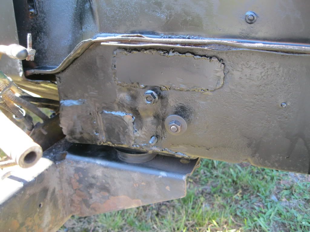

Ran into my first trouble area. drivers side bottom of the firewall was cracked and had a little rust.
To solve the problem I welded the crack and plated the other areas... it doesnt look pretty but im mostly concerned with strength and stopping further rust. So I shot it with a coat of black afterwards to seal it up.
I then cleaned the rest of the firewall off with a wire cup on a grinder and shot it with a coat of black too.

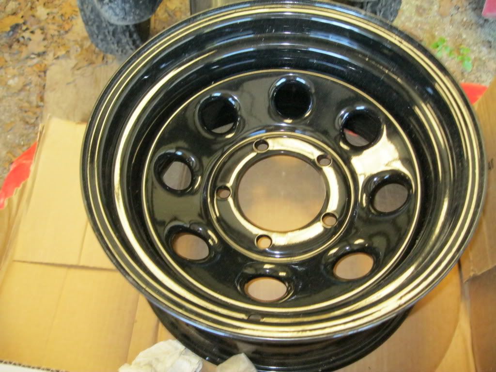

I also got a set of 31x10.50 Baja claws for $300!!!! im going to mount them on a set of Cragar Soft 8's that came with the CJ
