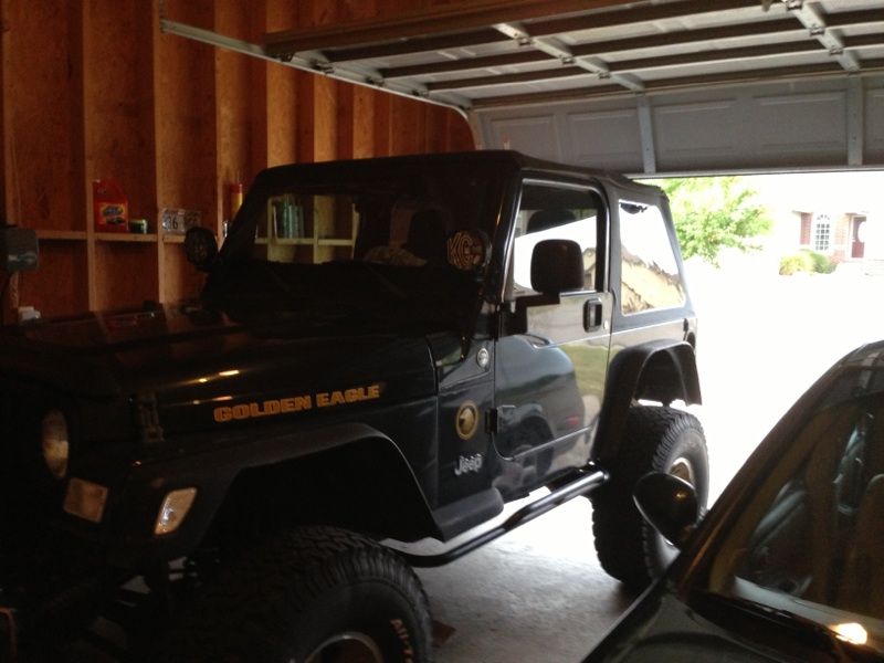

First was the Bestop Trektop NX. Install was straightforward and the included instructions were clear. I wanted to replace the halftop I had put on a few years ago. I never really liked the halftop. It was loud and I could never keep water from coming in around the roll bars in the back. This was caused by me removing the roll bar padding which the top is supposed to tuck under in the back.
This top is amazing. Its quiet, keeps me dry and is loaded with features. It comes with all new hardware (door surrounds, etc.). What I was surprised to see was the hard plastic built into the rear corners. I believe this is to reduce flapping in that area since the top is frameless. It has the sunrider feature and all the windows come completely out with only the top staying on to turn it into a safari with only straps at the rear.

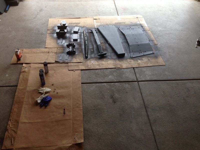

The next item I tackled was the Savvy MUA. Install on this took me a while. I have limited tools and a few other mods I've done in the past got in the way. Note to others. If you cut off and rewelded your body mounts higher, you will have to do some modifications to make this work.
The frame "C" brackets are made to fit over the stock mounts and appear to fit in close tolerance. I have the Genright mounts so I had to notch the frame "C" brackets a bit. If you have the Swag body mounts then forget trying to get the Savvy UA. Those mounts are extremely wide and you would have to cut almost all the material of the "C's" out.
I still need to dial in my drivetrain angle and install the engine skid. Ill take care of the drivetrain angle this weekend when a few more parts come in.

In the past when I was researching (about a year ago) I knew it wouldn't quite fit right. Somehow in that year, I forgot about it and when it came to install I was in for a nice surprise. Basically I took as little material as possible off the "C's" with the grinder to make it work.
Originally Posted by jeepwrangler97 View Post
I really like that top...I plan on getting one eventually. I've got the rampage top, but that was planned as a short term, cheaper option just to get me through the rainy season
Sent by a messenger bird
Its really nice. So far I have zero complaints. My factory top had a small leak in the right rear corner. The half top leaked a lot around the roll bars and was loud. This top is dry and quiet.
