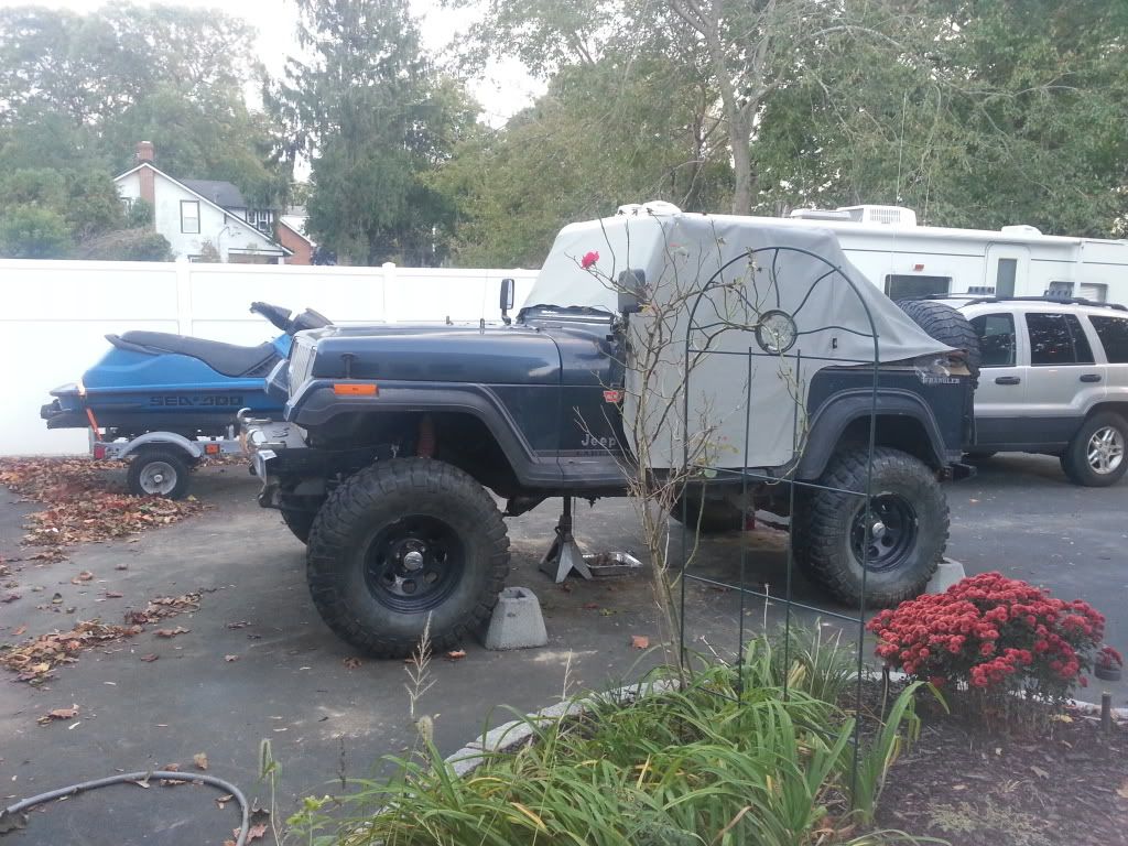

Builds finally coming together, i spent my last two weekends tearing out the old d30 and putting most of the new one in. Went to the jeep rally last saturday got to meet Ian from Xtreme 4x4 and a few GroundPounder Fab Quick release fire extinguisher mounts. happy i won the mounts, i never win anything and with all of the jeep fires ive seen recently they will be on very shortly. Ive also reamed out the knuckles, jb4x4 bracket and pitman arm to accept some GM 1 ton TRE's for my crossover steering setup. While the front axle was out i took some time and sanded some surface rust off the frame and painted some of it with some black engine enamel that i had. Tomorrow of the next day ill put my knuckles and jb4x4 bracket on so i can measure for my steering setup.
Axle out

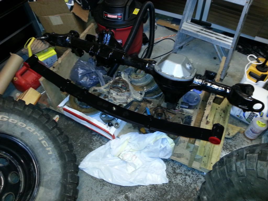

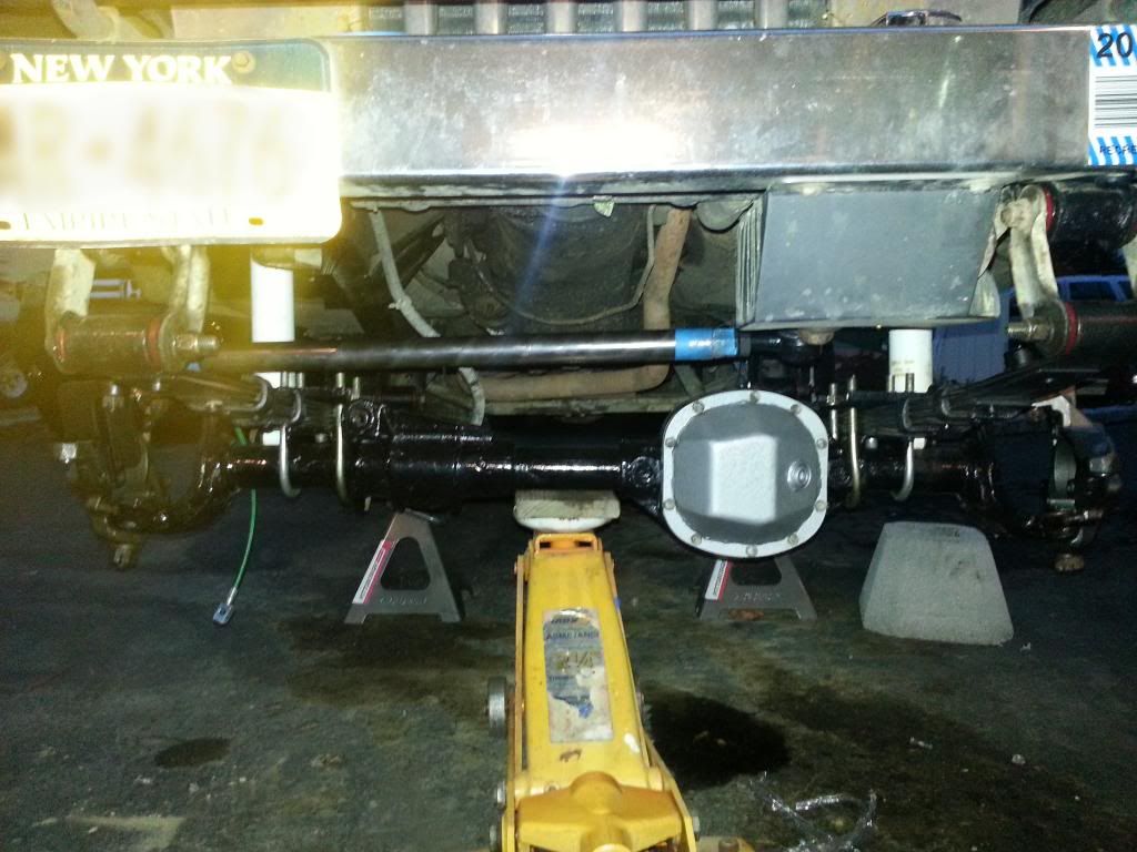

Pics with the D30 in
d30 painted with some chassissaver, BTF DIY Diff cover painted in Hammered Silver; and some stock leafs that I tore apart, sandblasted and repainted
up next is mocking up steering then fully welding the jb4x4 bracket to the knuckle

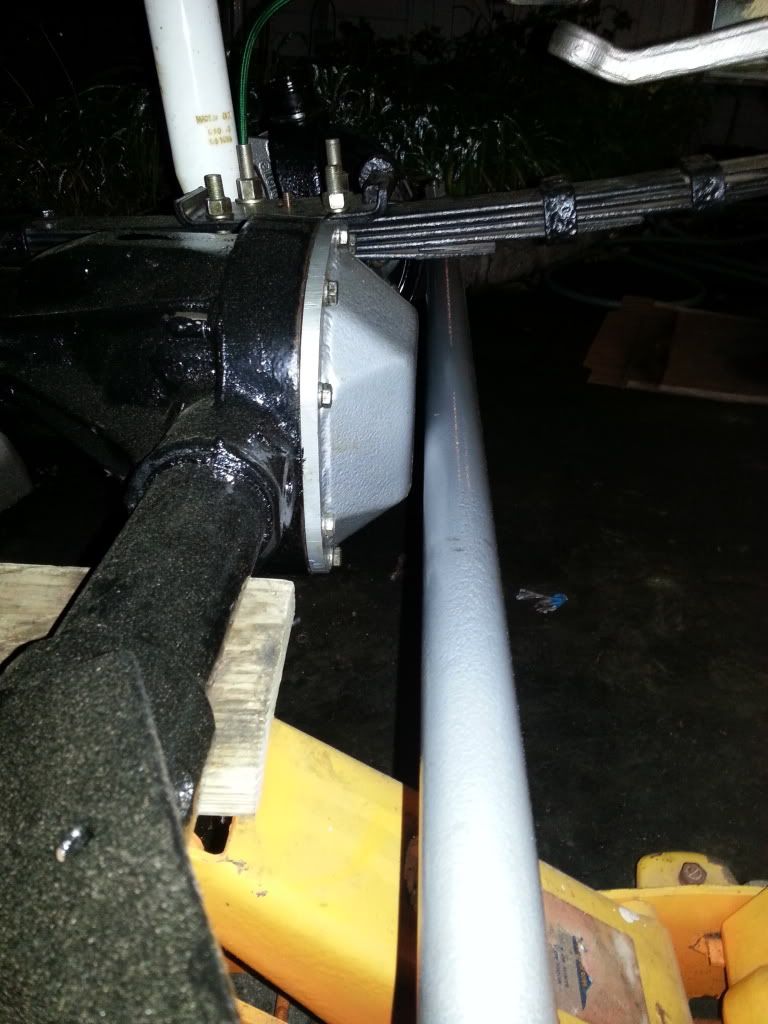

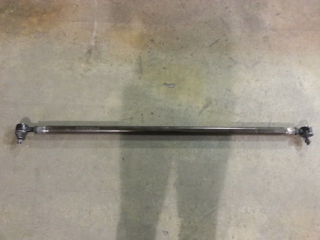

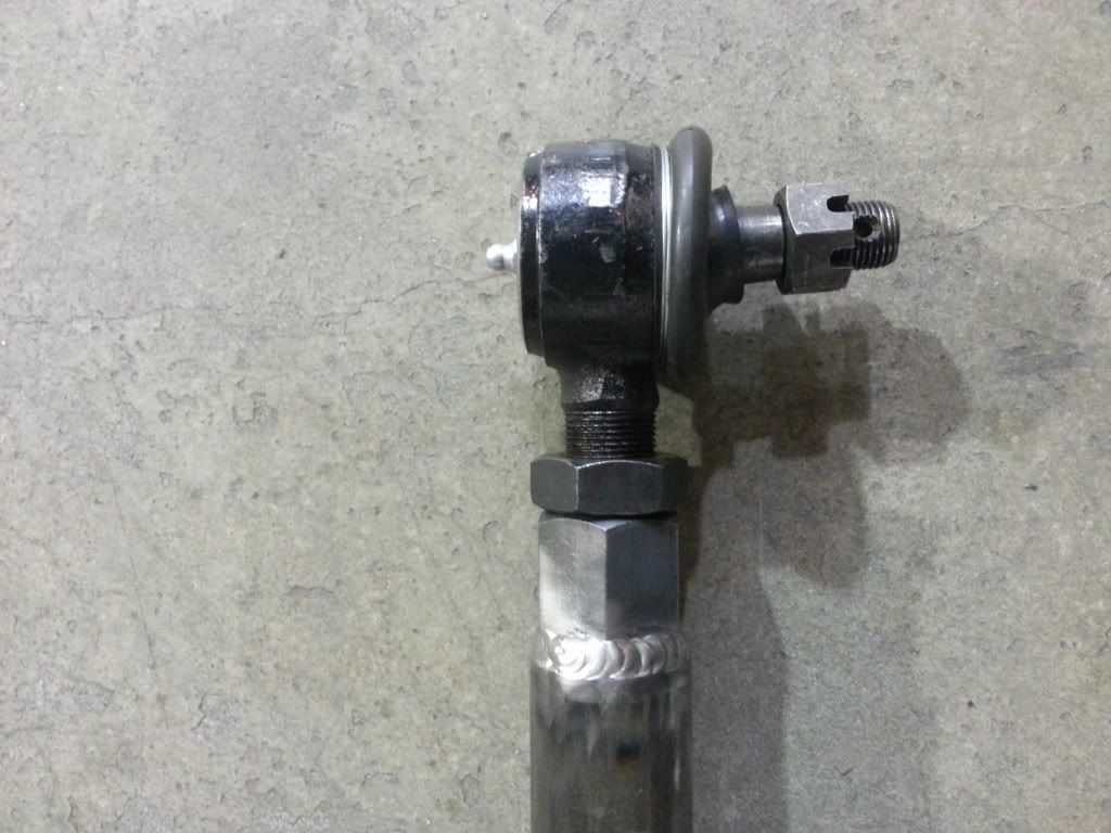

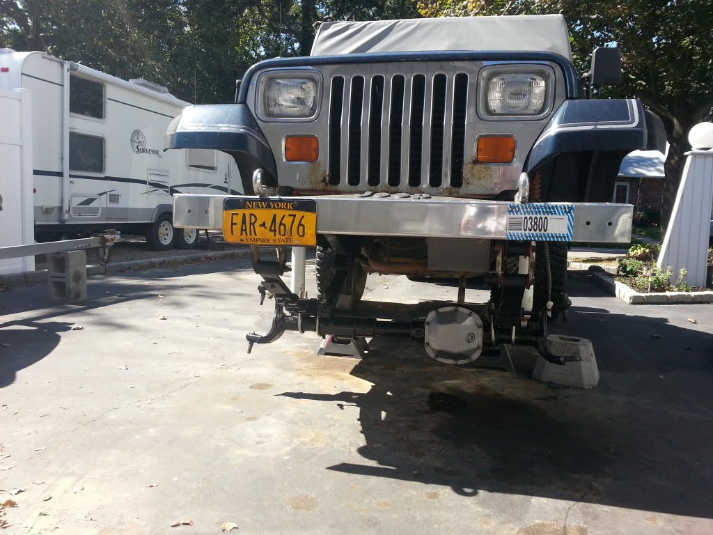

Got some progress done! Within the last few days ive reamed my knuckles, pitman arm, and jb4x4 bracket to fit GM 1 Ton TRE's along with cutting, welding and painting my crossover steering. Happy to say that everything coming together nicely
Tie Rod
Compressed the springs by lifting the axle with the jack to fit the tie rod when it is at a normal stance. Im happy that angle is nearly parallel to the ground
Tie Rod installed, now i just have to wait for my other TRE's so i can install the tie rod.
At Full Lock my Tie Rod is about 1/4" away from the Diff Cover

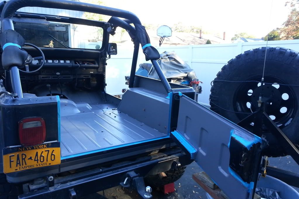

Figured its really the last nice weekend to paint untill the spring so took a break from my axle swap and decided to use monstaliner in my interior. I picked up some meduim quartz gray a few weeks ago at magnet paints along with some chassisaver that was used on my front axle. I really couldn't be any happier how it turned out. I initially chose monstaliner because of their color selections and because I liked the texture.
If anyone wants any specific pictures feel free to ask

Few pics of the YJ:
Another shot of the monstaliner

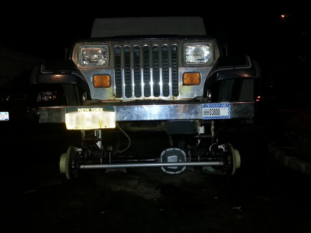

Front axle installed, just need to put in the rear, cv shaft, sye and belly up

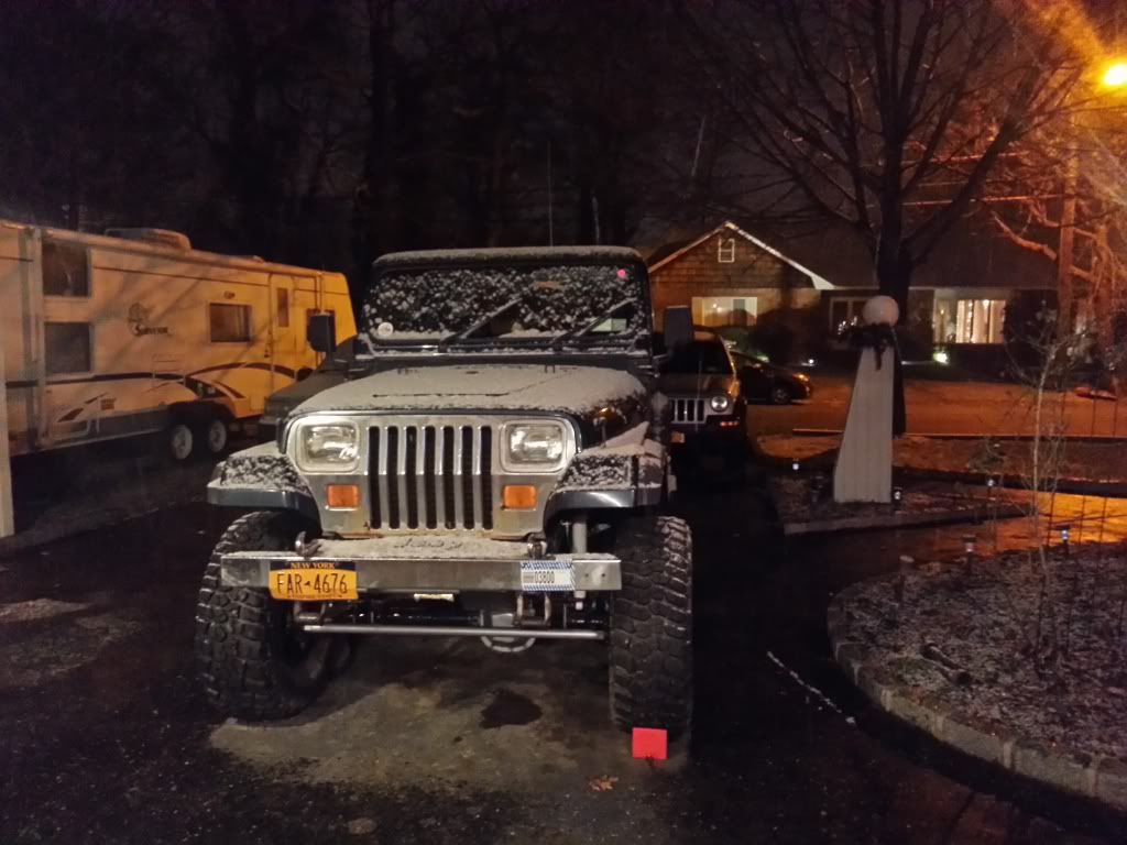

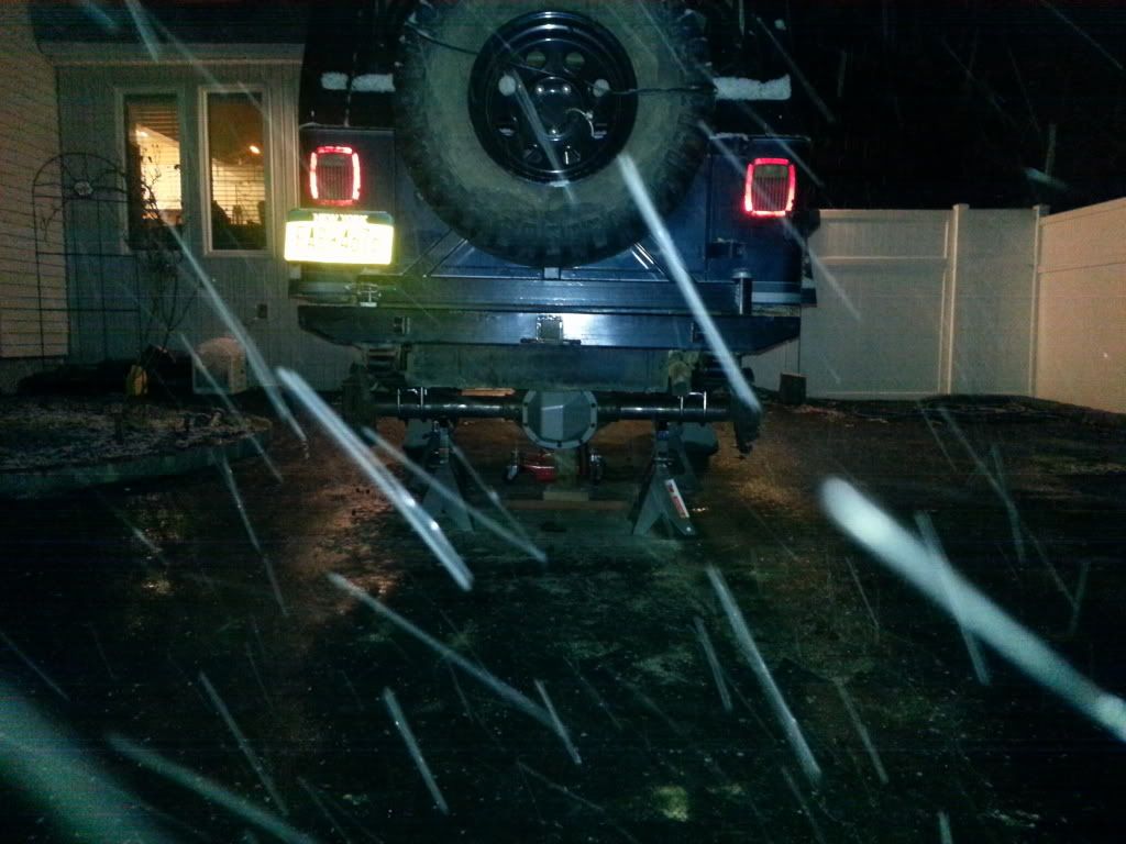

Sorry guys, been slacking on my jeep ever since the weather got colder. Im getting some progress done, just not as fast as i would like.

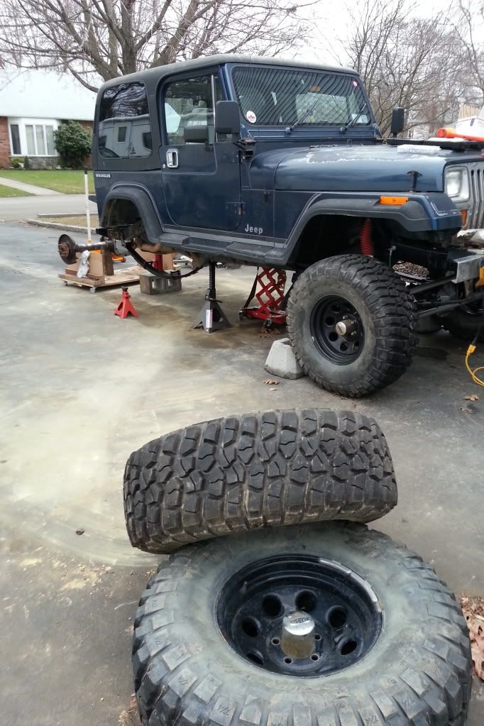

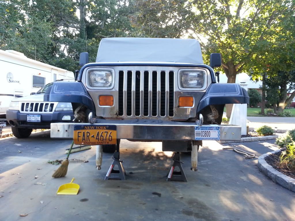

As of now, the 8.8 is mocked up and the driveshaft came in from tom woods. I wanted to wait for my DS to come in so i can measure my pinion angle and DS angle accurately, and to make sure i wouldnt have any binding issues. its been getting a little warmer so i expect to have it done pretty soon. I still have to build the tranny crossmember, and antiwrap bar, as well as welding the axle.

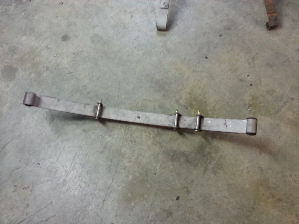

Folded the tabs out holding the leaf springs, drilled holes and threw some bolts and crush sleeves on them to make it easier to change if i break a leaf on the trail.
It should also help my flex a little because there would be less restriction on the leaf when it is forced downward

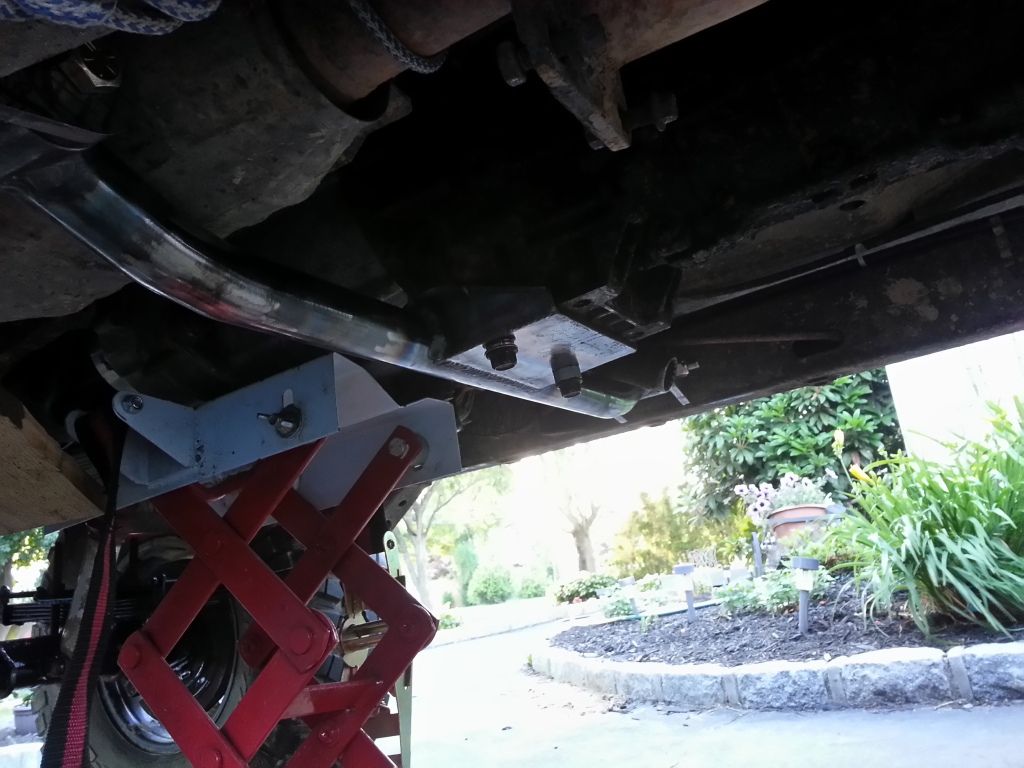

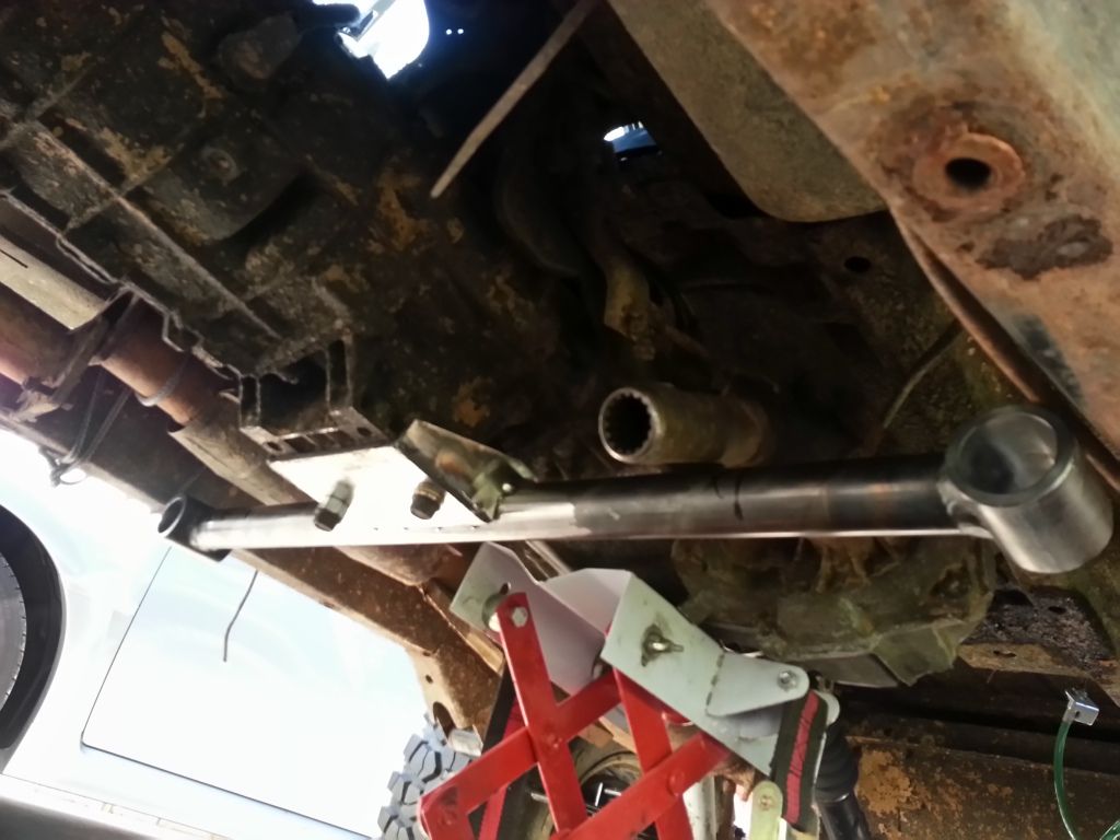

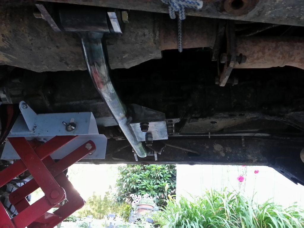

Few Months ago i picked up the Kit from Ruffstuff as well as 36" of 1.5"x 0.250" DOM Tubing to make my crossmember for my tummy tuck. I built a bracket out of some 1/4" steel and countersunk the bolt holes so i can put some flat head hex bolts in there to save as much space as i could. The following Pic shows the crossmember tacked in place so would determine where i would bend the ends to fit around the cat and driveshaft. The tranny jack helped alot, it allowed me to adjust the angle of my driveline to make sure my driveshaft was at a safe angle with the output of the transfer case and the pinion on the axle.

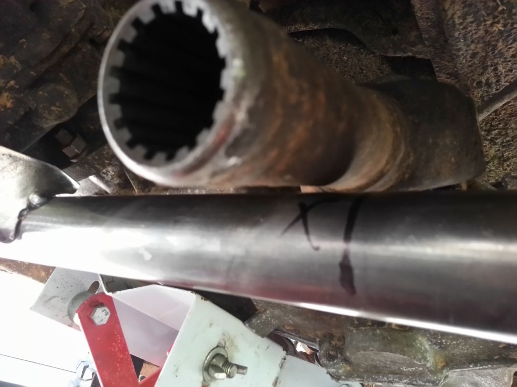

Took a few more pics after i bent the tubing.
Have some bolts to hold it in place, but ill replace those with some hex flatheads for Max clearance from the skid im going to build
About 1/4" to 3/16" clearance from the front drive shaft at max droop, looks like i wont have to notch anything.
I guess my next thing to do is weld up my brackets to the frame. pics to follow...
