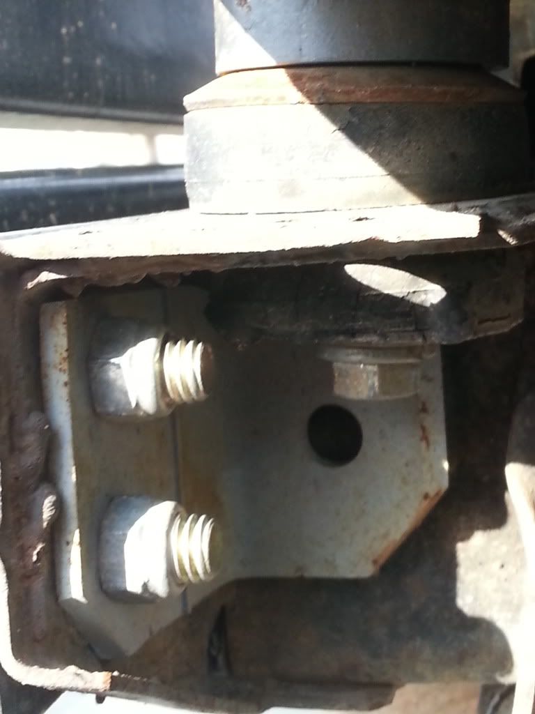

Heres a pic of the bracket, i made sure it clears the shackles when im flexing too. I planned on bolting it through the frame but im planning on welding it on the edges towards the shackle and inside the empty bolt hole

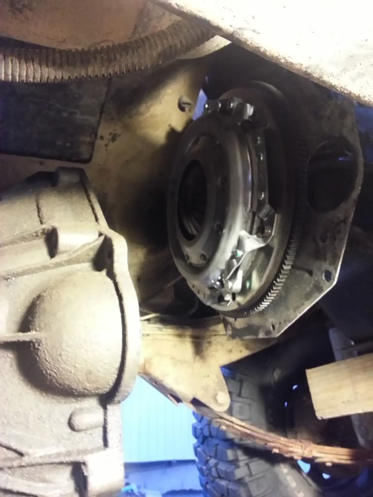

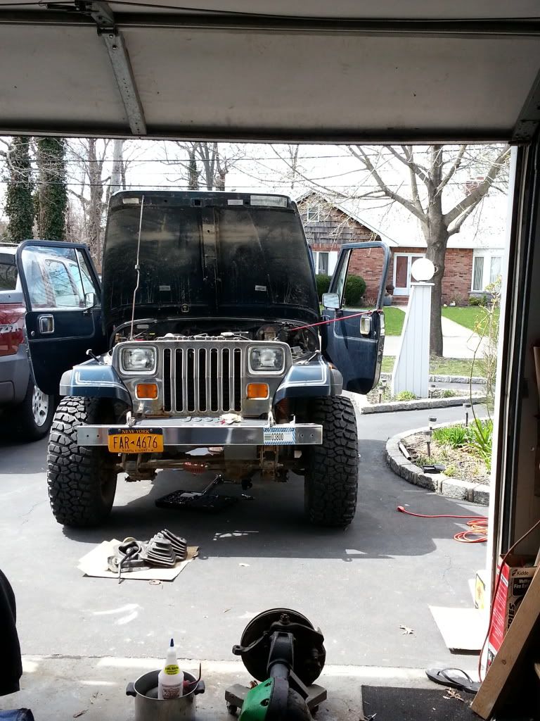

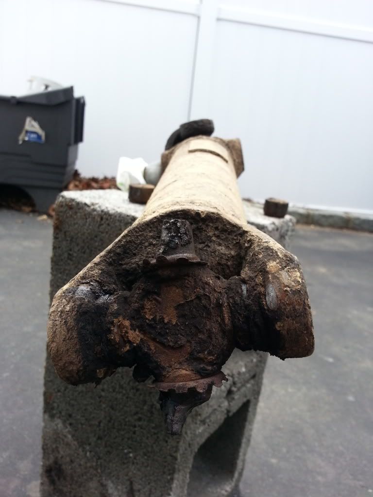

Clutch and transmission are back in thanks to a few runs to the parts store to get a puller that wasn't broken already, and some cold beer. All thats left is putting in the exhaust and transfer case skid sometime tomorrow night. not too bad for my first time doing a clutch
Took off the driveshaft and noticed my destroyed u-joint. really surprised it didnt break when i was driving

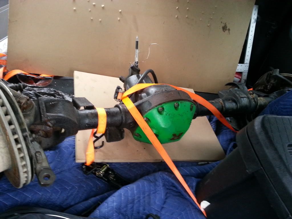

Picked up my Dana 30 already setup for SOA except steering. Ive been checking out a few kits for steering and have some ideas.
1. Rocky Road High Steer Kit-
Ive heard some good and some bad reviews about this kit which includes the drag link hitting the tie rod and mounts coming loose (i can get rid of that by using safety wire on the bolts). In addition to those, i dont really like their Tie Rod design with the steel block used to mount the drag link. I feel that you can not get a proper alignment because you can only spin the drag link 180 degrees at a time to line it up with the hole on the tie rod. If you can only rotate the the tie rod 180 degrees and assuming the TRE's are 7/8-18 thread that each 180 degree adjustment will only have 1/18th of an inch adjustment.
2. Use Rocky Road High Steer Knuckles with a steering setup like the one AtoZ fabrication makes (shown below)
Ill get full range of adjustability for an allignment and like the rocky road kit ill have thick .250 wall tubing.
3. JB4x4 Bracket with GM 1 Ton TRE's, A to Z Fab Threaded inserts and .250 wall by 1.5" dia tie rod and drag links.
Probably the cheapest option compared to the 2 above because. I have the thick .250 wall tubing but the drag link sits where the stock one sits now. It sits pretty low and might be easily damaged by rocks.
Im leaning towards number 3 because i really don't want to throw a bunch of money into the D30.
Please let me know what you think

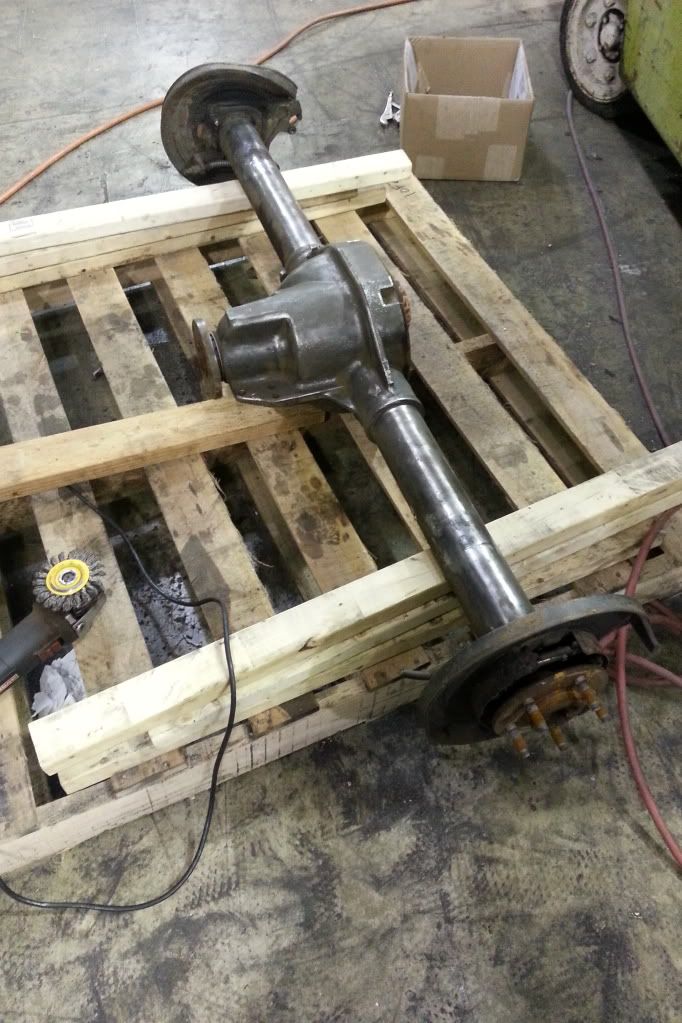

Im going into work tonight to work on my stock leafs, right now there sand blasted, tonight im bending the spring clamps so that they are looser on the spring. They should help down travel and also prevent the main leaf from bending where it stays bent.

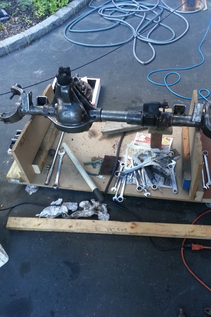

Spent the last two days stripping my D30 and 8.8. Within the next few days im going to use the Jet Black Chassis Saver that came with my Medium Quartz Gray Monstaliner Kit
The D30 just needs to be painted before going in the jeep along with the stock leafs. The pinion angle of the 8.8 has to be set, after i install my Brown Dog MML and Barnes 4x4 crossmember. Then lastly is the SYE and Tom Woods Driveshaft, and my JB4x4 Bracket with Ruffstuff Crossover Steering DIY kit
