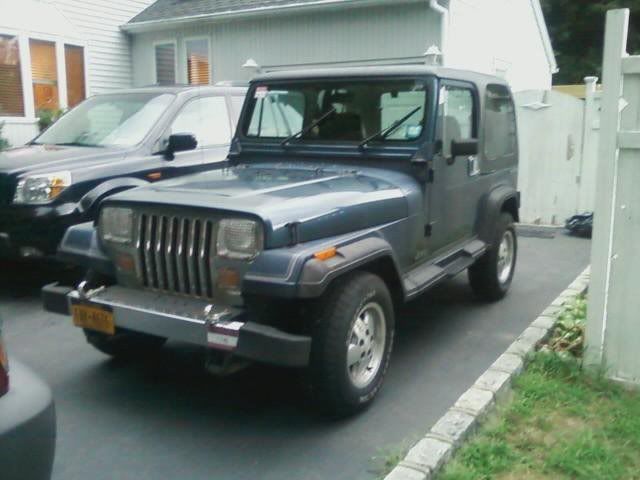

Here it goes... Last summer around august i bought an 87 wrangler as a trail rig so i can give my 04 WJ a break offroad because its my daily driver. After searching craigslist for weeks looking at different YJs i found one with a 4.2l I6 bone stock with the carter carb. I finally decided that this was the one, I bought it the next day for $2800 with 66k miles and barely any rust. This is how it sat the first day i got it:

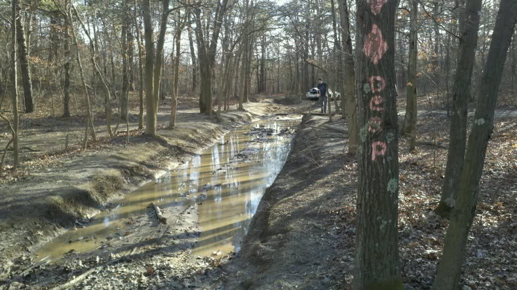

That summer i also got my county offroad pass so i can wheel on the beach:
im the yj on the right
Wheeling at some local trails:

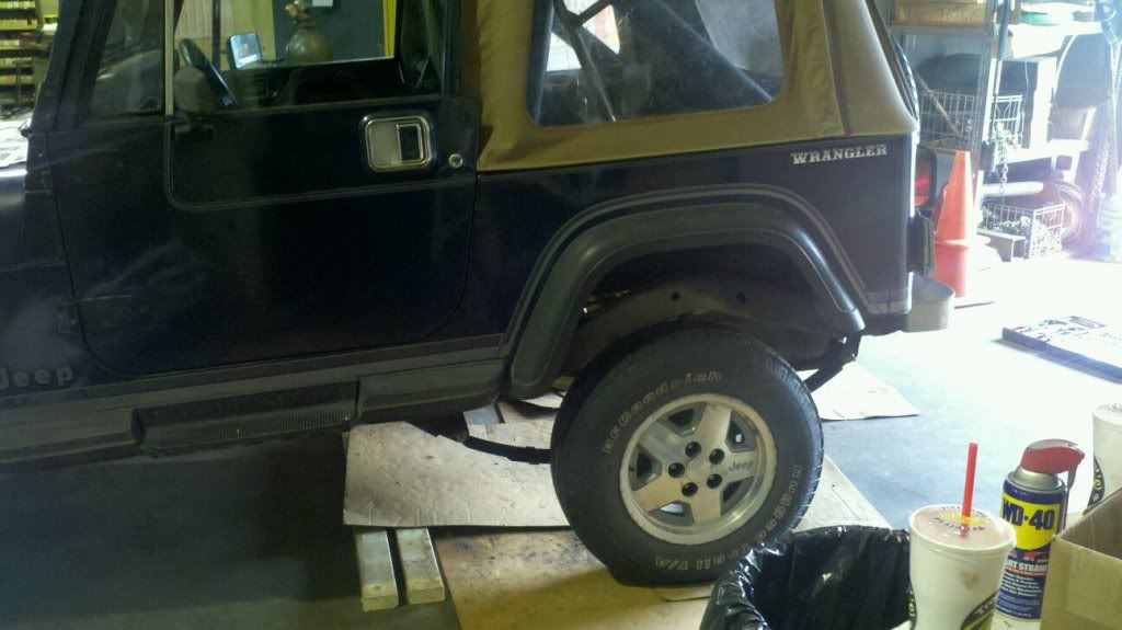

Started the lift about 3 weeks ago at my dads job in one of the garage doors they had because they had air lines for my impact gun and air tools. Decided that i was going to do the rear one night then the front the second day.
After a while with a big hammer and PB blaster the last bolt in the spring eyes of the leafs to remove the leafs wouldn't come out. i tried heating them, and even using a larger hammer, it still didn't come out. ended up spending a few minutes with a grinder to cut them out. the next day i spent 2-3 hours searching for new bolts to replace all of the old hardware on the leaf springs found the 1/2 x 5 grade bolts without a problem but couldn't find the 9/16 x 5 bolts anywhere, ended up finding them at lowes. rear was finally done the next day:
