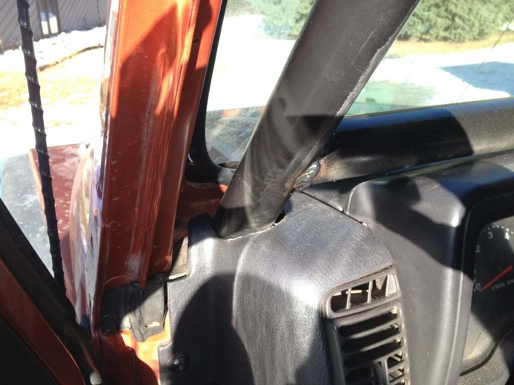

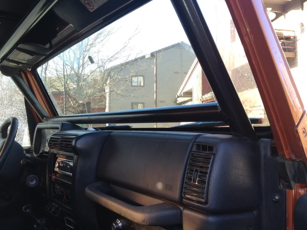

Originally Posted by tdij View Post
Where are the pics of your lower section and the dash?
Here you go!

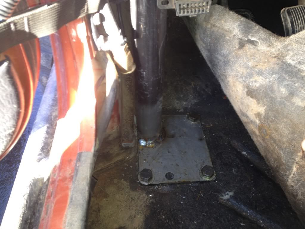

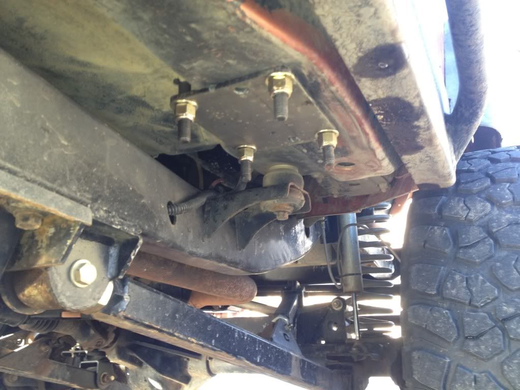

I need to lop off the ends of the bolts, paint, and a few other small things. Going back to the garage tomorrow to finish!

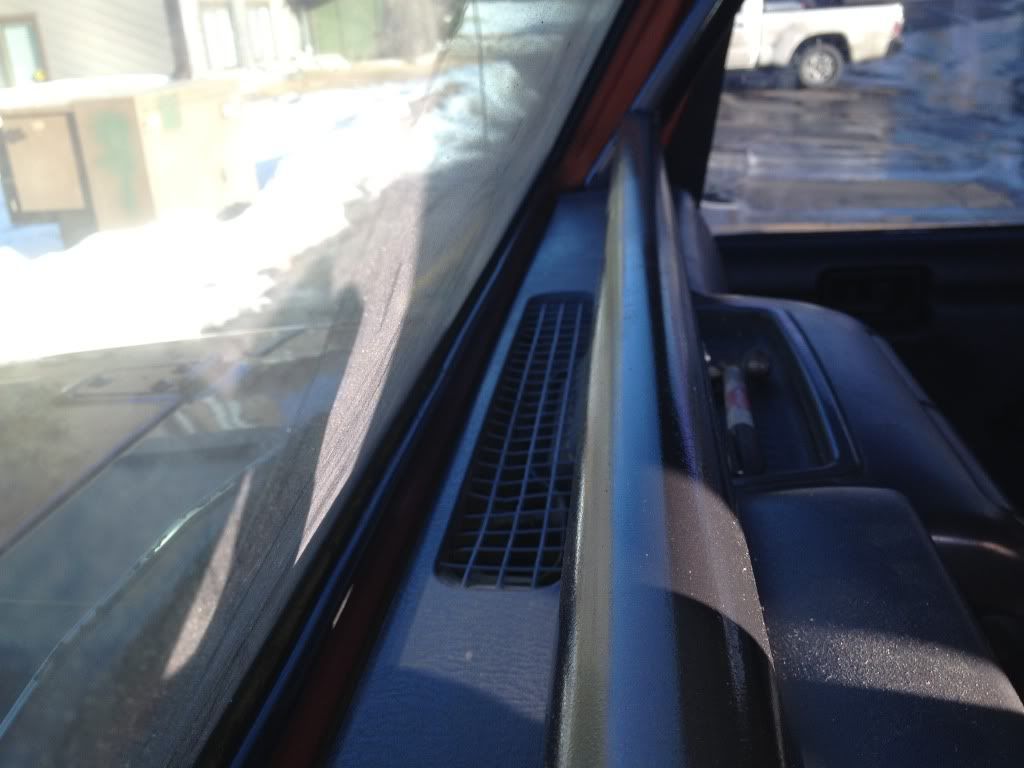

That dash bar came out well. Those are hard to get level and clean.

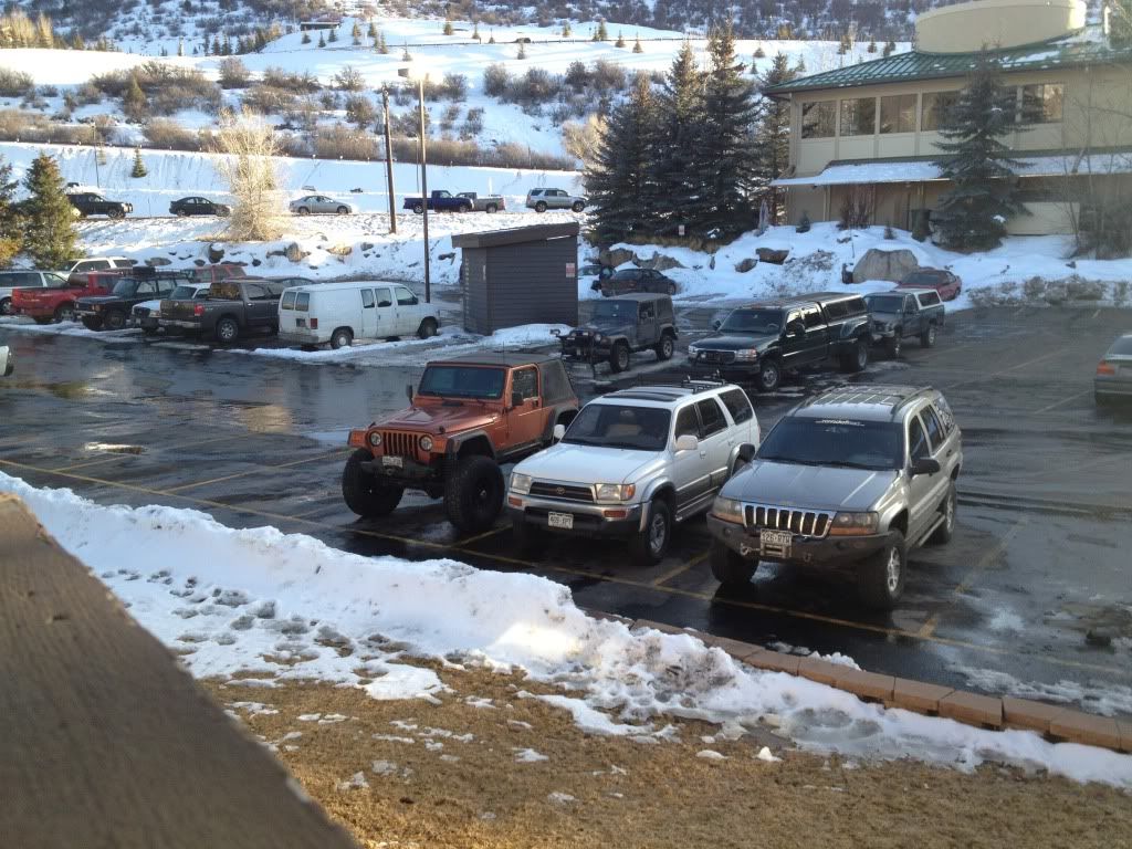

That Snow plow jeep in the background looks like a toy car behind urs haha

Very Nice! Dash looks cleaner than I was expecting... not going to lie!

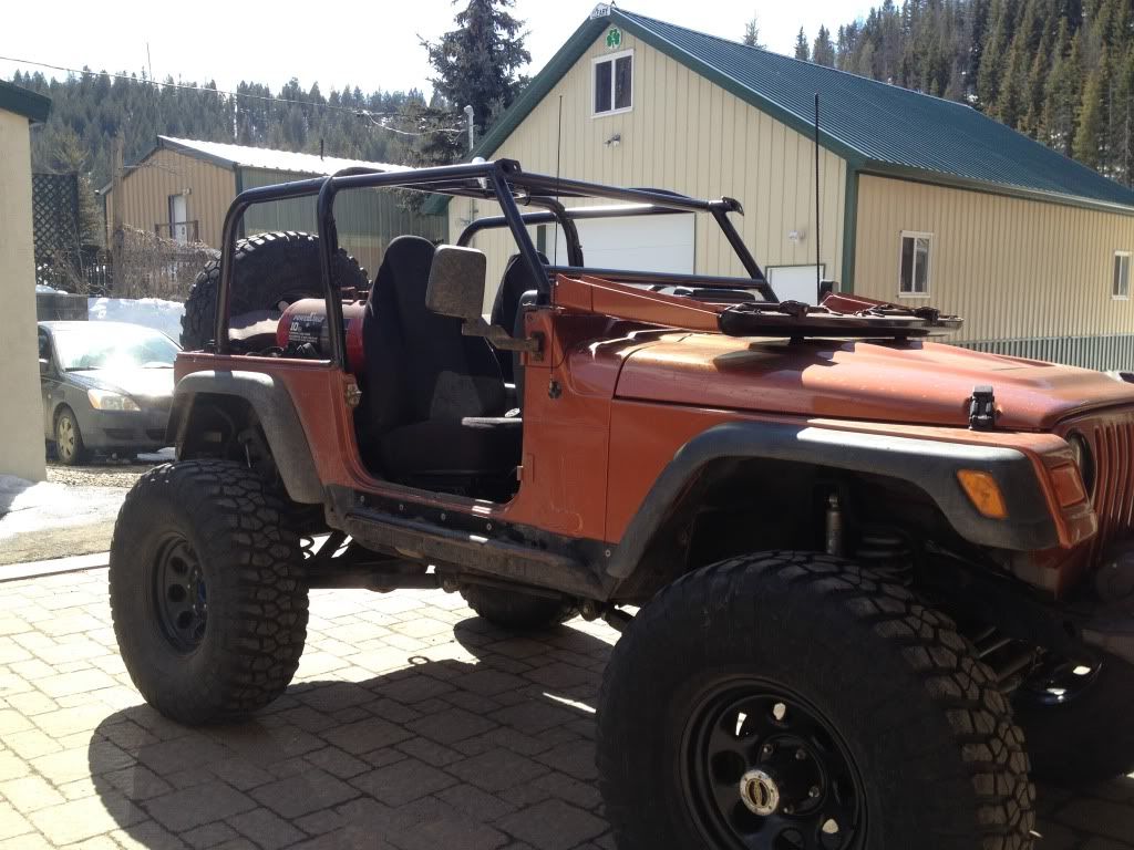

Absolutely! I'll be fabbing my own, along with a bunch more crossbars, angles, etc...
Today I made the cage black!

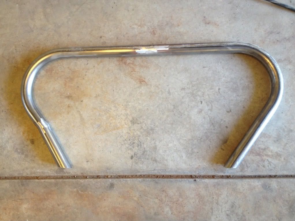

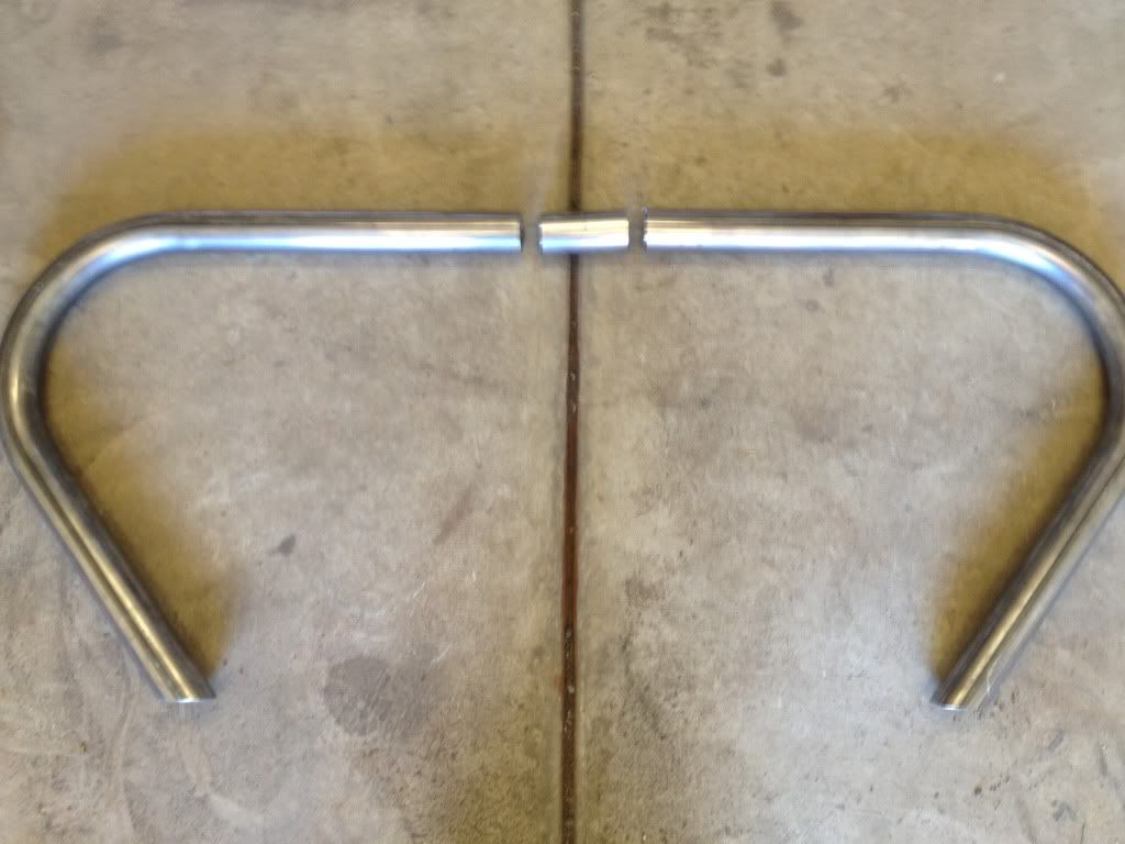

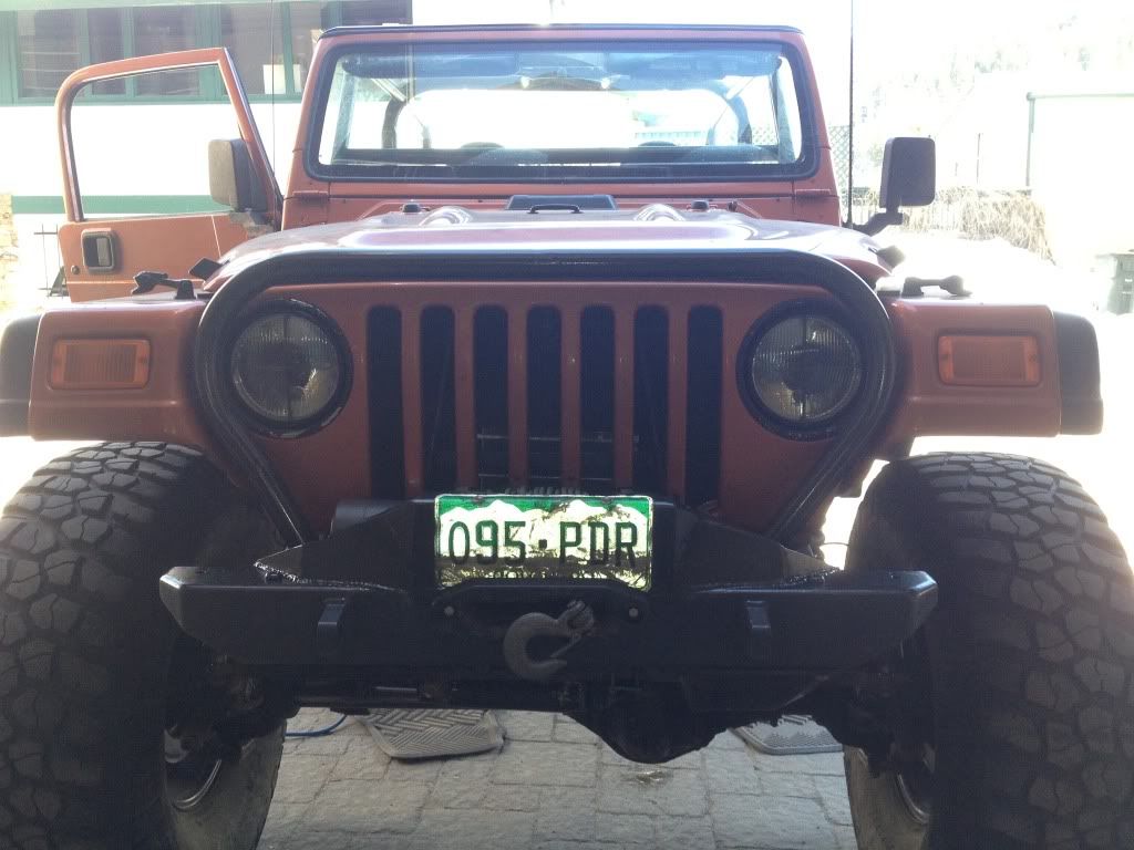

Got my GenRight grill hoop. As I suspected, it won't fit without mods because of my highline fenders. I removed 3.5" from the center, and welded in a slug. I also had to bend the left side a bit to fit the asymmetrically shaped winch.
