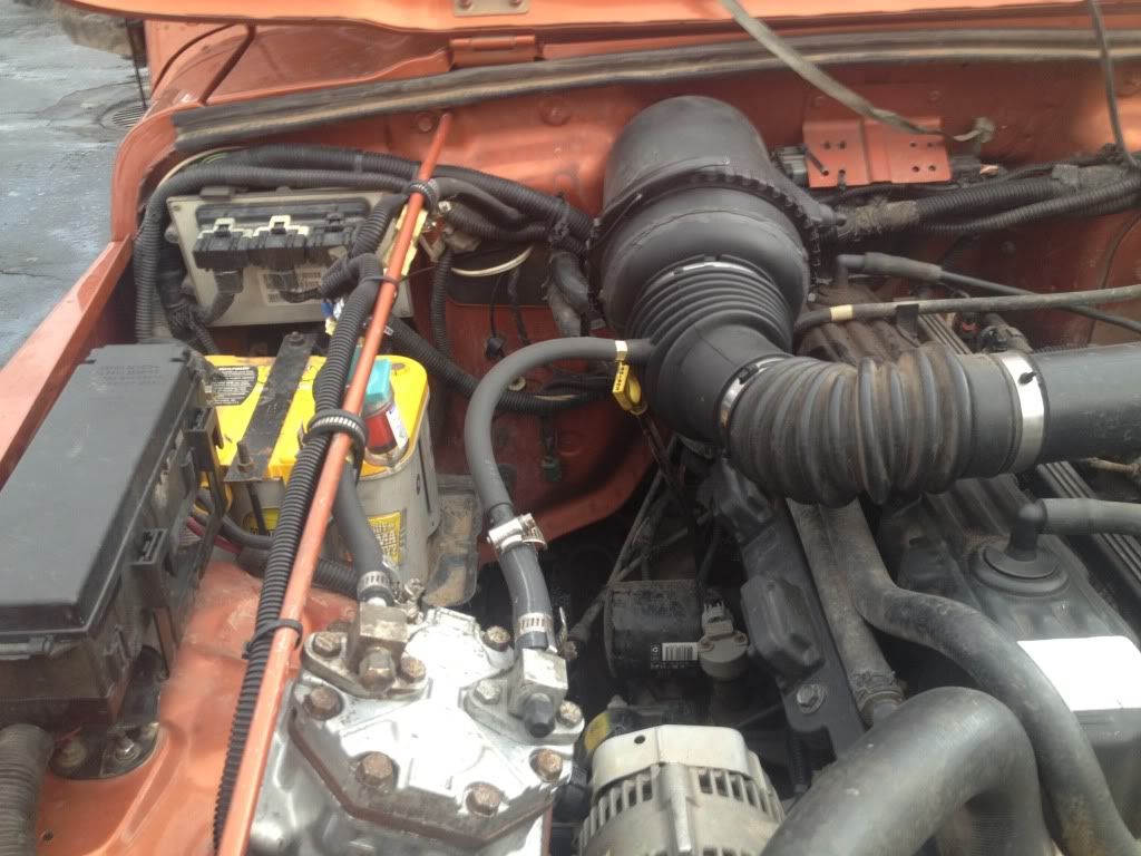

I tied the compressor intake line into the clean air from the engine intake.

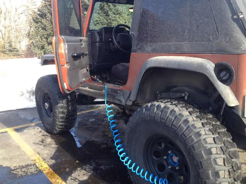

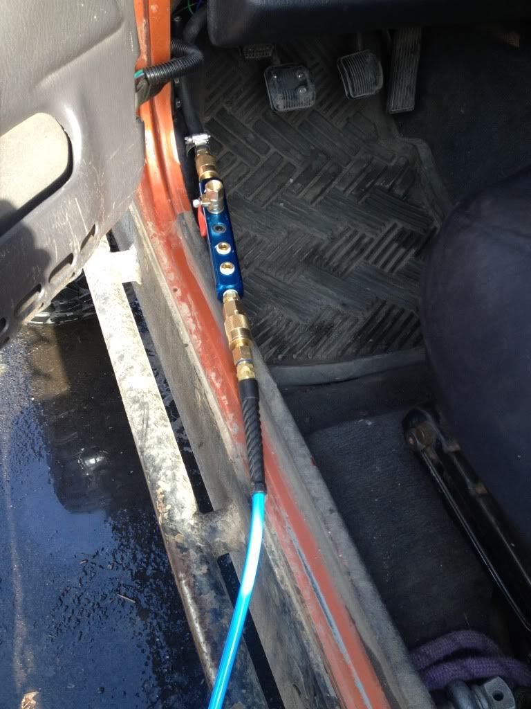

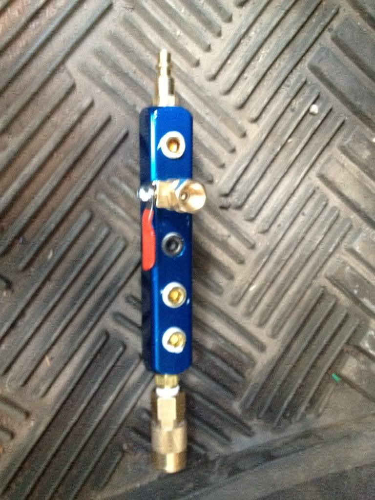

The OBA is 99% done. The only thing left is to tie the ARB lines into it.
I installed 2 quick couplers in the system, one on each side under the dash. I will be able to air 2 tires at a time. As well as air down 2 tires at a time, keeping the pressure equal in each tire.

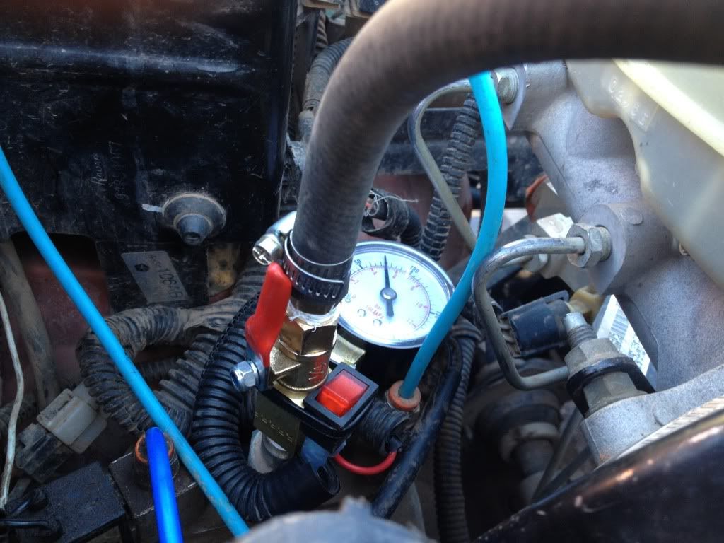

I put a ball valve in an old manifold I had. To air down, I connect the 2 air lines to 2 tires, and open the valve. I can sit in the cab, and monitor the pressure from there.

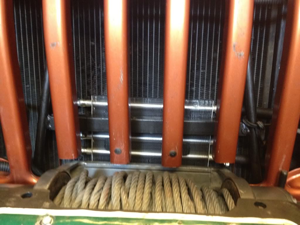

Hydro assist is still in my future, so today i installed a transmission cooler. It was a simple install, I ran the low pressure line from the box to the cooler, then a line from the cooler back to the pump. I mounted it in front of the radiator. Hopefully this will help the steering during slow speed crawling.

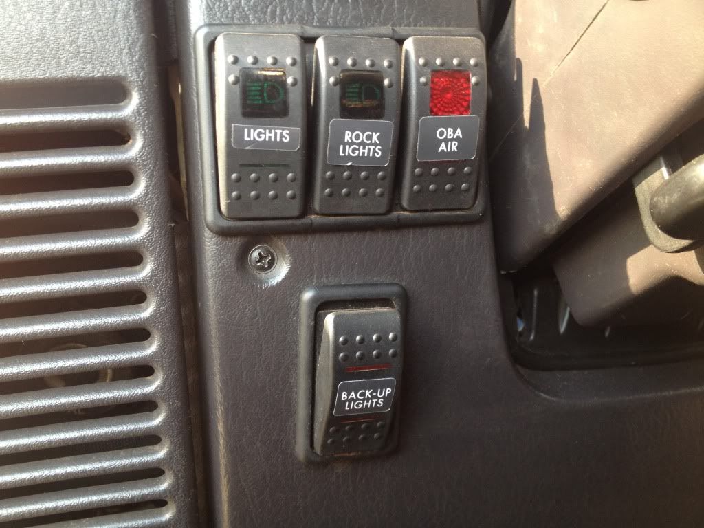

I picked up some stickers for my switches.

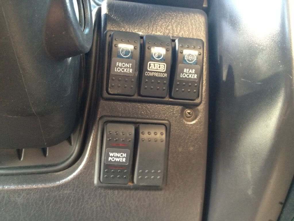

Today I tied the lockers into the OBA system. No more loud ARB compressor when wheeling. I'm keeping the ARB compressor in place, as a back-up. I wired in a compressor override switch, and added a ball valve. This way I can isolate the original ARB system when needed.

Where and how much, if you don't mind me askin, did you find those stickers for the switches?

Thanks, I'm very happy with it. I have no idea where I'll mount the low pressure gauge for the tires. I lowered my system pressure to 105 for now. If everything runs good at that pressure I'll leave it there, and maybe get a gauge that reads 0-110. I don't have any good ideas where to mount a "second" one.

I'm interested as well, but it is not at the top of my list either. Hopefully the cooler I installed helps the whine when I'm wheeling. If not, it will move to the top quite fast!

I actually got them at EJS last year. I forgot about them, and just came across them. I'm not too excited on how they turned out. I'll be taking the switch actuators off and will be replacing them with different ones. Let me know if you are interested in the actuators and/or the unused leftovers I have. I'll get a photo of whats left, if you're interested.
