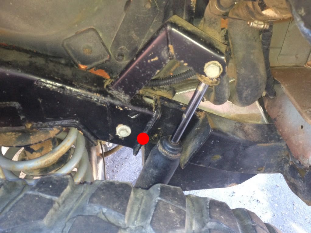

Do you think there would be any issue with keeping the bolt in the same place? Could a hold be drilled through the new notch and bolted in the same location and use a shorter bolt? Would there be room to fit bolt head between the frame and the shock?

Here is a pic that shows where the hole would have been on mine.

Ahh, that would not work

Until I went out and looked, I couldn't remember why I did it this way. I think that is the best way to go about it. Let me know if you come up with something different.

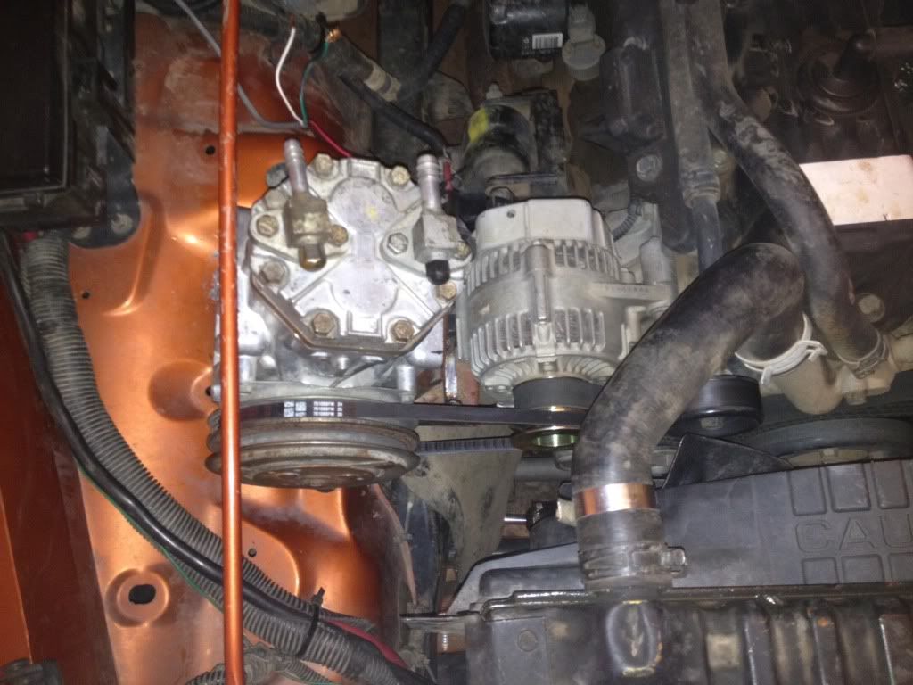

I installed the Compressor yesterday. I decided to go with a combo pulley for the alternator, and run a separate fan belt. The. bracket I made is pretty funny, but works great! It is mounted to the engine block, under the alternator.

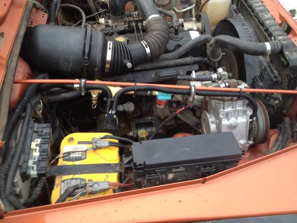

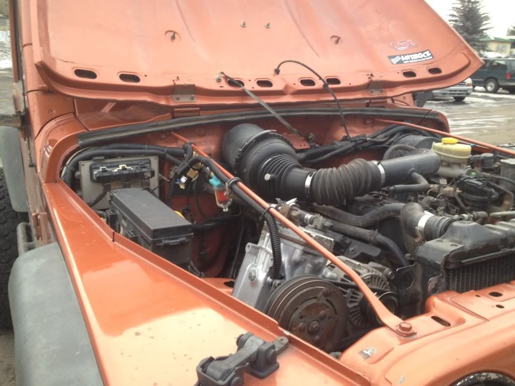

Got the OBA 90% done. I still have to route the York intake to the engine intake, and a few other minor things.
I took mrblaine's advice and I'm not gonna mount a tank...yet. I have a 10 gallon tank to keep in the garage/campsite for running tools. I have 2 quick couplers, one under each side of the dash, next to the doors. I also put the air pressure gauge in front of the TC shift lever.
