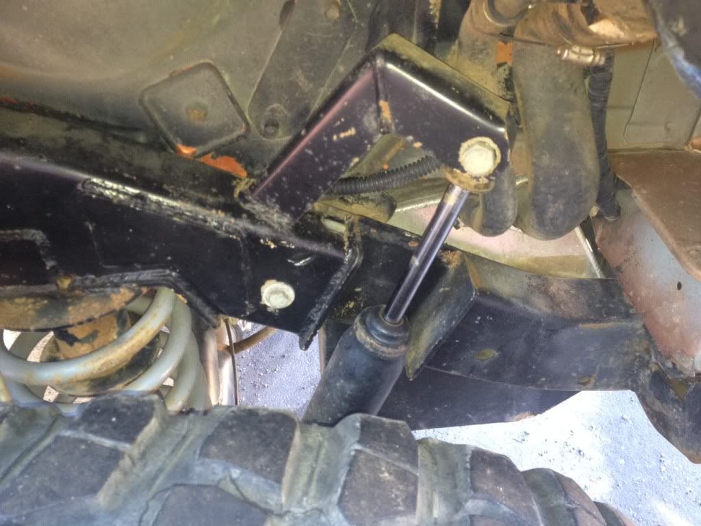

Before the holidays you mentioned to me that you had to fab some tabs to mount the Crawler Comp Tank with the Clayton stretch. Were you able to take some pics and measurements yet?

I was trying to figure out why new tabs would be needed when you outboard the shocks. Did you have to cut the crossmember to fit the 60?
It's been a while, but I think the original tabs are located where the frame is notched for the shocks. So I added an inch or 2 so the tab mounts just forward of the notch. I'll try to get pics and measurements sooner than later. Sorry it's been so long!

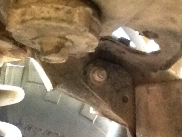

This is a shot of the lengthened tab. You can see the hole for he original bolt location.
This is where I relocated the new bolt to.
