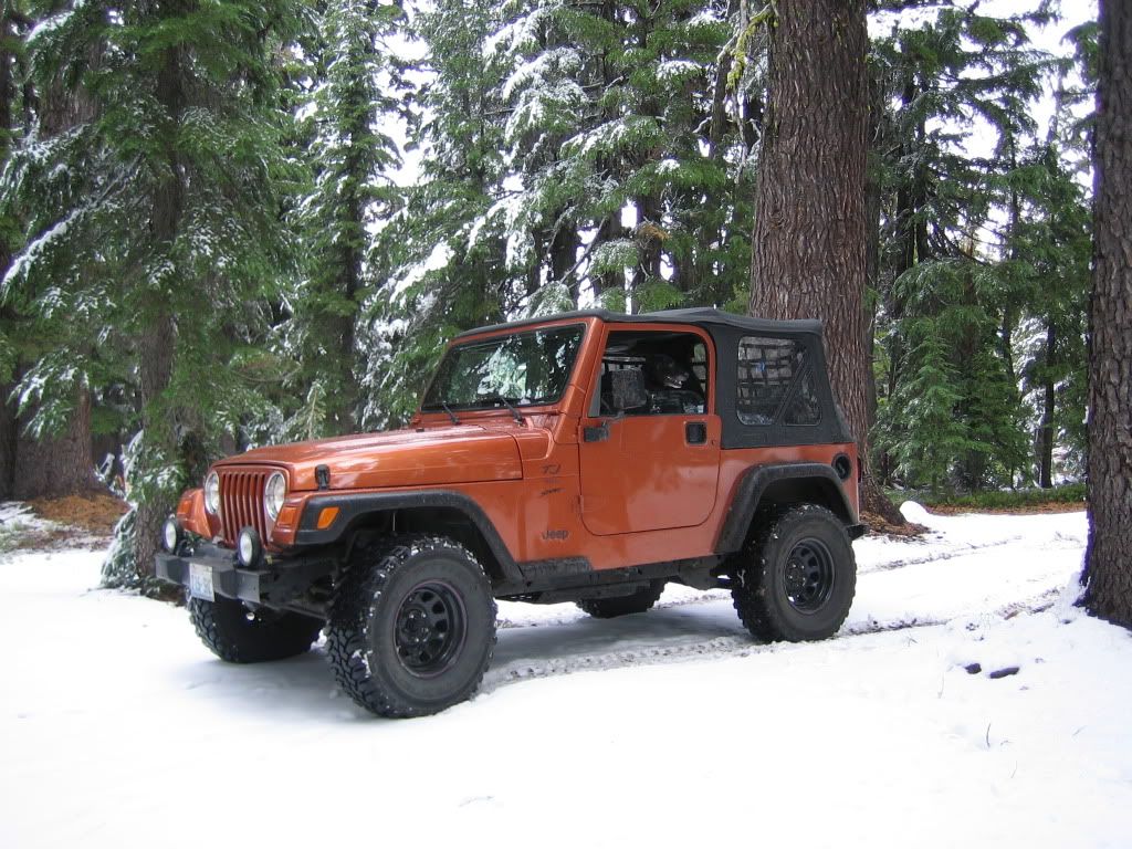

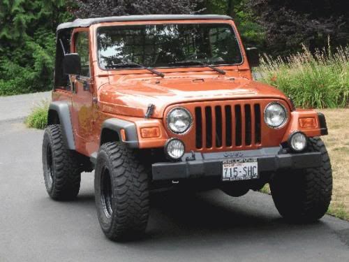

It is my Daily Driver, which I purchased in late ’06, in almost stock form. I knew nothing about Jeeps, and thought a 2” BB with 32’s would be enough. After wheeling some tough trails, I soon realized I needed to get bigger.
The picture from the internet ad which sold me on it. 2006
The day I bought it.

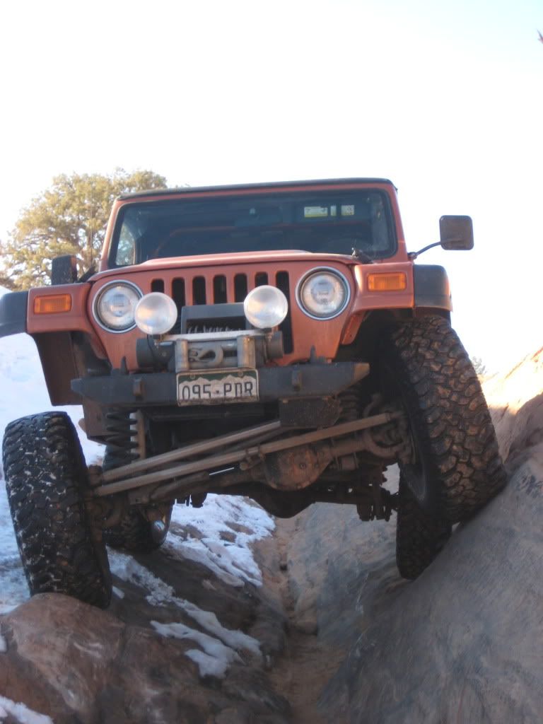

A bit of wheeling

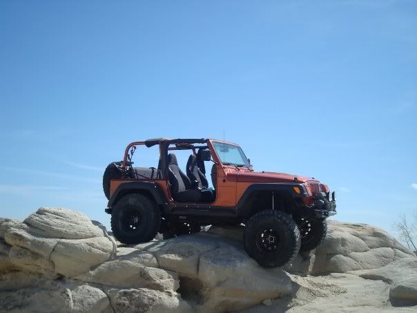

Summer ’08 - I installed a cheap lift, 35’s, gears, and a rear locker. I also put the AEV highline kit on it. Nothing special with this build, just your standard bolt on stuff.
I wheeled it like this for 2 years, added a TeraLow, High steer, and some armor etc... After many trips to Moab, a ton of research, and some trial and error, I decided it was time to do it right!

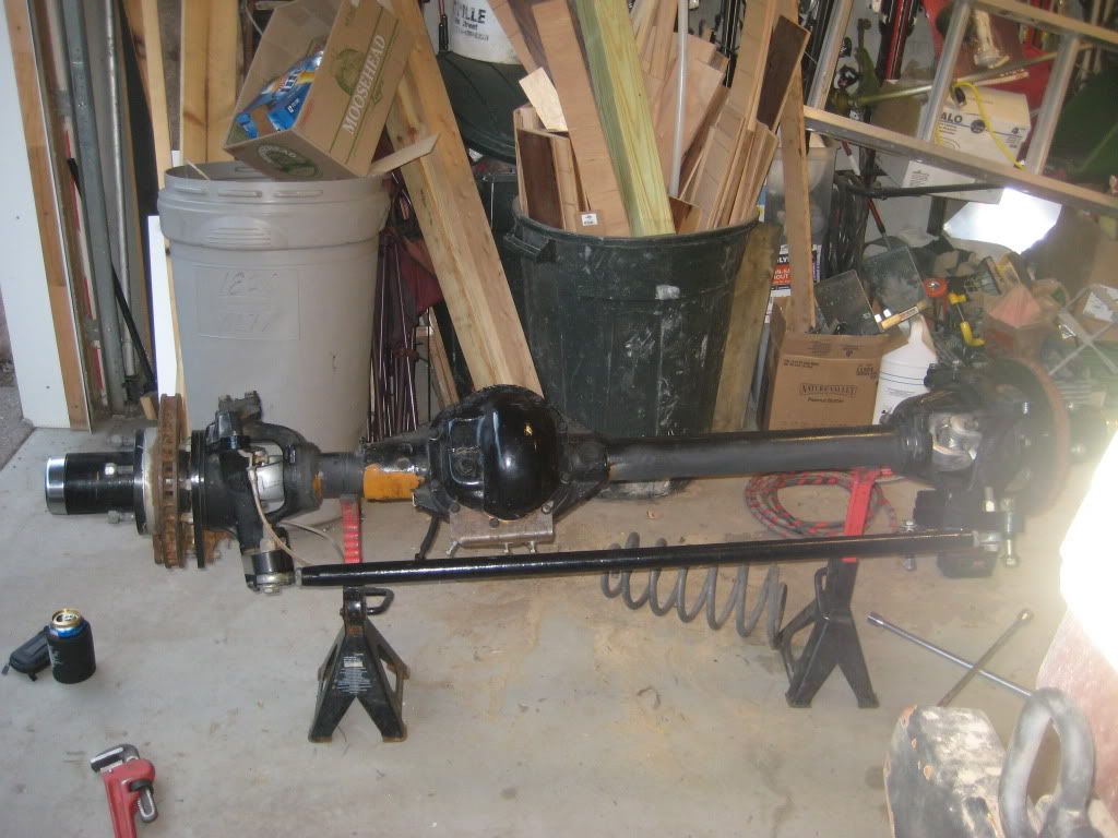

Summer ’10 - It was time for new axles, and suspension. I taught myself to weld and borrowed a friend’s garage.
I picked up a Kingpin D44/60 Hybrid for the front. 35 spline, ARB with 5:13’s and Warn Hubs.
Set it up for the TJ
Rear axle is a 35 spline, semi-float D60 with an ARB and 5:13’s

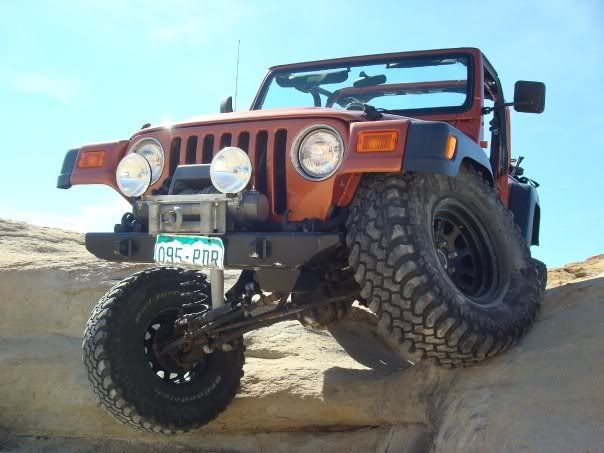

I installed a Clayton LA , and used their 5” stretch kit.
Steering was my biggest hurdle on this build. I needed a flat pitman to get the correct angles, so I went with a Waggy arm. Unfortunately the arm now hit the lower radiator hose, so I had to raise the radiator. Took a while, but I finally got it figured out.
I used the GenRight Comp gas tank, and threw some 37’s on it. Finally I had the rig I had wanted for a long time!

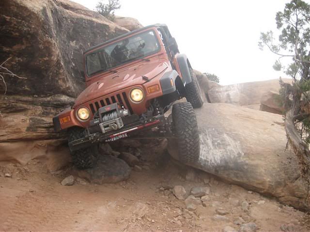

Fall ’10 - The added stress from the bigger tires tore my steering box off the frame. A bit of welding from a buddy’s on-board welder, and some help from the winch, I was able to finish the trail. Time for a steering box brace.

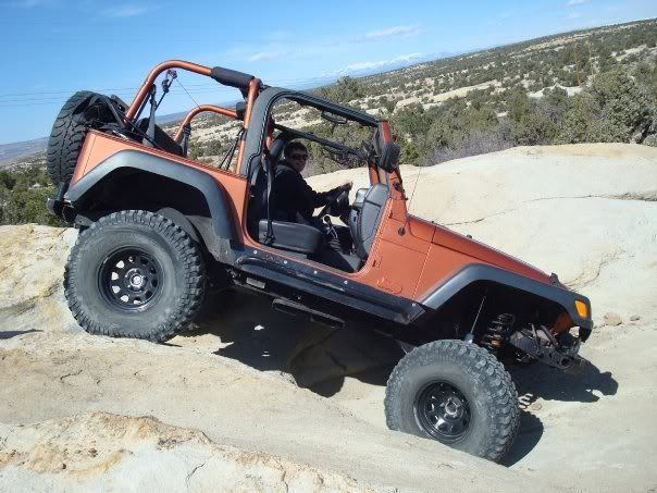

A few months of wheeling, and I decided I wanted a bit more clearance under that D60. On went the 40’s.

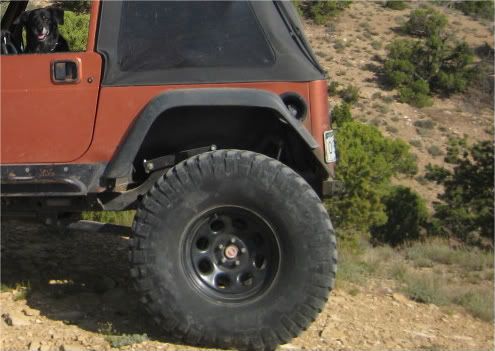

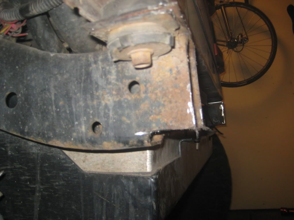

Time for a better departure in the rear. I chopped a few inches off the frame, and removed the stock cross member. I welded in a custom bumper as a new cross-member.

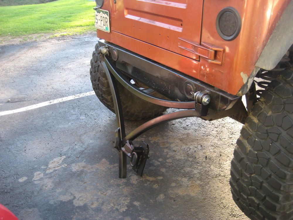

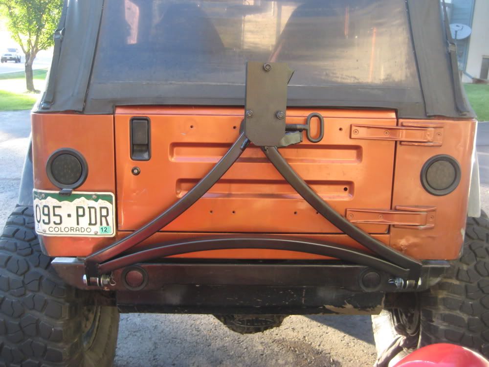

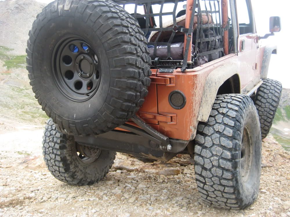

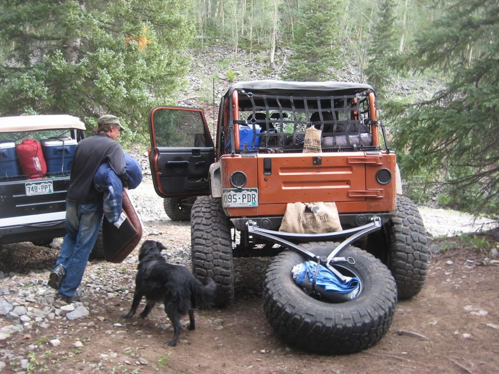

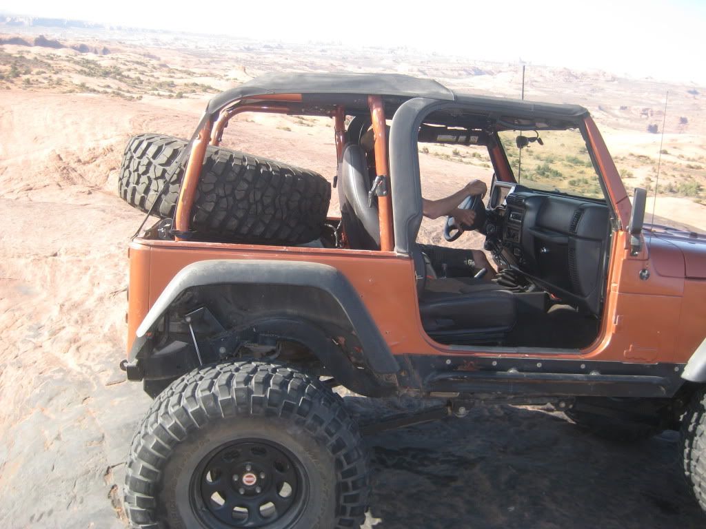

Summer ’11 - After trashing a tire, and having to let the jeep sit (no spare), I decided it was time to figure out how to carry a 40” spare in/on a TJ. I wasn’t a fan of this!
I didn’t like the idea of the traditional swing-out, for a tire that big. Plus I don’t have a bumper to mount it to. I figured the best option would be a drop down style. In keeping with the “stocker” theme, I built a low profile carrier.

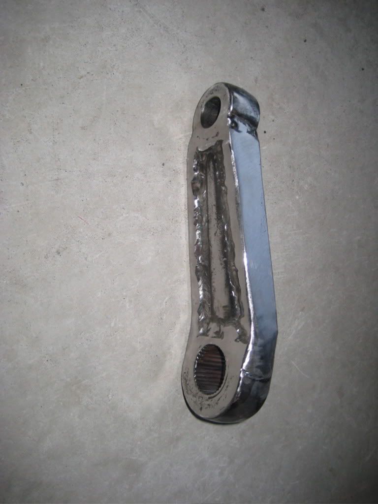

Fall ’11 – Broken pitman arm. Waggy arm didn’t cut it. I figured it would be better to reinforce it, than to buy a new one and break the new one.

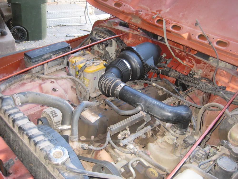

A/C and a York compressor coming in the future, so I had to ditch the stock airbox to make room. I decided to go with the Windstar box and run it into the cowl. Here's a link.

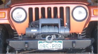

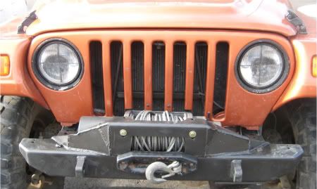

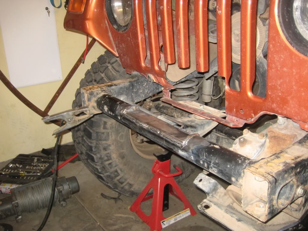

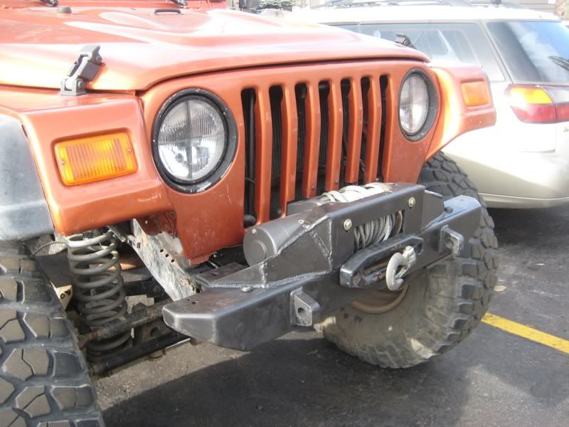

Nov ’11 - I started my project of lowering my winch between the framerails and sucking it through the grill a bit. I'm also mounting the winch vertically (horizontal plane). This will put less stress on the mounting bolts, hide the winch some, and also allow for more airflow. The final length of the bumper will be approximately 2" shorter, and the top of the winch will sit about 5" lower on the grill.

Before & after. You can see how much lower the winch is now. Plus...I have a safe place for that pesky front license plate. It might actually last more than a few years now.
Before
After
Real Jeeps are built, not "bolt-on"!

I picked both up with the internals set up already. I bought them separately, from 2 different sellers. All I had to do was Weld the brackets on and bolt them in.
The rear axle is a Dynatrac Trail Series. 67" WMS to WMS...IIRC. I'd like to upgrade to a FF at some point.
The front is a custom built axle. A 44 center section, 60 everything else. It was in a leaf sprung rig before I picked it up. 65" WMS - WMS

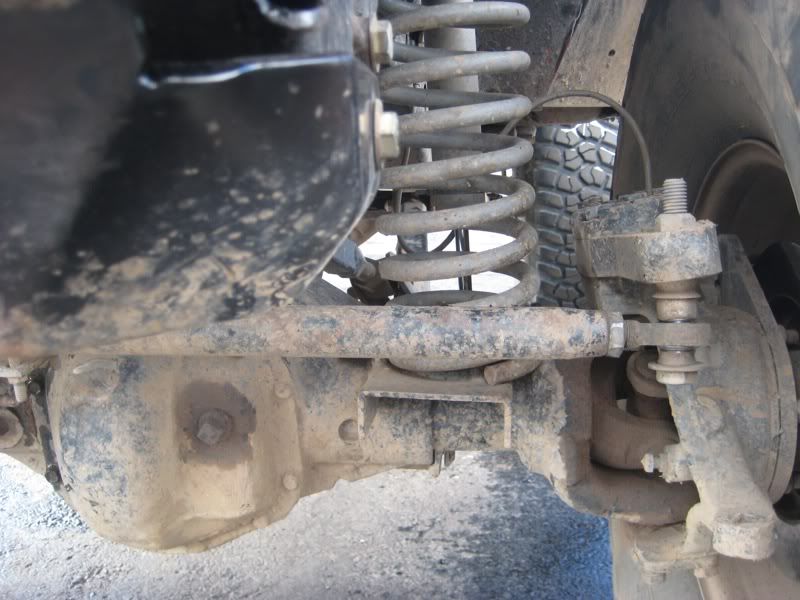

Does anybody have any clever ideas for sway bar brackets? There is no room between the steering arm and the coil at full turn. I've tried the Teraflex bracket, but it will not work.
I've been sway barless for 2 years, but I think it would do better on and off road with one.

you may need to mount them in board a little off the spring plate.
have you looked into JCR's brackets
http://www.jcroffroad.com/Merchant2/...ry_Code=XJMISC
