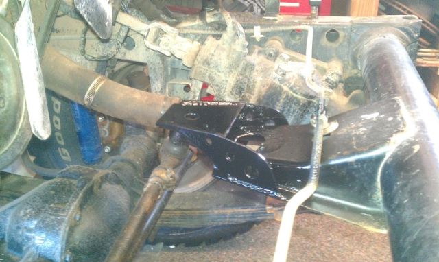

Well I started fabin the mounts for the support to the frame. I'm not too sure I'm happy with how its coming out. I kind of rushed the design and not to sure I like it. I think I will work some more on it and come with up with something. I'm always open to suggestions.

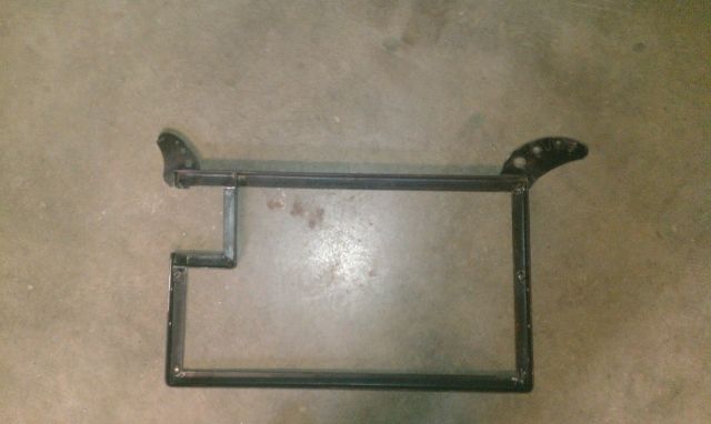

I worked on the rad support some more last night. This is what I came up with. I used some tube I had laying around and some 1/8". I sure wish I had a plasma table it would have came out nicer.

Made some more progress on it this morning. I'm home with my sick son. While he is taking a nap I plugged in the baby monitor and went to work. Rad mount is tacked in now just working on mounting the grill. I had to notch and weld some more on the support since its right in the way of the headlights bucket. One step forward two steps back. lol
It's a lot of work to make this work but worth it in my opinion. Besides I like to fab. It probably would of been easier to find another CJ7 grill but I love the nostalgia of the m38. No difference in shape but the turn signal lights are smaller and I like that I have something from most every era on my jeep from M38a1,CJ,YJ,TJ,FJ,and ZJ and various Fords and Chevy's. I plan to source parts from a jk next. lol

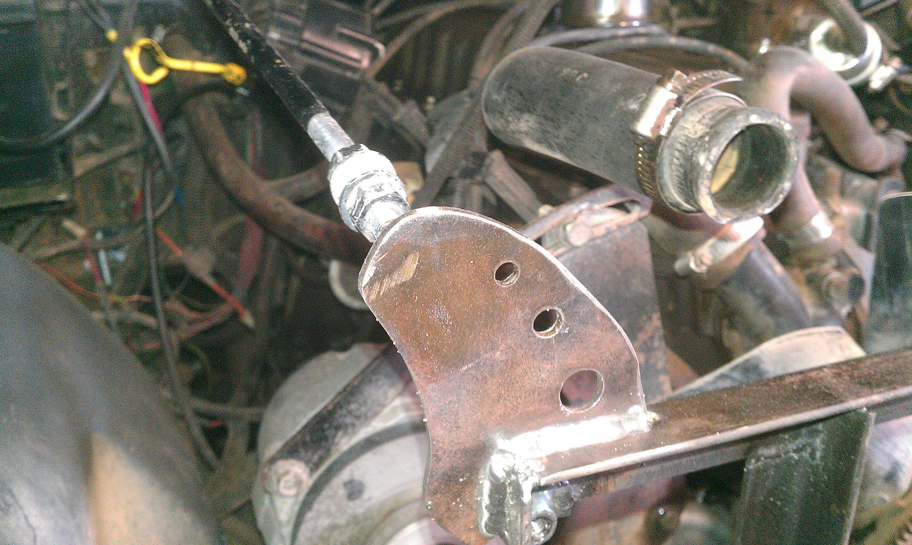

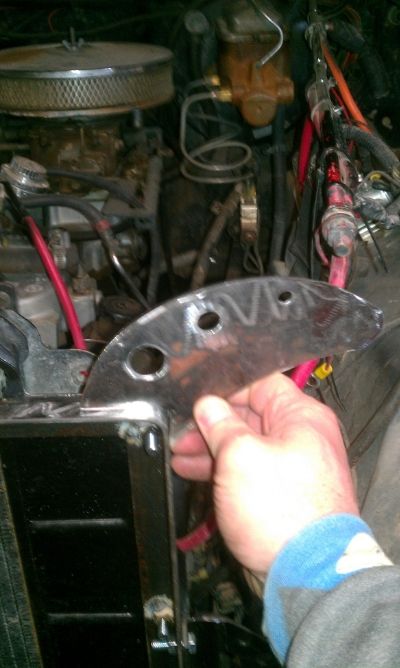

I cut out all these brackets with my trusty 4.5" angle grinder and cutting wheel. I used a scrap sheet of 1/8" I have had laying around from other projects. I made these upper mount strut supports for the top of the radiator mount, and drilled some holes for a little affect.
Pulled it again to weld it all up. I had to make that notch in it for the headlight bucket to fit.
Then primed and painted it.

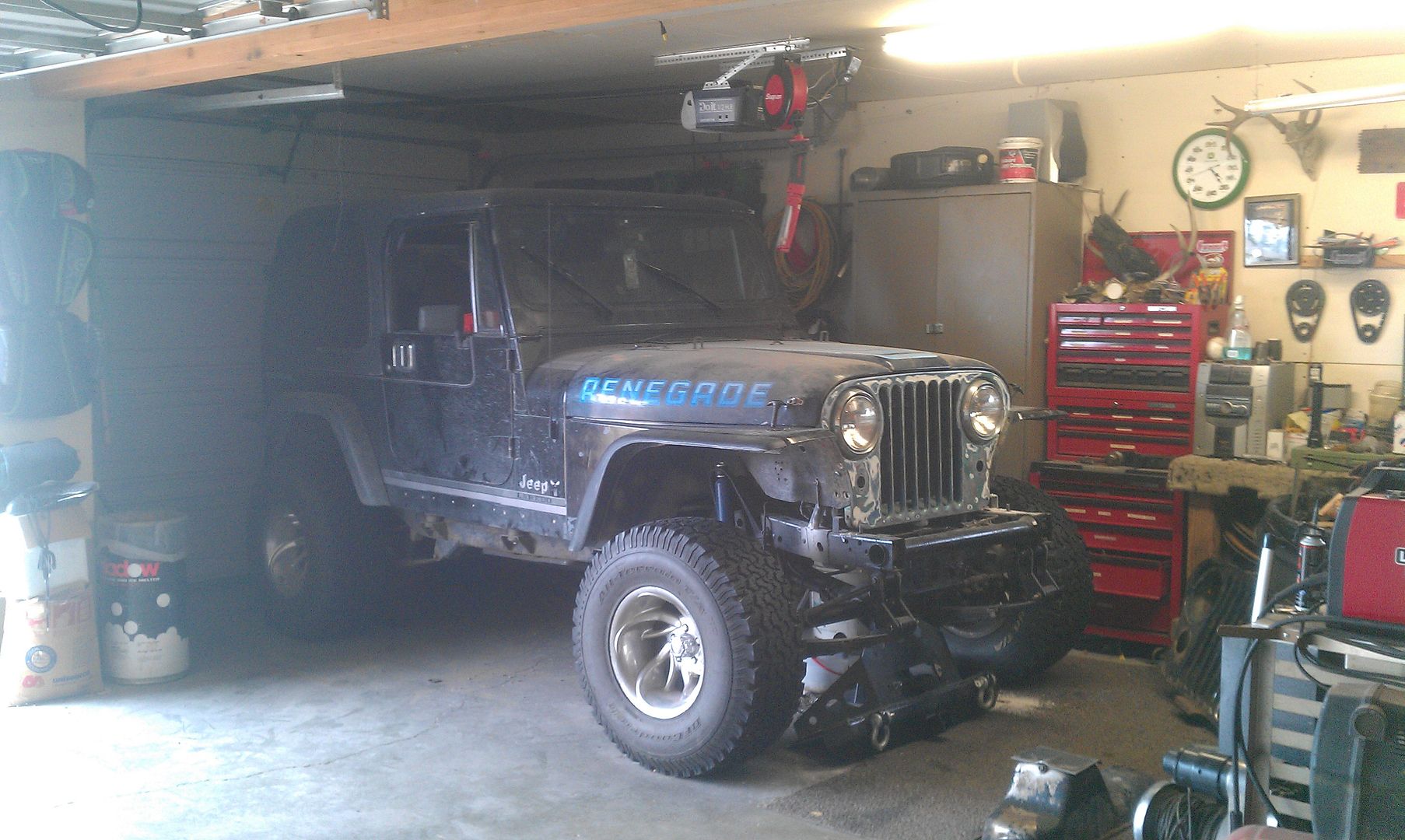

Stayed up late last night to assemble the front clip to see how everything lines up.
I am so excited to get this thing running
All sitting level
Now to just pull the grill prime and paint it. I have a little body work to do on the hood before I paint it. I really like the nostalgia of the hood with the renegade on the side and the blue pin stripping on the top. I wish I could keep it with the cracked sticker and everything, but it needs paint. Probably wait until summer before I pull the hood and paint it.
