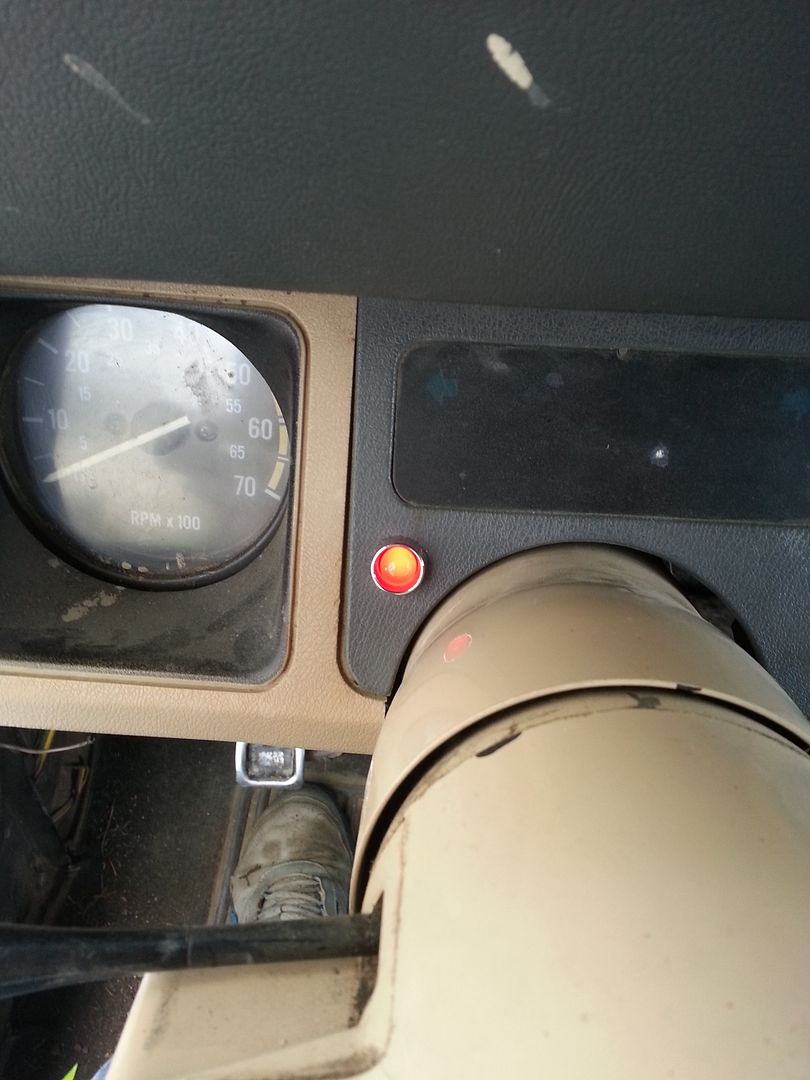

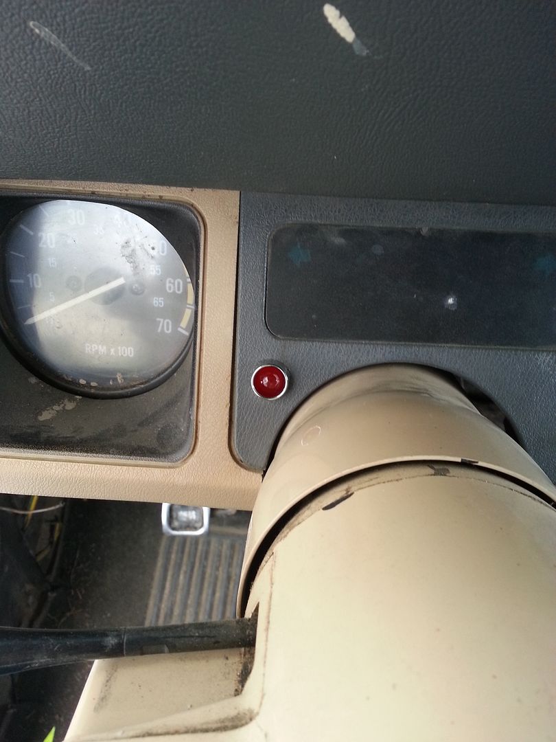

Finally installed a MIL
You weren't able to reuse your factory check light? I wired my PCM output straight to the jeep CIL/MIL and it seems to work perfectly.

Posts: 4,330
Cheers
Yea the po had hacked everything up under the dash and it was juet easier to run a new wire. One of these days I will tear the dash apart and try to figure out what the po was doing. At least I know my stuff is done correctly.

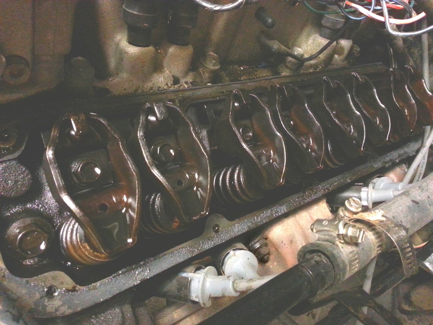

Valve covers decided to puke oil so I'm re-doing them again if I can't get these damn old school covers to seal up on these magnum heads I will go back to the stock ones but I figured I'd give them one more shot with some rubber gaskets and right stuff.

Posts: 4,330
Well got th valve cover leak fixed but now it is throwing a code 47 alternator voltage low. If its not one thing its another lol! Damn check book needs to recover for a few weeks before another parts goes kaput. And we made an offer on our dream home and they accepted it so now we are packing and saving for the unexpected expenses.
