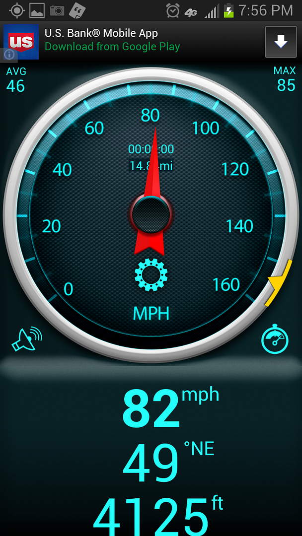

Smooth as glass at 82 mph. With the 4.2 top speed was 74 downhill with a tailwind in 4th gear lol.
I have logged 202 miles on it since the iac replacement and not a single hiccup and I'm getting 18 miles to the gallon. Not too shabby!!
