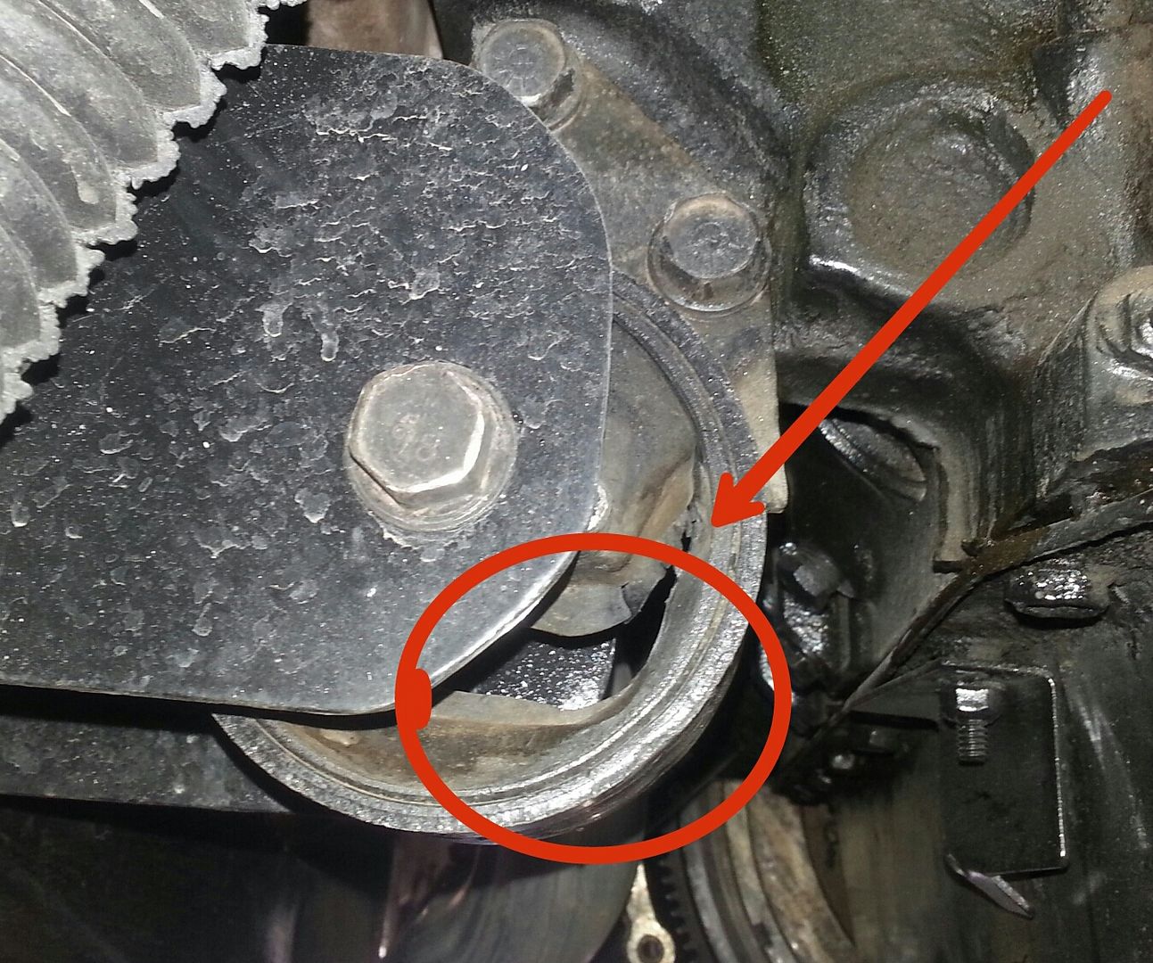

Where are your motor mounts breaking? I can't see it in your picture. I'm curious about this as I'll have to do it myself someday.
I've been trying to upload more pics tonight but photobucket hates me so I can't show you a closer pic but the rubber has separated from the cicular mount holding it all in place so now its just resting on the mount.

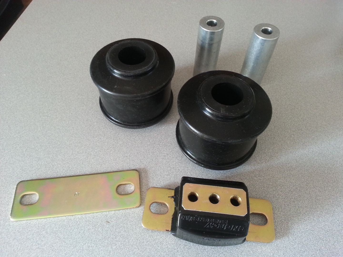

just placed an order for some prothane motor mounts and trans mount should be here friday.

And are here is a better pic for you Sooner of my torn rubber mounts.

Wow. That motor mount is hosed. But that causes lots of play.

Yes the old mounts were the parts store stock replacement el cheapo's. The new poly ones are an insert that will be pressed into the old mounts. I have a feeling I wont need to replace them.
There are a few different mounts for this swap I chose this way (homemade frame mounts) using the stock mounts since I didnt like the price of the Novak mounts. Moparfreak he uses the old style LA mounts because they have a built in limit hook, anyone of them should work. I prefer home brew stuff like mine and moparfreak a lot more satisfaction when it works, it may take some trial and error but its worth it in the end to me.
