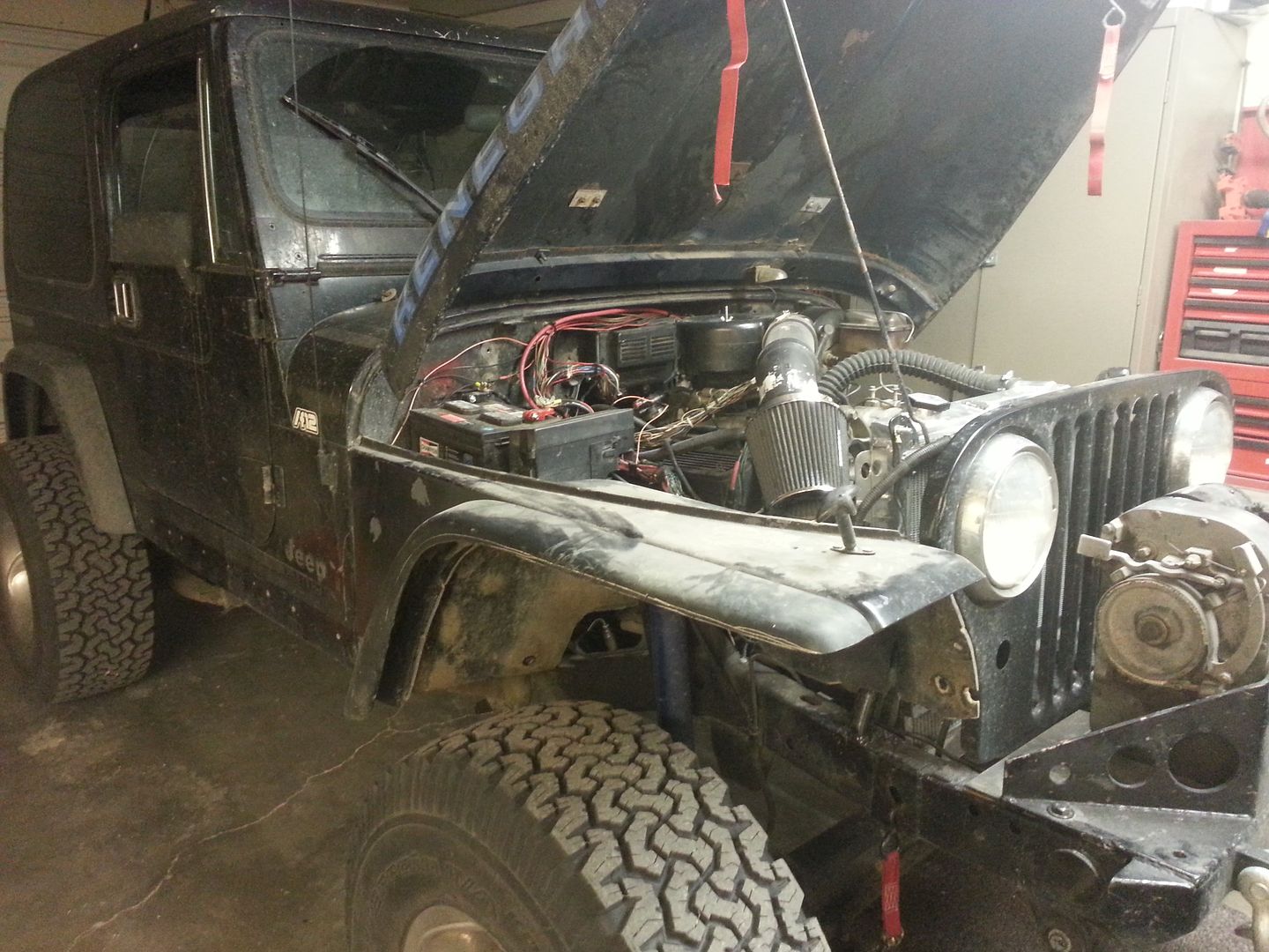

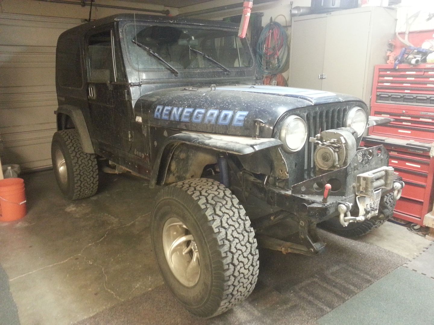

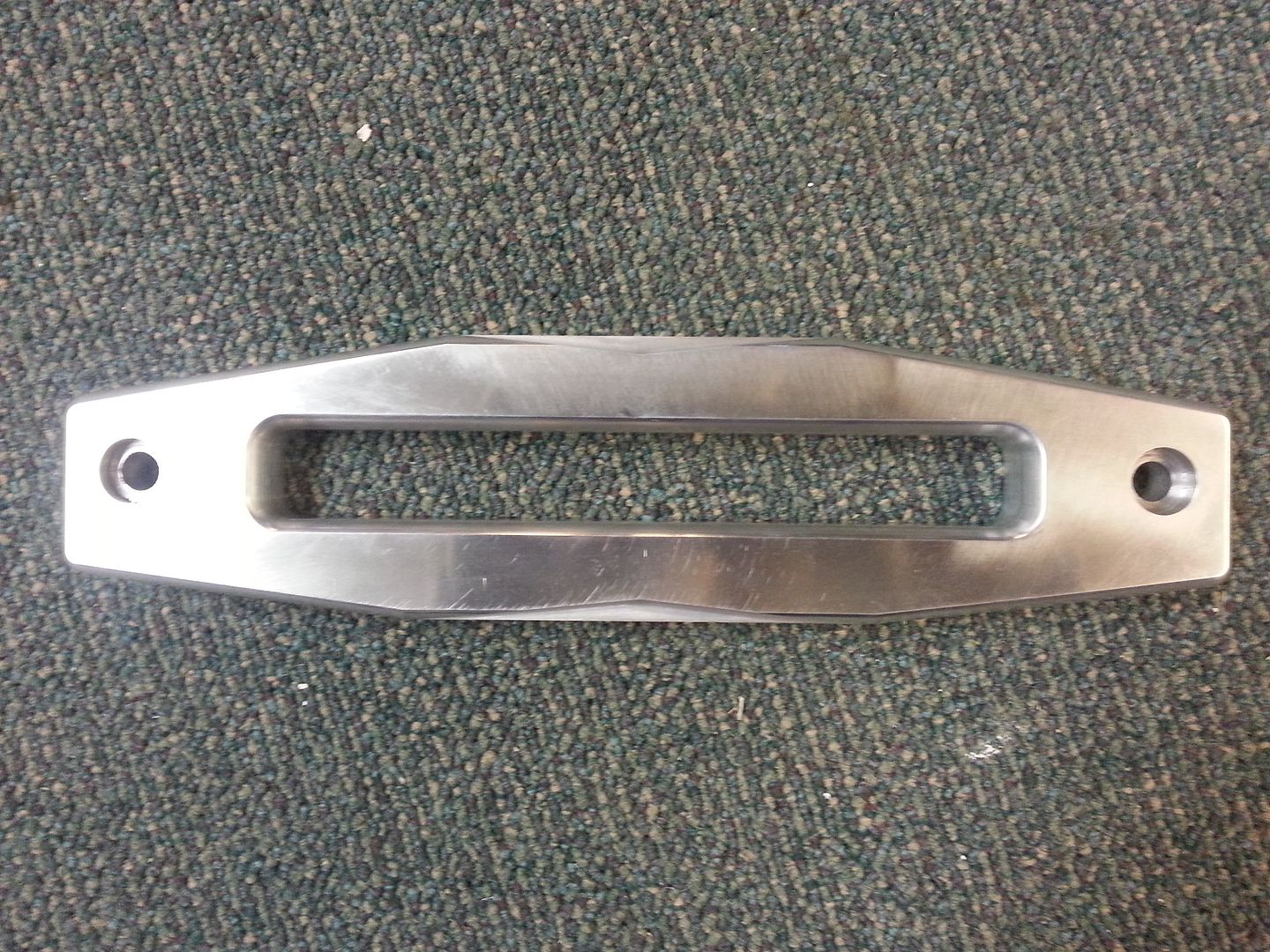

Got the fenders back on.
Also got my fairlead.

Looks complete again!! So stoked for you! Also, I like the screwdriver holder!
Yep sleeper mode now.
thats what happens when you have a 2 yr old help you. I'll find screw drivers shoved in every hole on the jeep. I have to do a safety walk around the jeep before I drive it after he's been in the garage. Lol

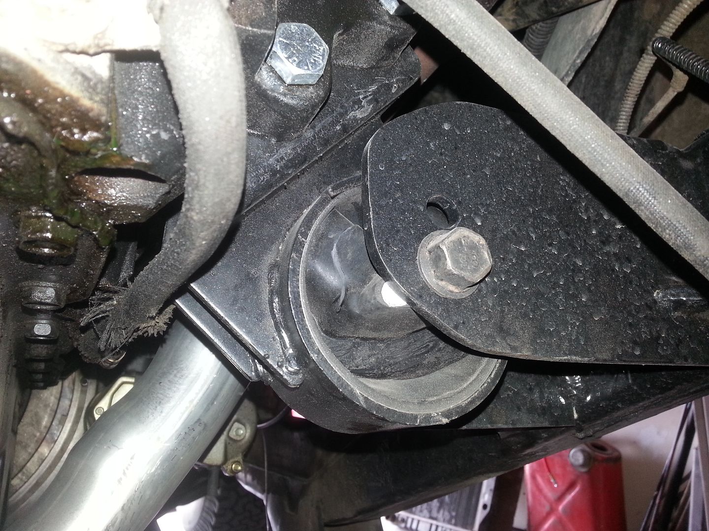

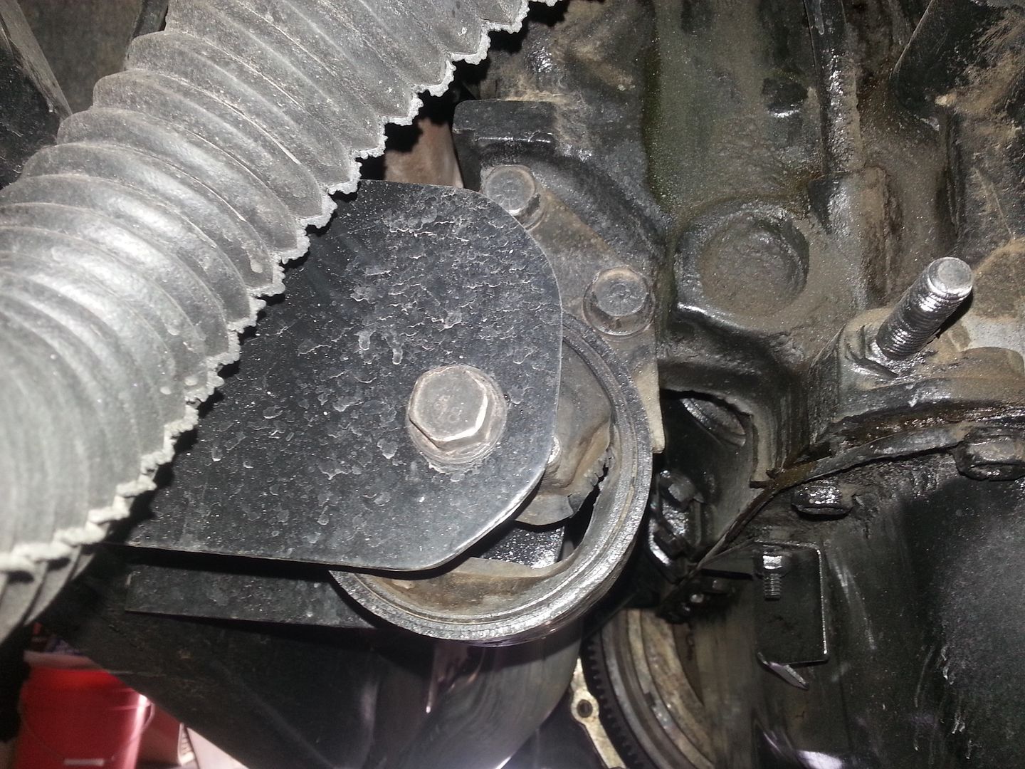

Crawled underneath the jeep to inspect some things and noticed that the passenger side motor mount had ripped itself apart.
Drivers side is on its way too.
So I did some checking and they make these prothane inserts to go inside the mount, pretty slick which should solve my problem http://m.summitracing.com/parts/ptp-1-504
Just not sure if I should replace my transmission mount to a prothane too? Any suggestions?

lasted less than a month eh? Must have leadfoot! :P

You could say that I think I got a few leaky Injectors also it was running really rich last time i drove it and flooded at cold starts but once its was in closed loop and warm it seems to run fine. My gas mileage has gone down and I can smell raw fuel coming out of the tailpipe. Just a few more bugs to work out.

Anyway, I think you'll be happy with those poly mounts. From what I've ready you should probably keep it all poly after that. I don't have experience running mixed materials, but the general wisdom seems to be to keep it all the same.
Can't believe you blew those out in a month haha.

Where are your motor mounts breaking? I can't see it in your picture. I'm curious about this as I'll have to do it myself someday.
