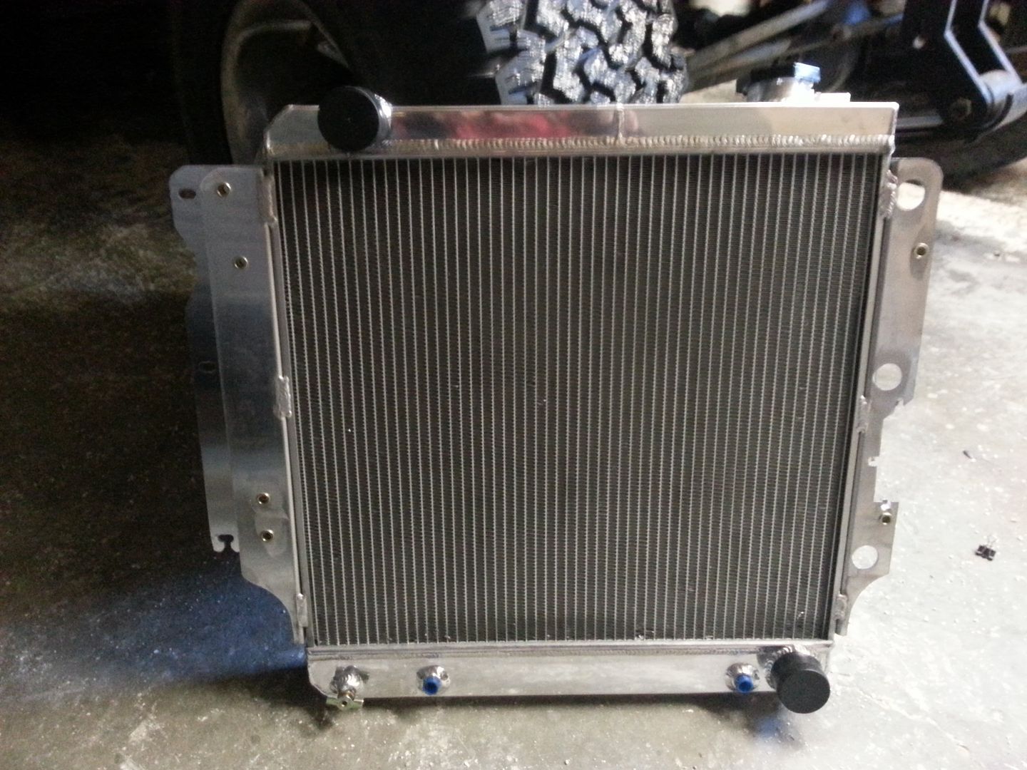

post #632 of 1796 Old 02-13-2014, 01:41 PM Thread Starter
skyj
Location: Helena
Posts: 4,328
Guess what came today??it looks good hope it cools good. Its hard to get excited when I still can't figure out the stalling issue.

post #633 of 1796 Old 02-13-2014, 04:07 PM
Maine1994ZJ
Join Date: Feb 2013
Location: Phippsburg, Maine
Posts: 845
That's purdy!!! It ought to help out some anyway.
Good luck with the stalling issue too!

post #634 of 1796 Old 02-15-2014, 06:32 PM
Hoxie
Hoxie's Avatar
1987 YJ Wrangler
Location: Boise
Posts: 1,313
Looking good man, love how new and shinny it is. Where did ya order it from? I need to pick one up also.

post #635 of 1796 Old 02-15-2014, 08:35 PM
daddyjeep87
1987 YJ Wrangler
Join Date: Feb 2013
Location: Smethport
Posts: 463
Looks just like mine I got from leadfoot racing. I think it is a Champion radiator.

post #636 of 1796 Old 02-18-2014, 09:31 AM Thread Starter
skyj
Location: Helena
Posts: 4,328
I ordered it off of Amazon.com its a champion radiator shipped to my door for $203 which was cheaper than the ebay one.
yep
Sorry for the no progress report this weekend I was out of town on vacation with my wife and kids in Island park ID playing in the snow. We had no cell/internet service all weekend it was GREAT!!Progress should pick back up on the ol' girl again this week I plan to get my radiator in and then figure out my stall issue which I think I may have figured out. Im going to run a new fuel line from my tank all the way to the motor I think Im air locking my pump and its sucking air bubbles and locking it up. its a theory but its cheap insurance after talking to my brother-inlaw who deals with fluid transfer pumps in his job he says its acting like that is what is happening.

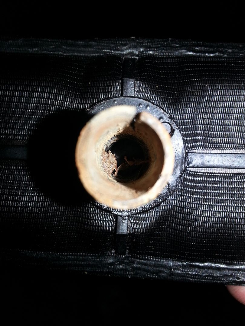

post #641 of 1796 Old 02-20-2014, 06:25 PM Thread Starter
skyj
Location: Helena
Posts: 4,328
I got bored.....
I pulled the tank only to find that the filter sock was full of crud and was cracked where connects to the pickup tube. The stuff inside the filter sock looked like varnished fuel and was partially blocking the pickup tube. I really hope this was my problem all along and that all I need to do is replace the filter sock. I will be picking one up tomorrow and and hopefully get it installed after work tomorrow.

post #642 of 1796 Old 02-20-2014, 06:28 PM
Randonexplosion
Deplorable
Randonexplosion's Avatar
Location: Cortez
Posts: 7,620
Bingo! Hope that cures it.

post #643 of 1796 Old 02-20-2014, 06:32 PM
Maine1994ZJ
Join Date: Feb 2013
Posts: 845
Good find.
Hope that's your cure!

post #644 of 1796 Old 02-20-2014, 06:35 PM Thread Starter
skyj
Location: Helena
Posts: 4,328
Originally Posted by Maine1994ZJ View Post
Good find.
You guys have no idea!! How bad I want to drive this thing without it stalling on me in traffic lol
