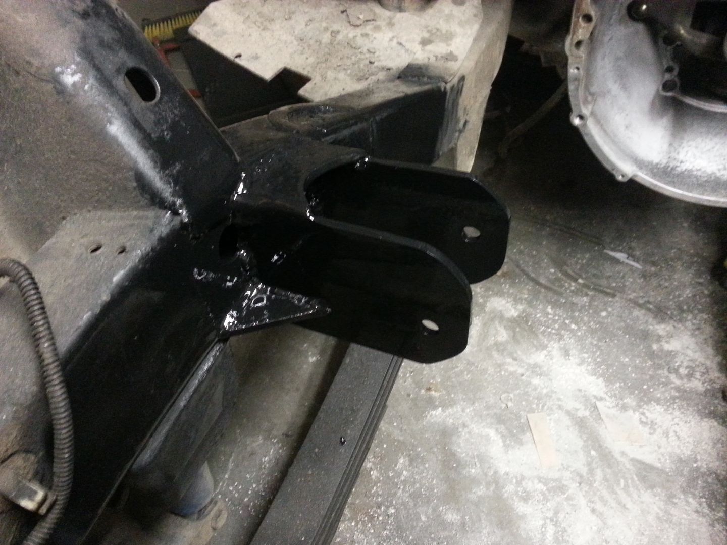

Thanks man hopefully my thread will be of some use for you? I snuck out there today to make some frame tie-ins and extra bracing. I Should have it fully welded up tomorrow night and hopefully painted then club meeting on weds, so I should have her in by Thursday night. Im a little nervous about my front driveshaft to starter clearance.I only have 4" before my driveshaft crashes into my bellhousing/starter. I shifted the motor over to the pass side as far as I could without major surgery of the trans mount, I sure hope it was enough.

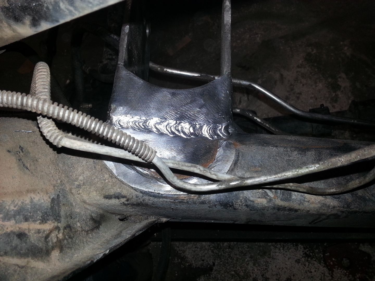

post #470 of 1760 Old 01-05-2014, 09:43 PM Thread Starter
skyj
Location: Helena
Posts: 4,279
Passenger side all welded up and ready to be cleaned up and painted. Dont laugh at my welds too much I'm using flux core wire and a ****ty welding helmet cause cant get my good auto darkening one to work ( I think batteries are shot)

post #471 of 1760 Old 01-06-2014, 03:56 PM
soonermatt
Location: Norman, OK
Posts: 1,407
I won't poke fun. I bet it passes the sledge hammer test!

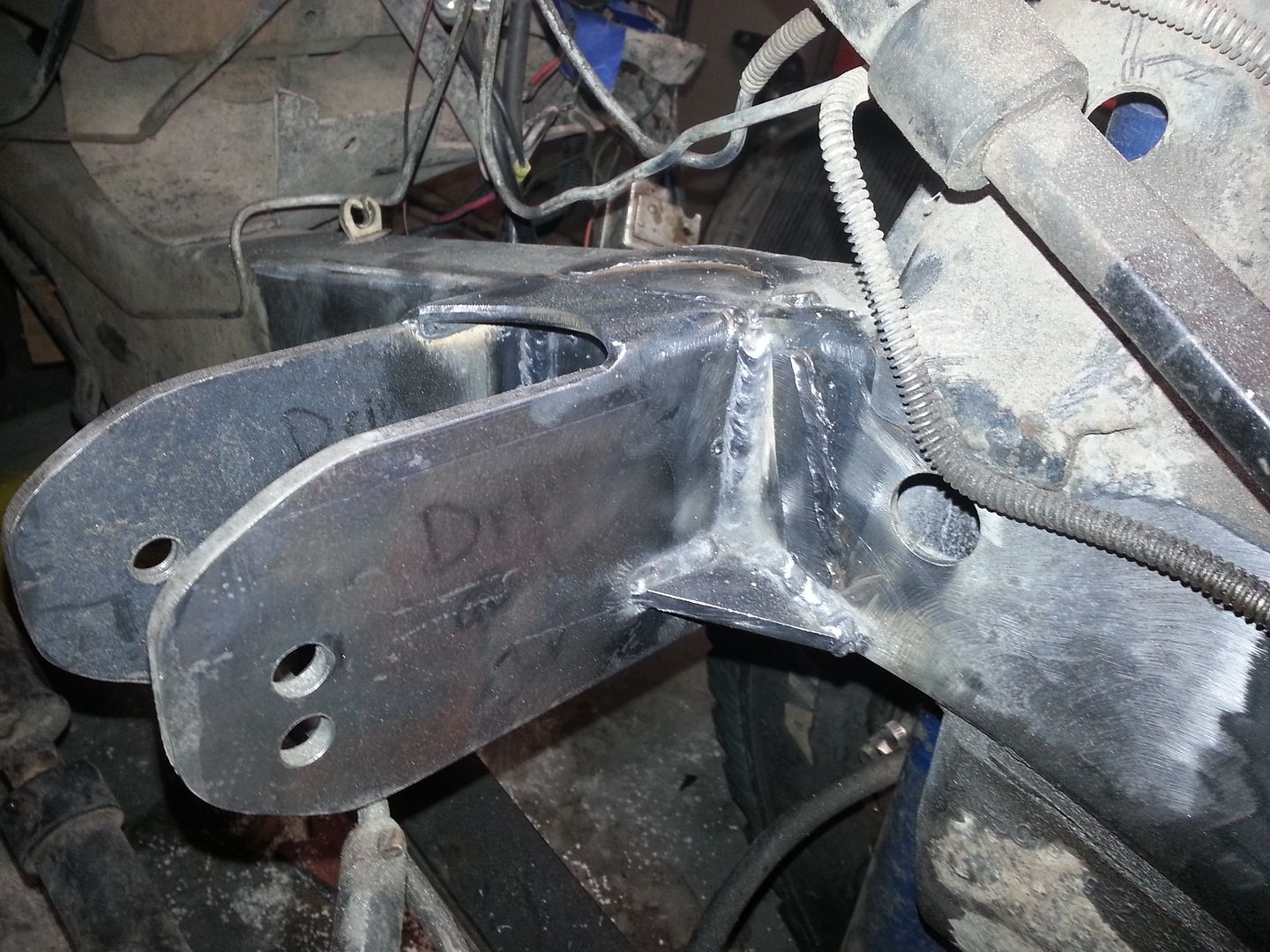

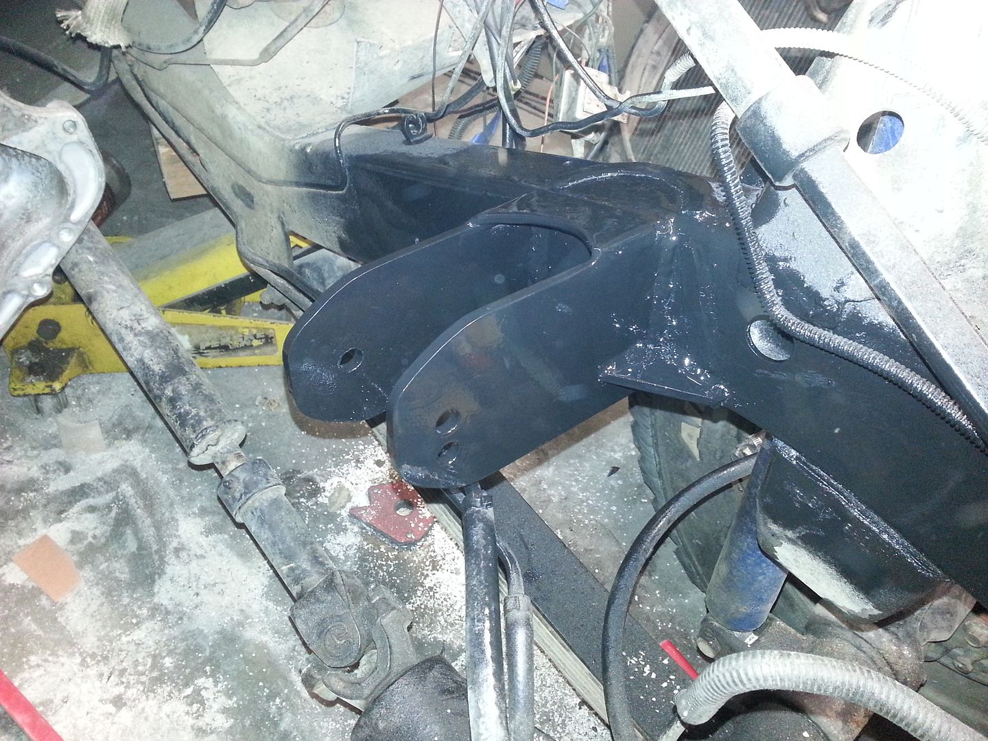

post #472 of 1760 Old 01-06-2014, 07:37 PM Thread Starter
skyj
Location: Helena
Posts: 4,279
Lol thanks Pal. Welp got one complete and painted.

post #473 of 1760 Old 01-06-2014, 10:48 PM Thread Starter
skyj
Location: Helena
Posts: 4,279
Got back from the depot and resumed glueing metal together. Got it all complete
Boy was that a bugger to get in and weld with all the brake lines.
I sure hope I got my measurments right lol
driverside done.
This baby gets put in tomorrow.

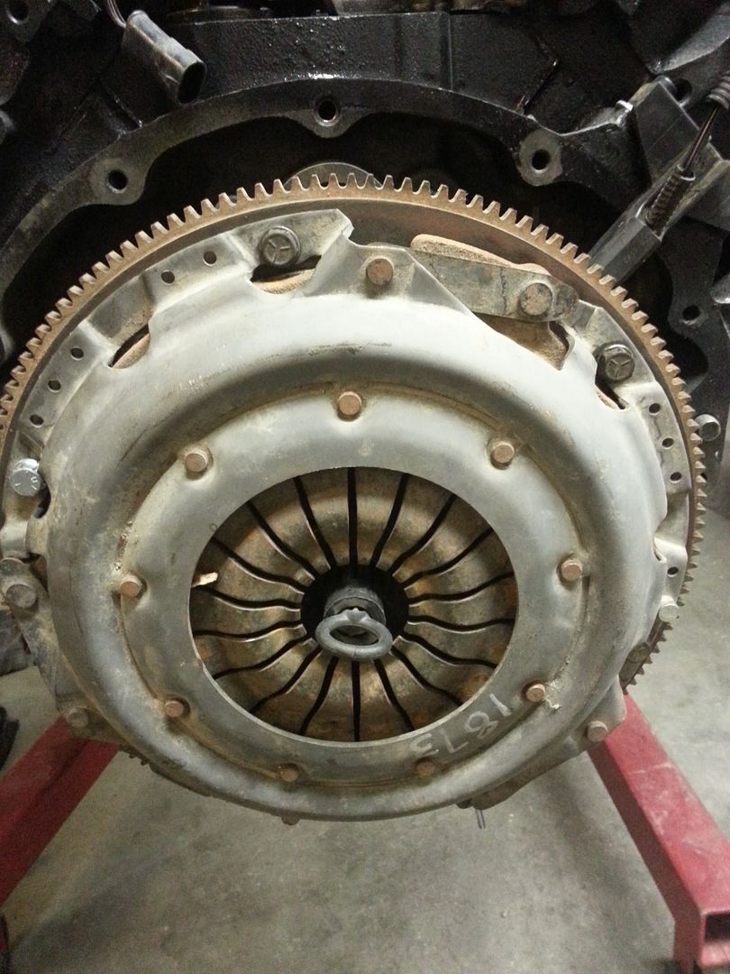

post #479 of 1760 Old 01-09-2014, 06:46 PM Thread Starter
skyj
Location: Helena
Posts: 4,279
Messed around with the cps today I used a piece of cereal box cardboard as a spacer between the sensor and tone ring
then three washers as spacers on the block.

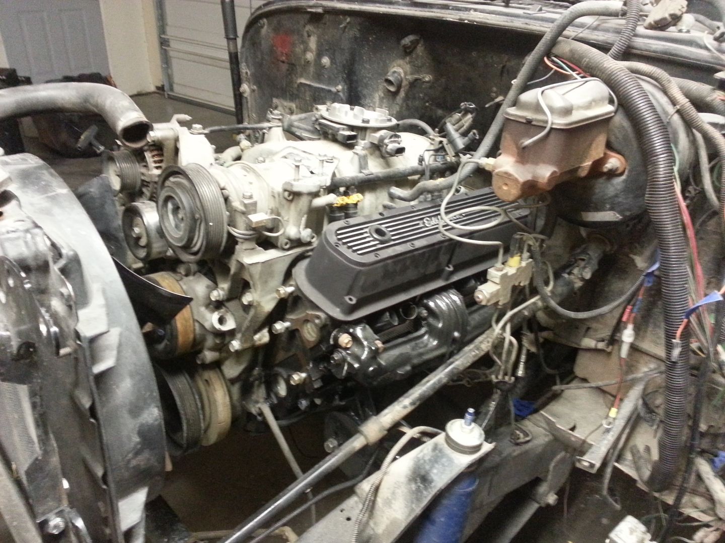

post #480 of 1760 Old 01-09-2014, 09:31 PM Thread Starter
skyj
Location: Helena
Posts: 4,279
Its In!!!!!!!!!!!!
Now the hard work starts.
