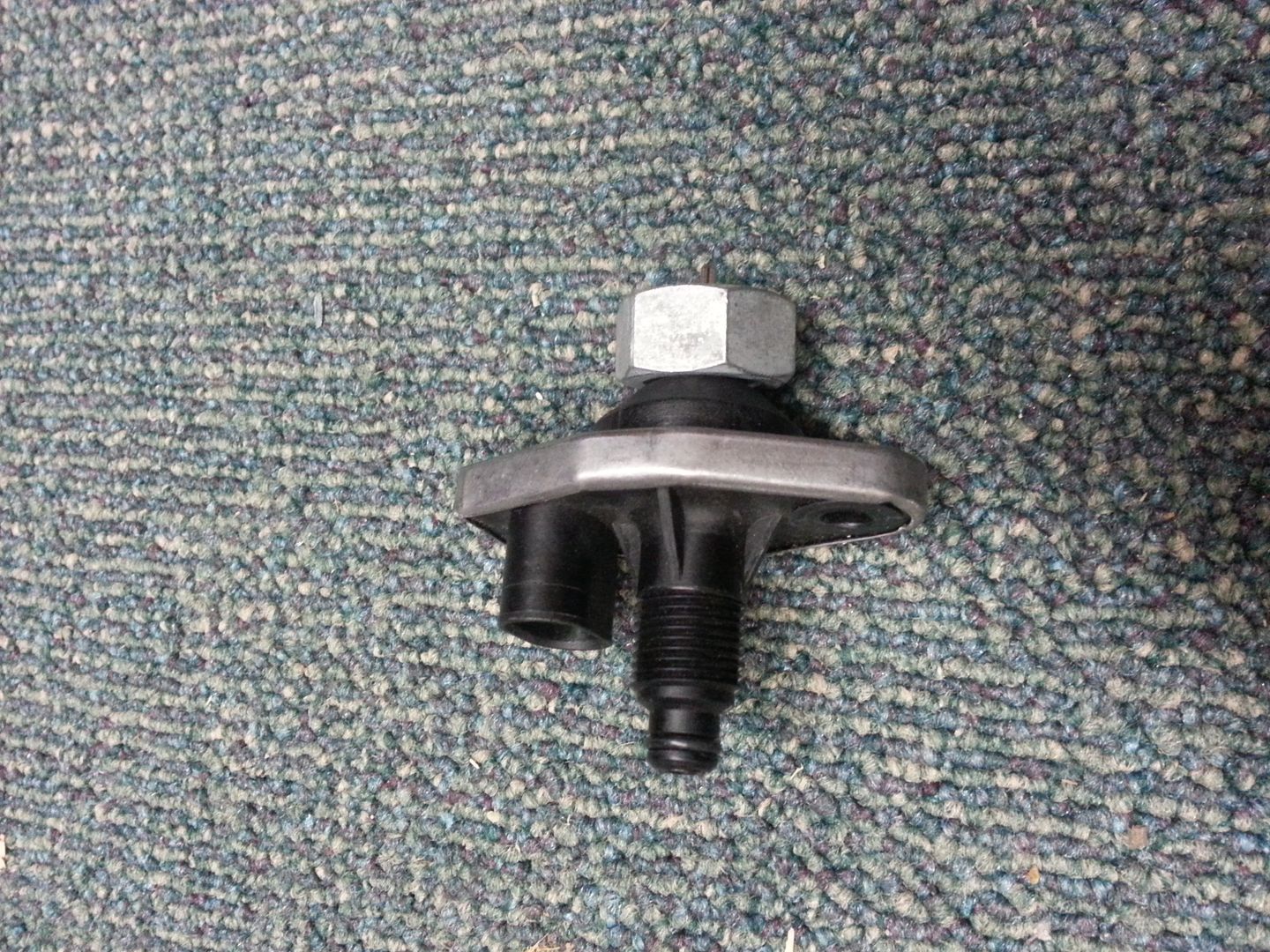

Its going to be like the twelve days of Christmas for me this week new parts everyday. Found this little gem in my mailbox.
VSS

Originally Posted by SH00T3R View Post
Where did ya order that from and how much? ^^
Ebay $25.99 shipped to my door "sc108" ebay seller sparks auto parts
I just checked and looks like I got the last one at that price.
You might want to check first to see if it will work with your setup.I just did a Google search for a 92 Wrangler vehicle speed sensor and it said it was compatible.

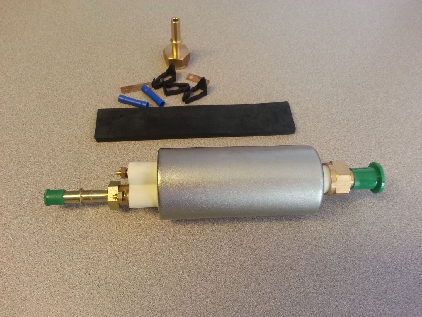

Fuel pump showed up today.
Just waiting on the starter and o2 sensor now. I think I will celebrate by prepping the motor for install..... headed out to the garage I shall return with pics.

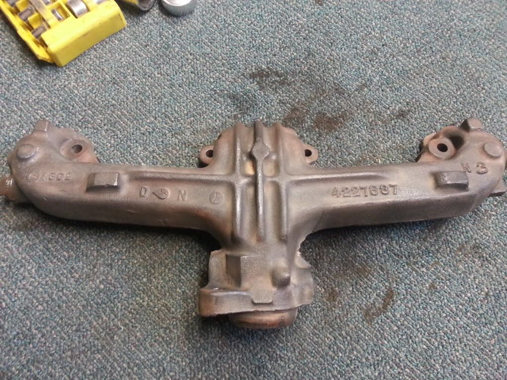

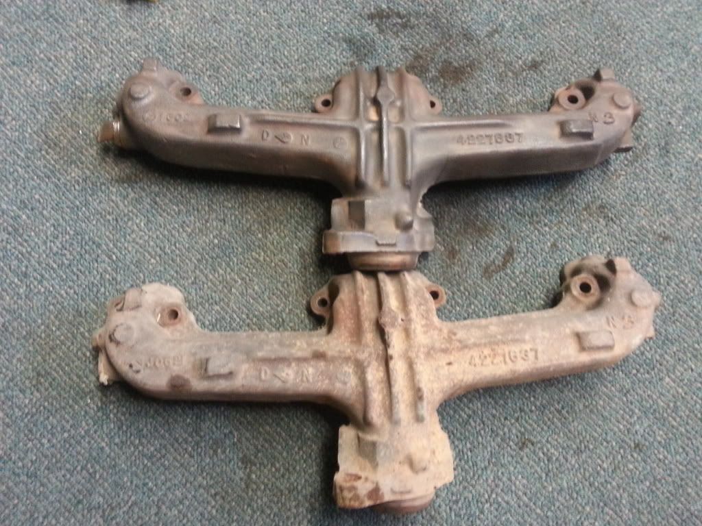

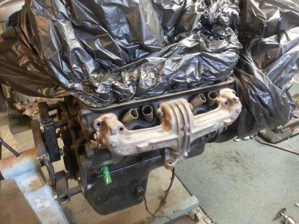

So I spent a few hours out in the garage and was able to accomplish something. I started by taking this 80's emmissions crap off of the passenger truck manifold. Sawzall made quick work of it.
BEFORE:
AFTER:
A few minutes with a wire wheel on the drill
Bolted up and prepped for paint.
All painted up.
Replacing hoses as I go.
Bolting accessories back on
Im contemplating painting the valve covers. Any suggestions?? Im thinking gunmetal gray??

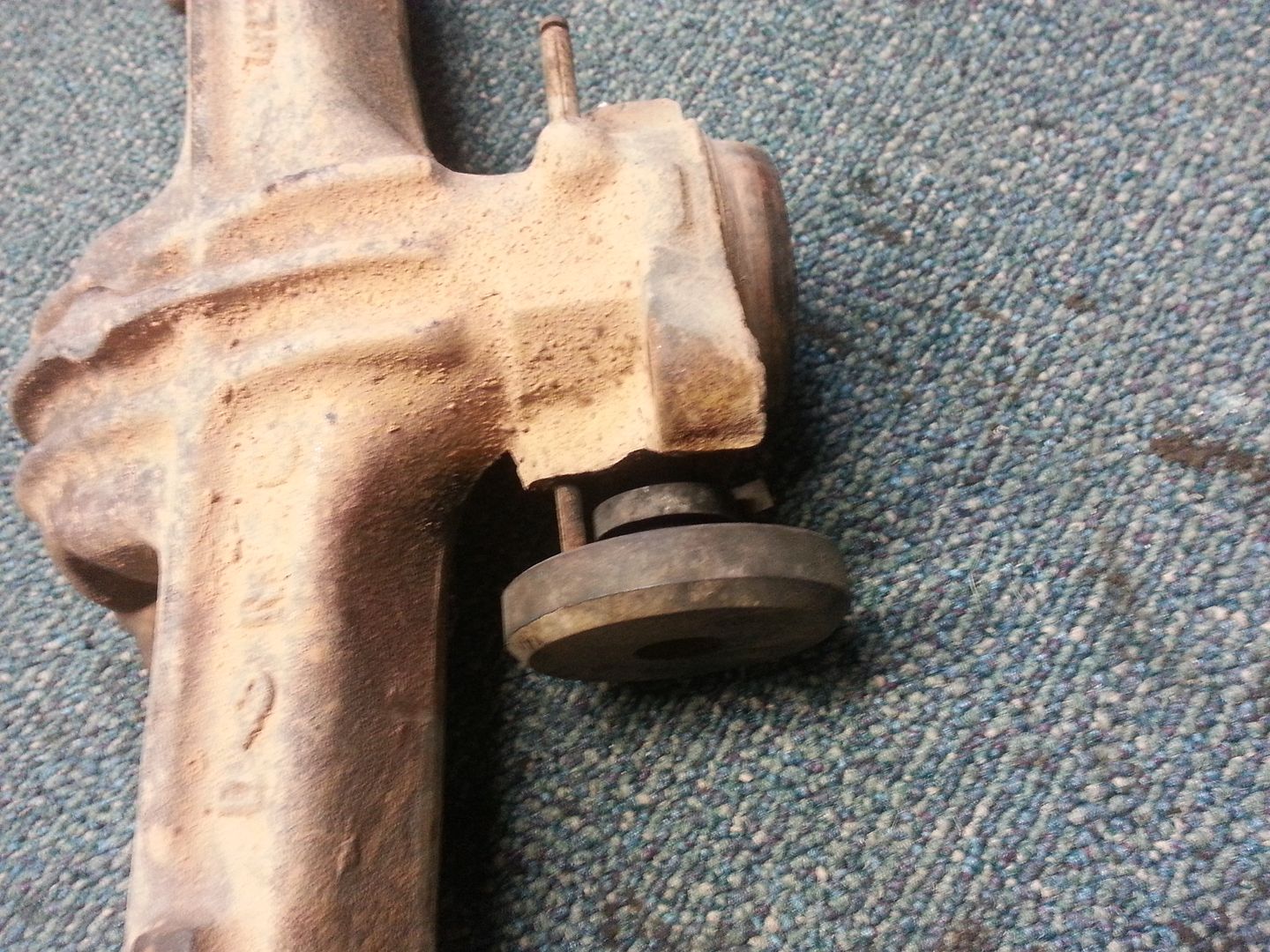

post #433 of 1760 Old 12-22-2013, 09:36 AM Thread Starter
skyj
Location: Helena
Posts: 4,279
I finally messed with the vacuum advance on the 4.2 and was able to limit it from advancing it so creating the knock/ping it no longer does it. Still got a slight lifter tick but what 4.2 doesn't. I made a little plate to go over the rod and limit how far it advances the timing. It took a little trial and error at first I limited it too much and it just was gutless then I went to far next. The third time was a charm it has power and no knock I'm as happy as a fat kid in a candy store right now. Hope that guy will keep his word and pay my full asking price since I fixed the knock wished I would have figured this out months ago. I will snap a pic in a few my limit plate is ghetto but works I may throw in a adjustable vacuum advance to sweeten the deal I will just have to order it from summit. off to get a pic of said plate.....

post #434 of 1760 Old 12-22-2013, 09:44 AM Thread Starter
skyj
Location: Helena
Posts: 4,279
Its a piece of aluminum schluter metal from a tile job I did a few weeks ago. Its ugly but does the job.
